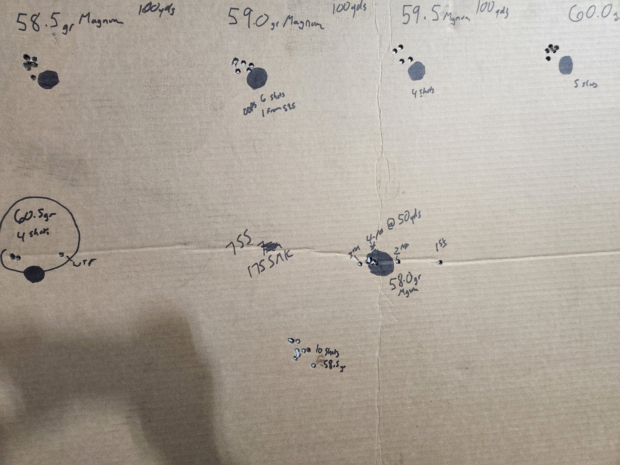

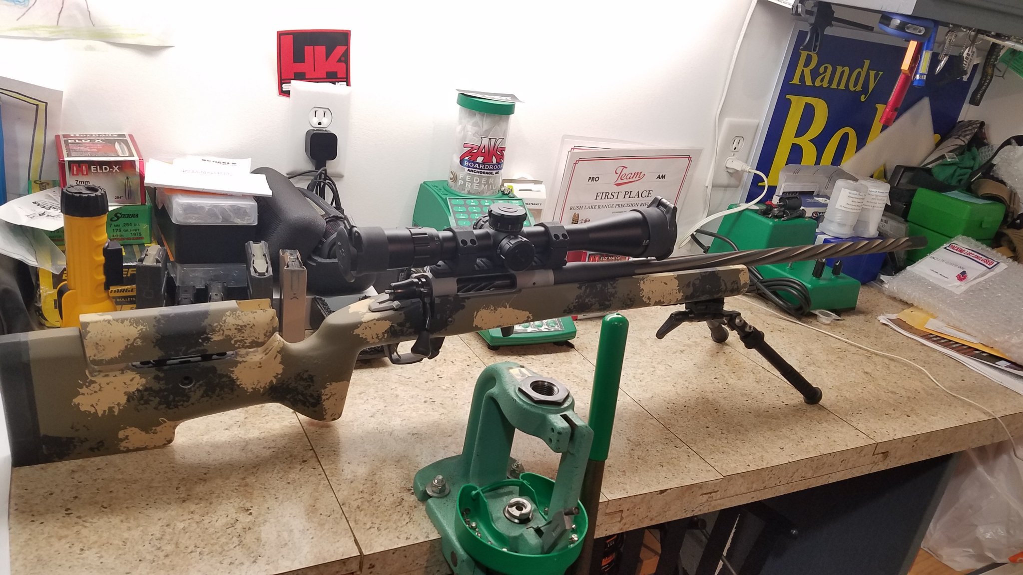

Finally made it out to shoot my 7SS I got last fall.
EVO
K&P 3b @ 26"
Manners T4A (for a Rem700)
Triggertech Special
Bushnell LRTSi
Barreled action done by LRI
I loaded up qty49 175 SMK with Ramshot Magnum and BR2s to get started with a couple months ago. I tried to keep it really conservative being there wasn't info out there for this bullet/powder combo.
Shoots good. Scope and rings came off my PVA Nucleus in 6.5cm, only made 2 quick horizontal/wind corrections. I had feeding issues so I was single feeding. Hoping I just need to play with the mag lips some. I'm not liking the play of the MDT mags in the mini-chassis. Also had some weird trigger phenomenon going on; there was about 6-7 shots where there seemed to be a stall or lag for a few nano-seconds. I swear you could hear a spring/click happen. I'll search around on that and probably try to reach LRI and Mack Bros about it.
Want to get a MCS-EH1 stock for it, but I'll see how this feeding thing turns out before committing.
That's a hang fire. Never experienced it with large primer magnum cases, but have in cold weather with rl26 in small primer 22 creed brass a few times. Hows headspace? How much is the shoulder coming ahead first firing? What's your pin fall?
This is my first time firing the rifle, I'll measure how much growth there was with my comparator.
And measure the bolt/pin depths. I spoke with Mack Bros an he said the difference should be about .050"-.055"
Dale did give me instructions to adust but was getting too technical for me not having the bolt in hand.
