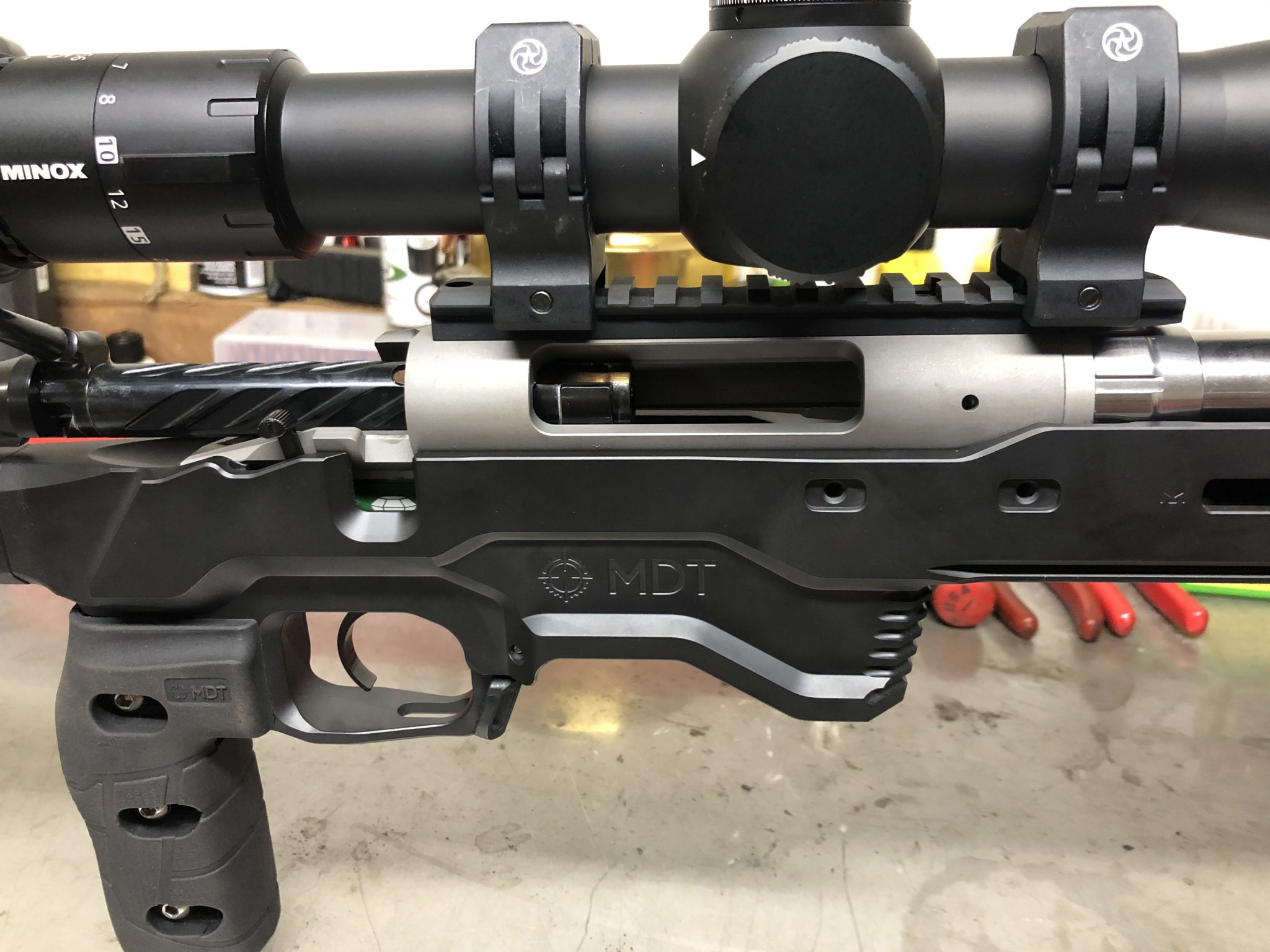

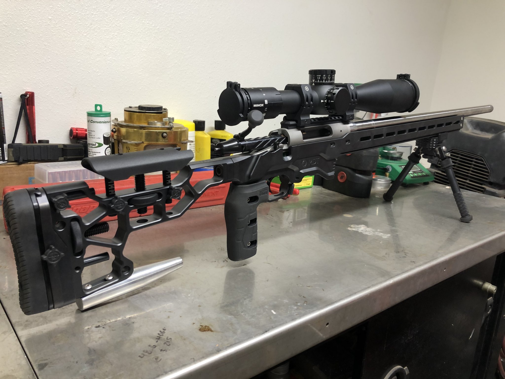

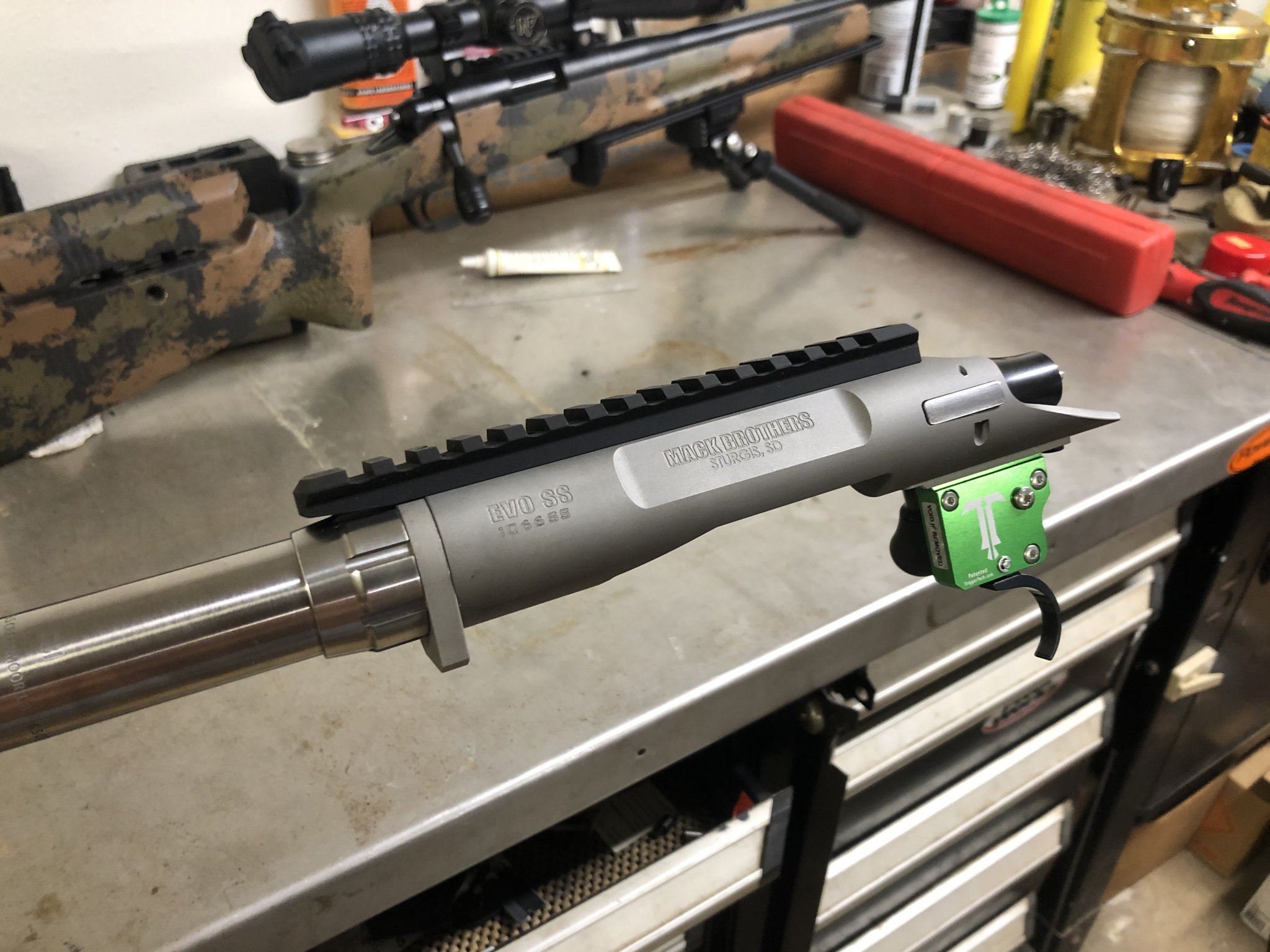

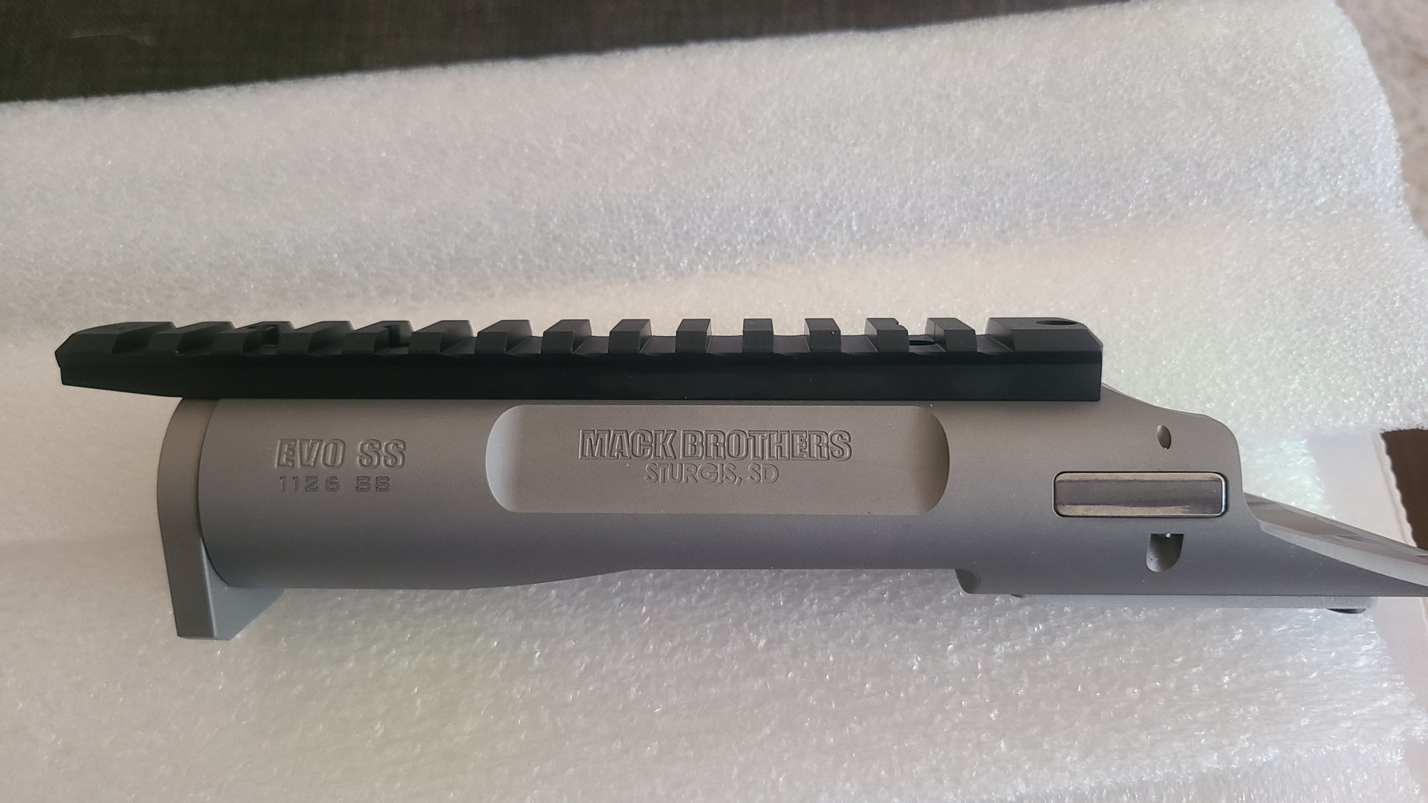

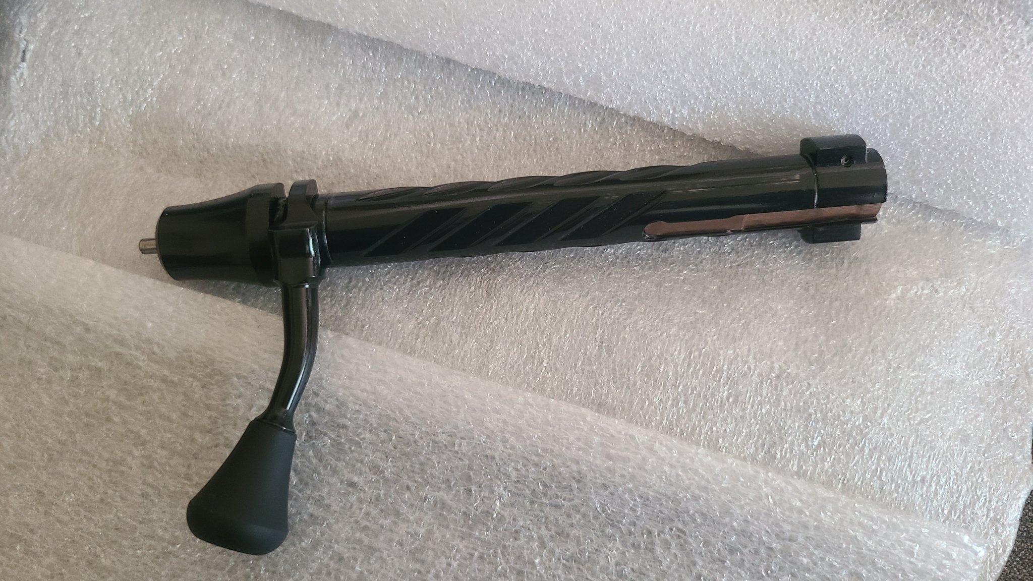

    Finally picked up my Mack Bros. Stainless action. Really like this over my blue printed Rem700. I've shot AIs and MPAs before but this is my first custom action for a new project I'm looking at doing. Love the way the bolt fluting and finishing was done (I believe it's nitride). Looking forward to how it will run once it's complete. Forgive the photos if they aren't of GQ quality....

    FWIW in thinking of going 6GT or 6CM. I have my reasoning on both and I'm currently leaning towards the 6GT. Correct me if I'm wrong but the 6GT looks like it uses less powder than the CM and the way things are right now I would love to save on some powder consumption. Don't plan on shooting any comps right away but I do have access to a 1k yard range.
    Parts on hand for the build:
    Action, 1-7 m24 bartlein 29in, Area 419 side-winder. Looking at going with Timney's hit trigger, and possibly Cadex Strike Nuke chassis (until I can upgrade later). Will top it off with my PST Gen 2 EBR-7

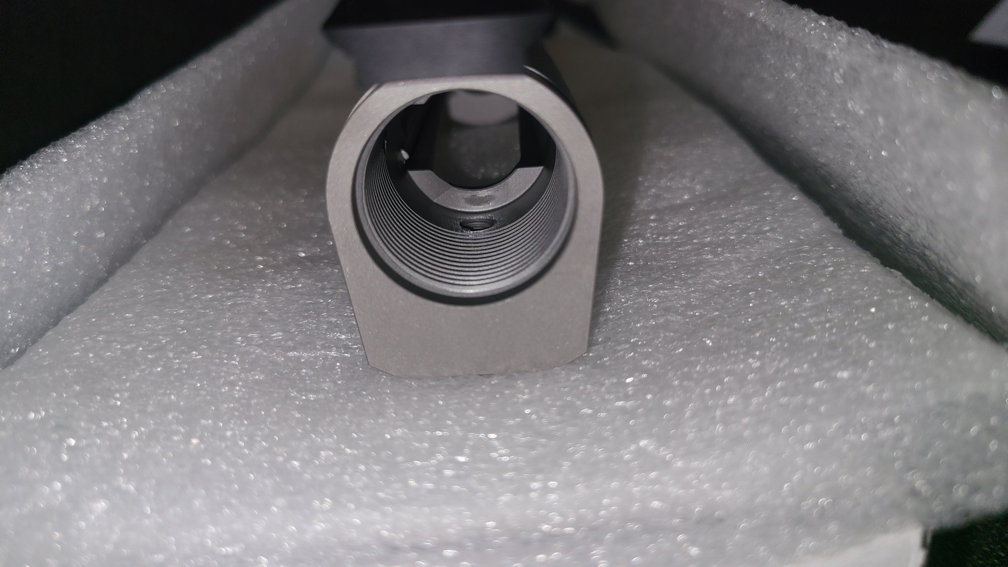

    They will thread in for sure. The only thing I don't know, because it's been ages since I spun up a M700 barrel, is if the bolt nose counterbore is the same as a M700. From what I'm finding online I'd guess yes, but can't say that for sure.
    And I guess it depends on what you mean by "prefit". Like a short chambered shouldered barrel that will require a GS to fit anyway? Probably could be made to work by the GS, no doubt.
    A remage, where the end user screws it together and jam nuts the head space *should* fit, but again it will come down to bolt nose counterbore dimensions clearances.

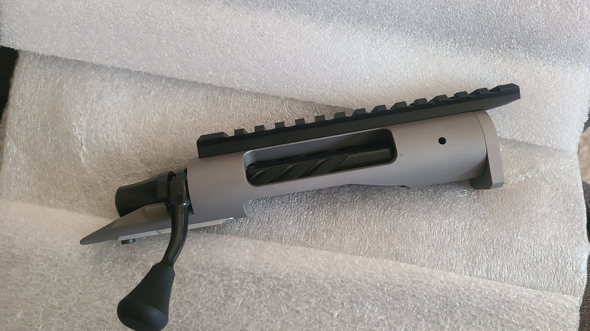

    Got my action back with new revised bolt. It was 20 thou shorter in measurement than the original that was sent back. Remage barrel was threaded on and head spaced with no problems. Atlease I can shoot it now while I wait for a carbon bartlein.
