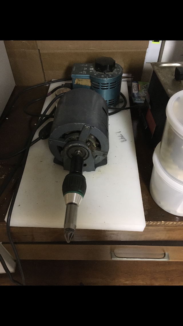

Oh yeah, seeing videos of that thing run from what looks like a 1/2 or 1/4 HP AC motor, it's smooth and powerful.

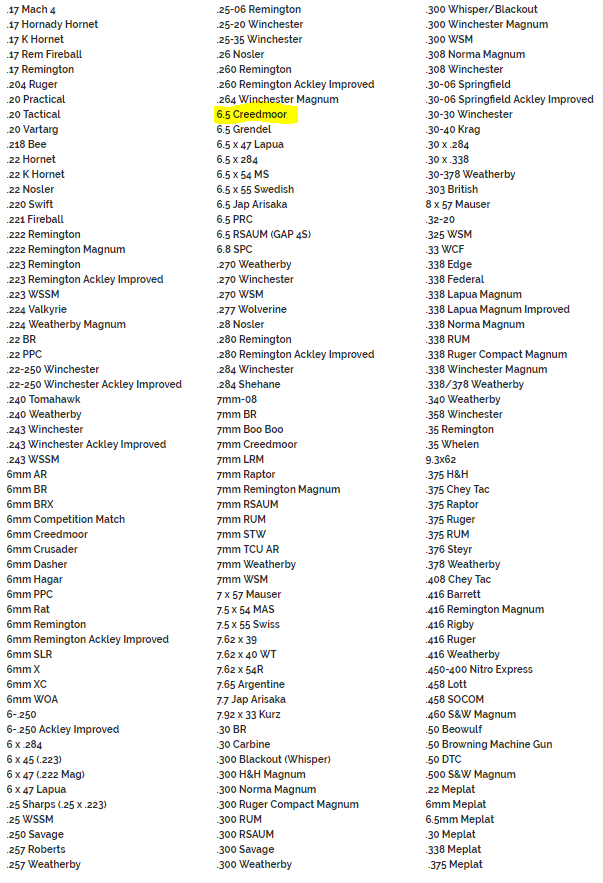

I was seriously considering one, but for some reason, Giraud doesn't make 6.5 Creedmoor dies for it.
Yes they do. They just dont make the drill mountable triway for it. The benchtop machine has creed case holders available. Just an fyi
