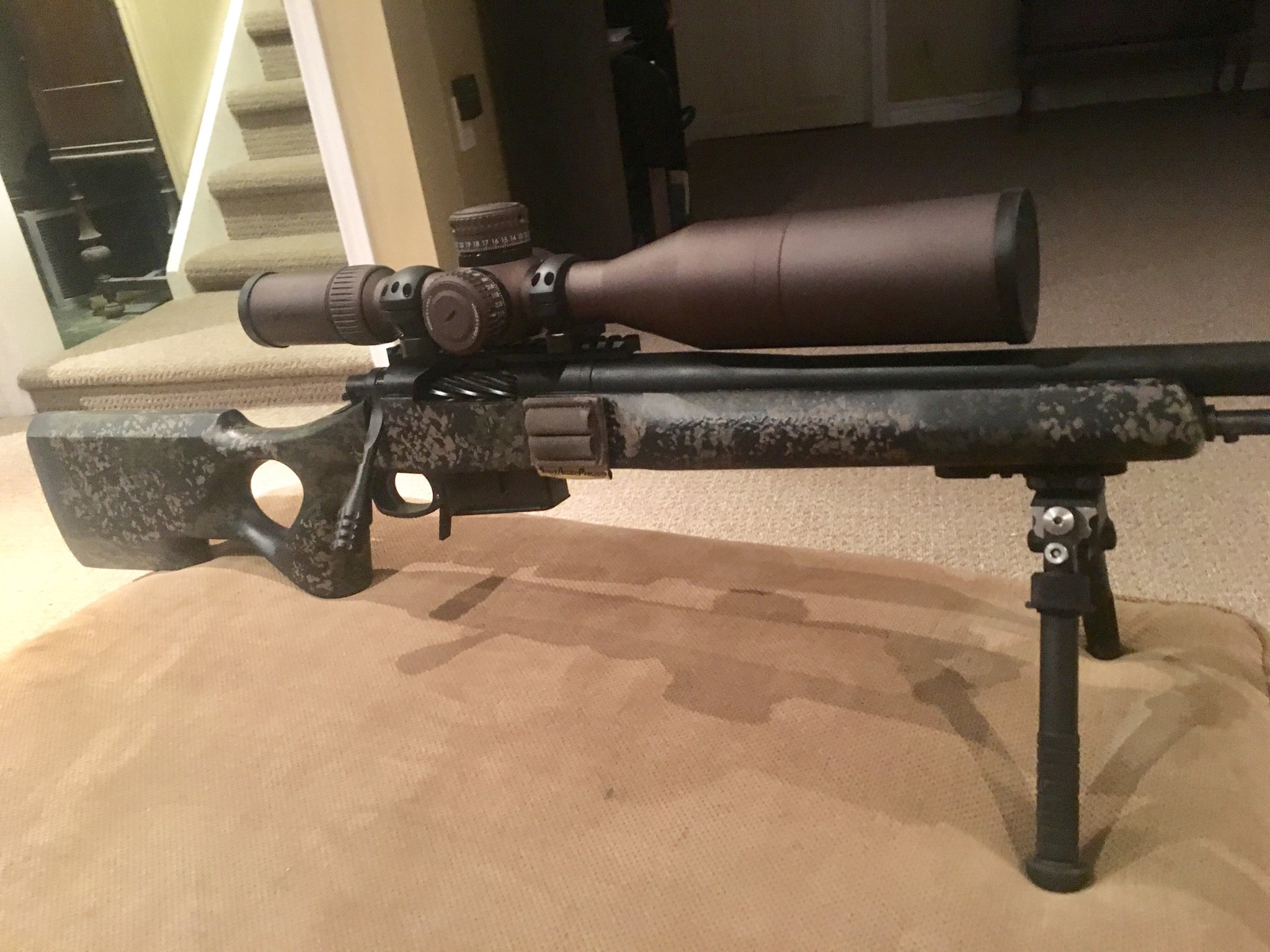

New rifle showed up a few weeks back there and working out a couple kinks and getting some stuff together and almost got everything straightened out. Rifle is a custom 6mm creed, kelbly atlas action, manners t5 and badger bottom metal. One of the last kinks is the mag. I purchased an arc mag in hopes to run a short 10 rounder.
This mag latches beautifully, free drops but the bolt slides clean over the round. I pulled my ai mag from my stiller 260 build and it feeds flawlessly and the arc works fine in the stiller/Mcmillan/ptg combo, but not the kelbly/manners/badger combo. This rifles main purpose is target and starting my luck in comps but can’t get the 10 round to feed.
Any suggestions on how I can get this mag to feed or am I stuck with 5rd and long 10 rounders
