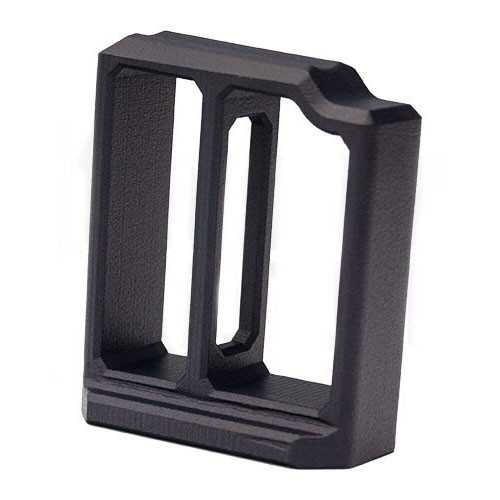

I use these instead of magazines when I single-feed. Got one that fits my MPA chassis, and one that fits my Tikka.
Geez...those things cost almost as much as a magazine
