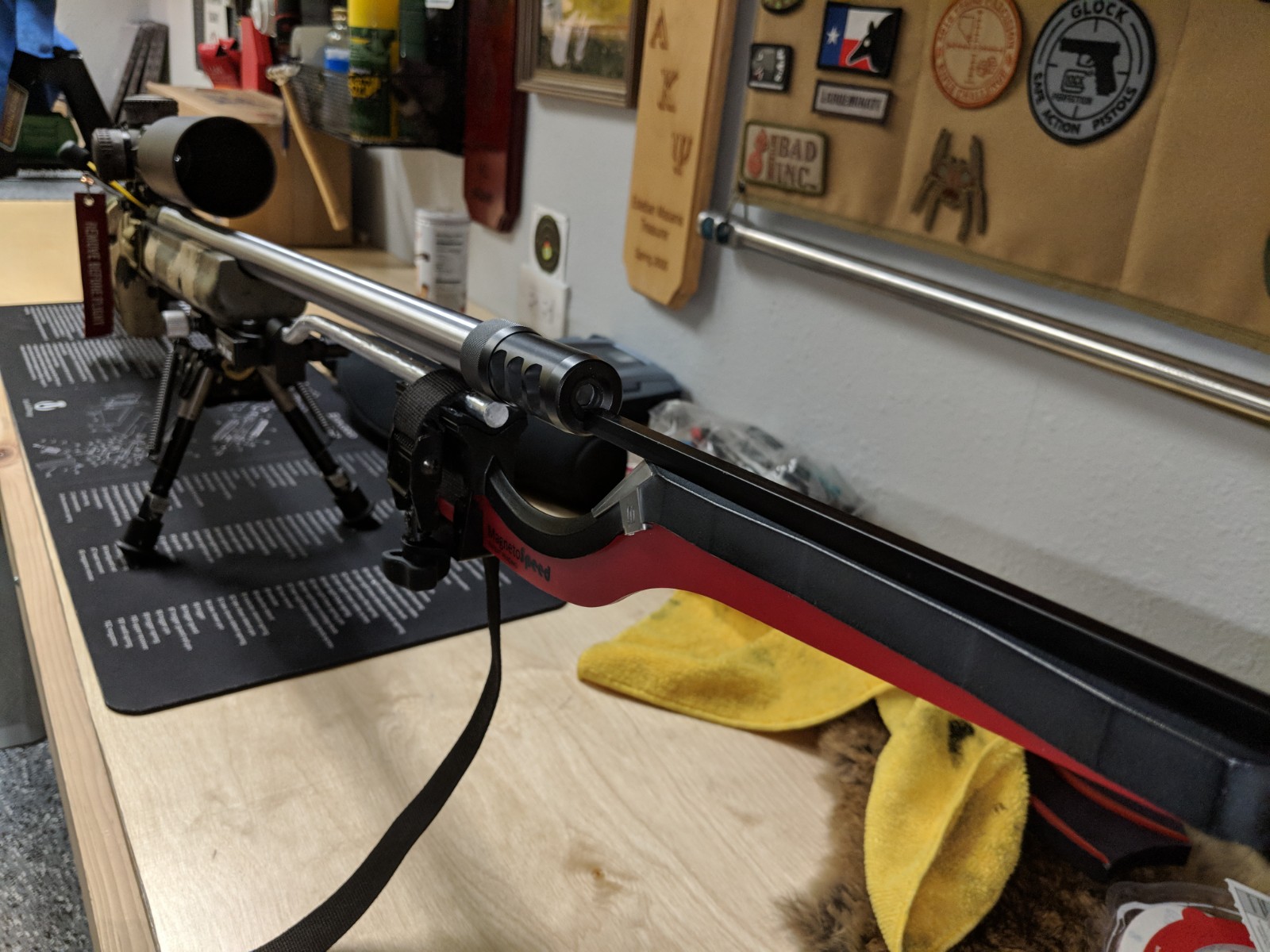

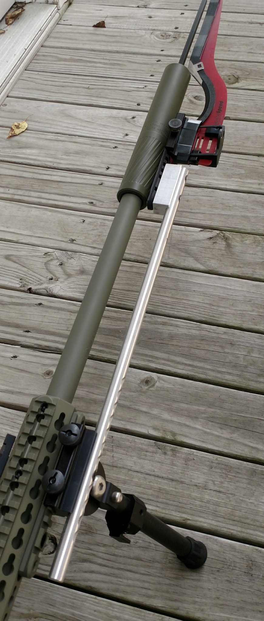

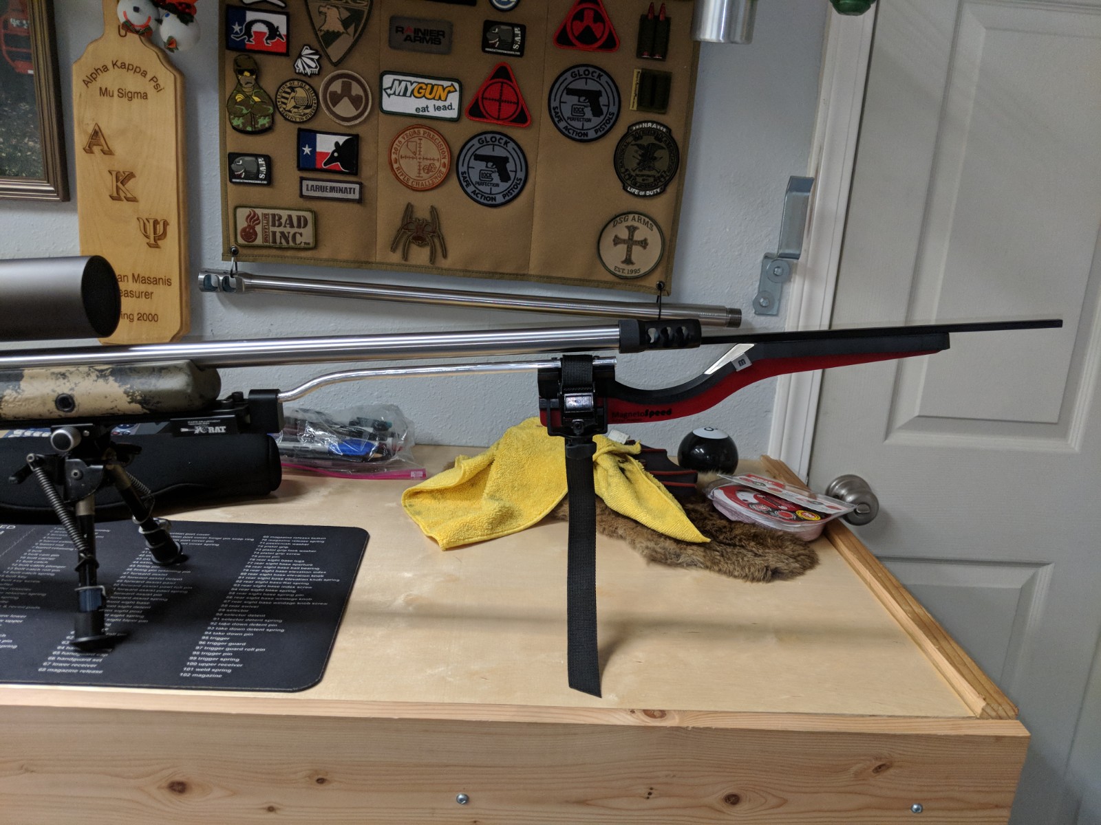

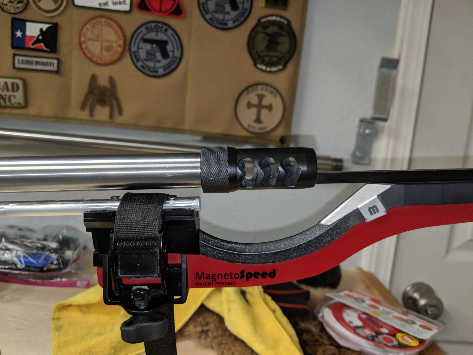

Just thought I would share. As I stated earlier I really like the idea of the MPA but the rod placed the magneto speed to low. So I got a new aluminum one from a local supplier. A few moments with a heat gun, a bend here and a bend there and it works perfect. Took it out to the range the other day. I ran 50 rounds over it on my 6.5 and another 35 or so on my 308. Not a single issue what so ever.
View attachment 6877374View attachment 6877375View attachment 6877376
How did you adapt MPA Rat Magnetospeed adaptor to stock / harris bipod?
