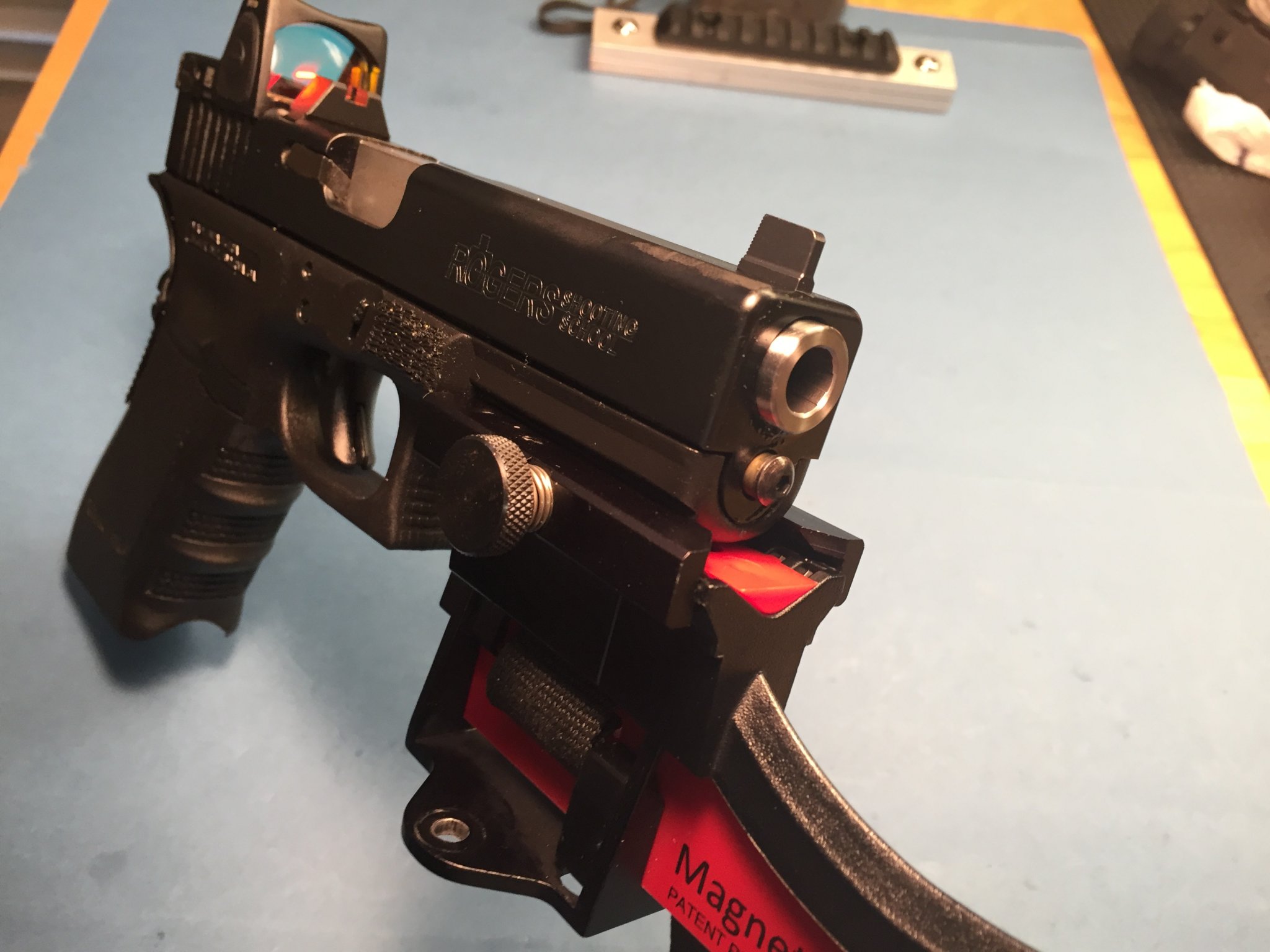

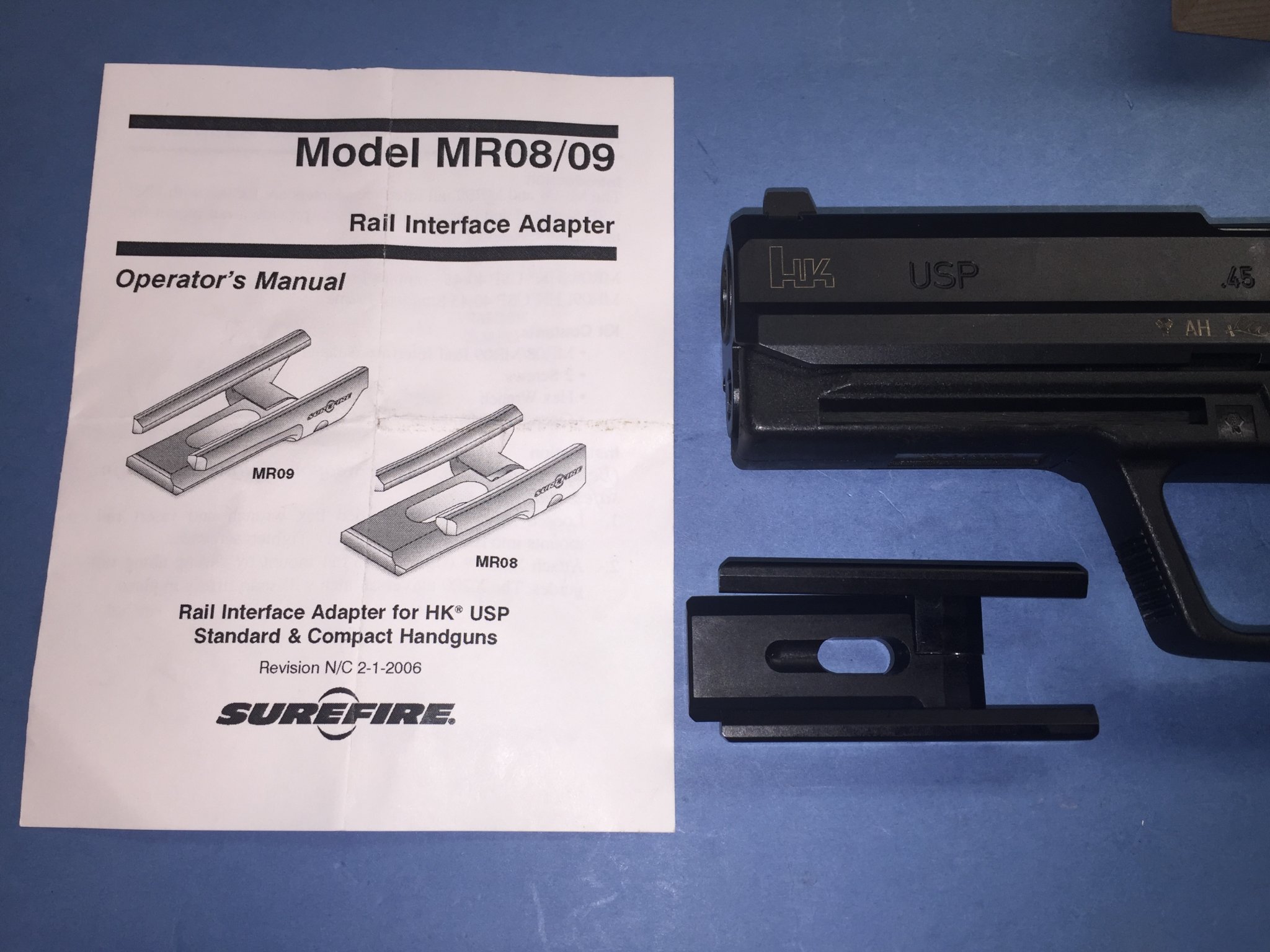

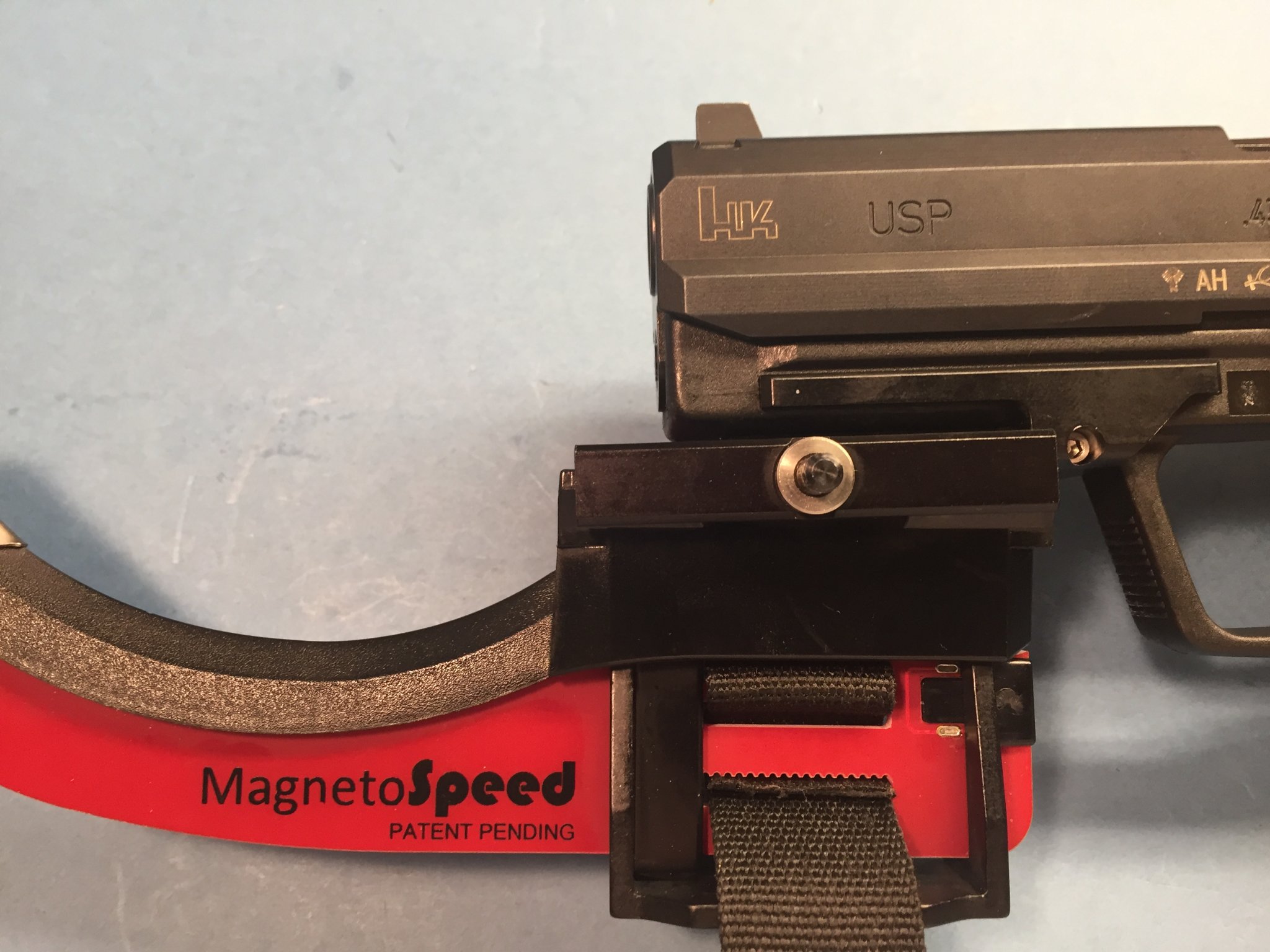

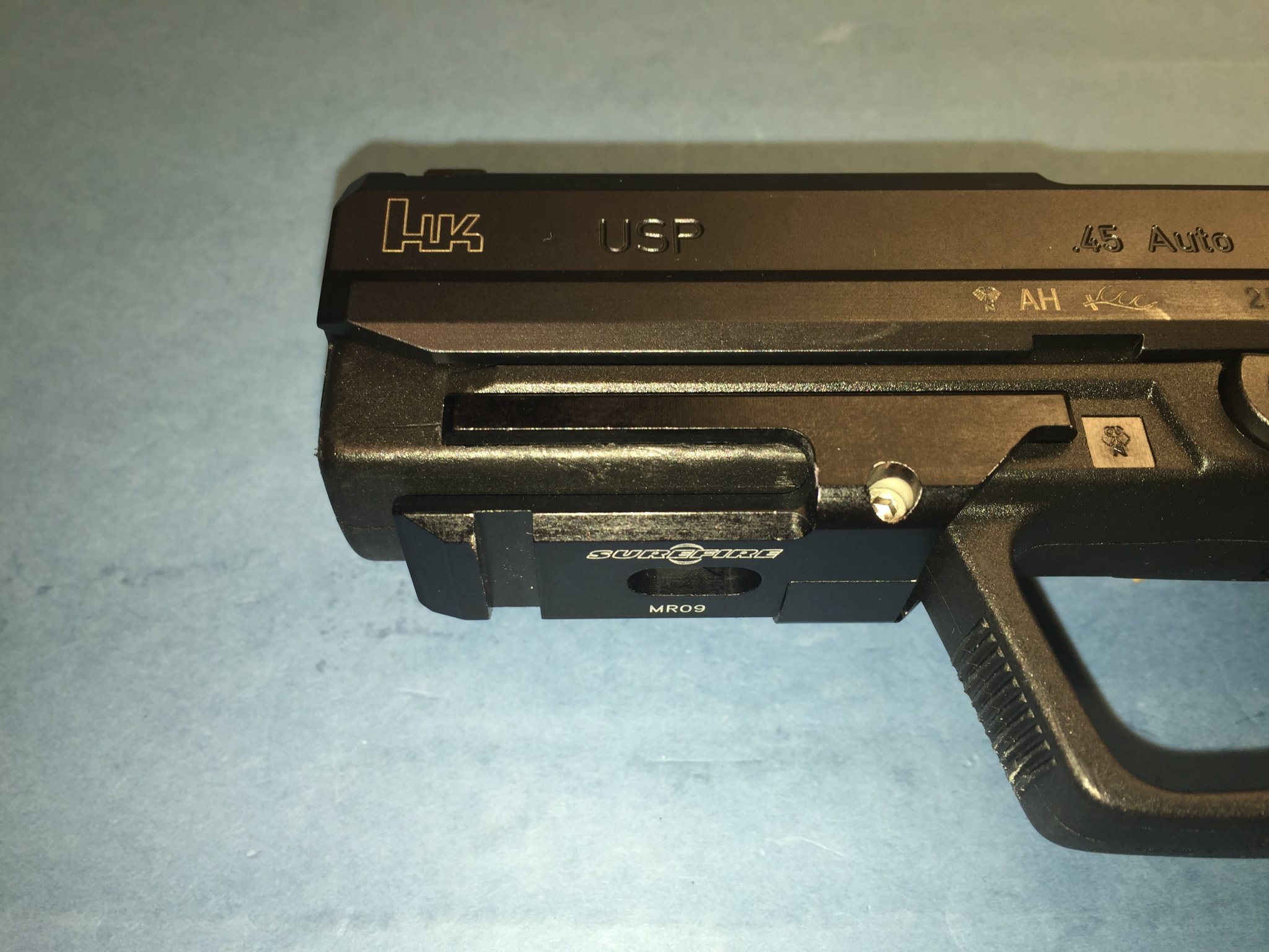

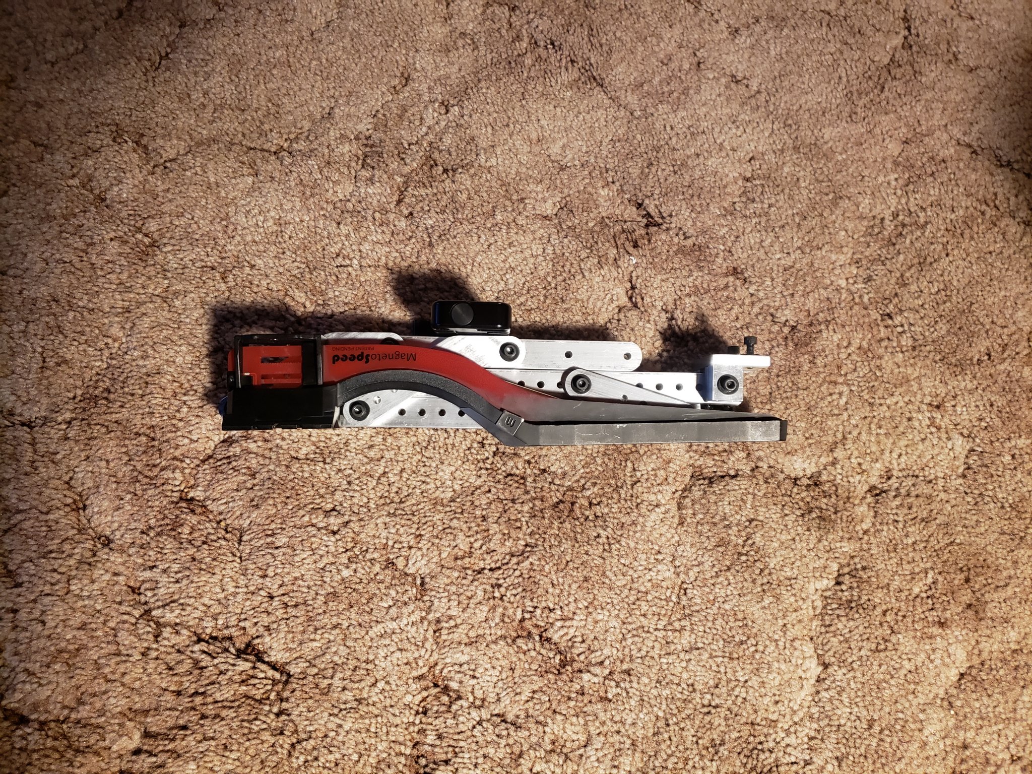

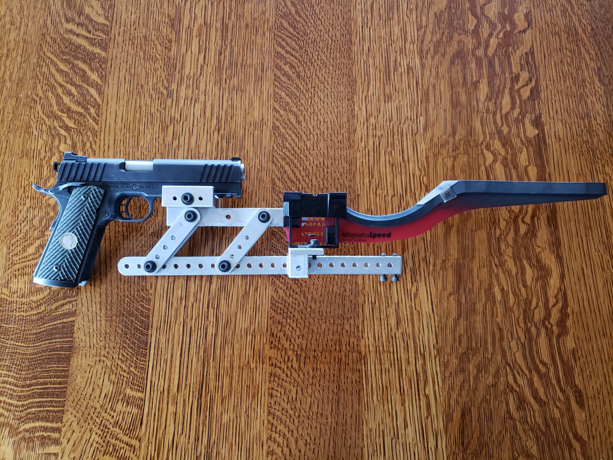

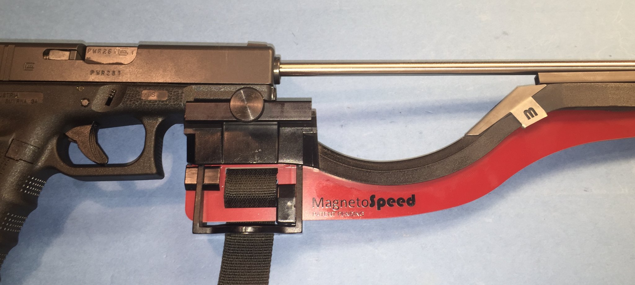

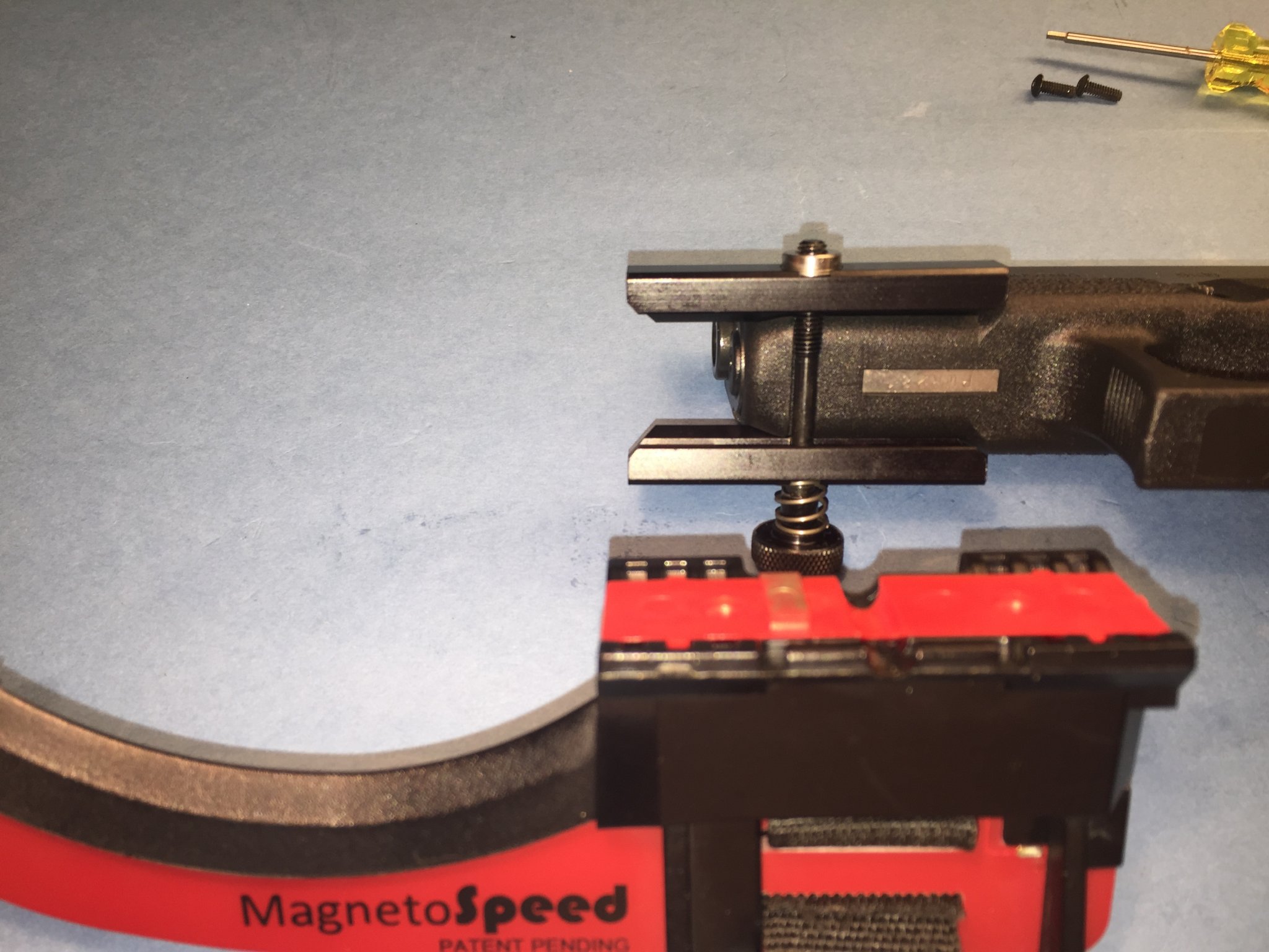

    OK, I'm thinking about upgrading to a V3 simply to be able to use it on a railed pistol. Only concern is it kinda looks like an after thought, how well does the adapter really work?
    ^^^ It works fine on single slot Glocks without a common pica tinny rail and with a SureFire Rail adapter for proprietary
    legacy HK rail patterns.
    Examples: G19, G17, HK USP
    Reactions: sparkyv
    Thanks Strikeeagle, those pics are much, much better than the ones I found through google. I wonder if someone like MKM could make a trigger guard adapter for no rail pistols?
    Hey, is GG&G the only place making the rail adapter(for the USP) now? Everything else looks like it's made in China, or discontinued.

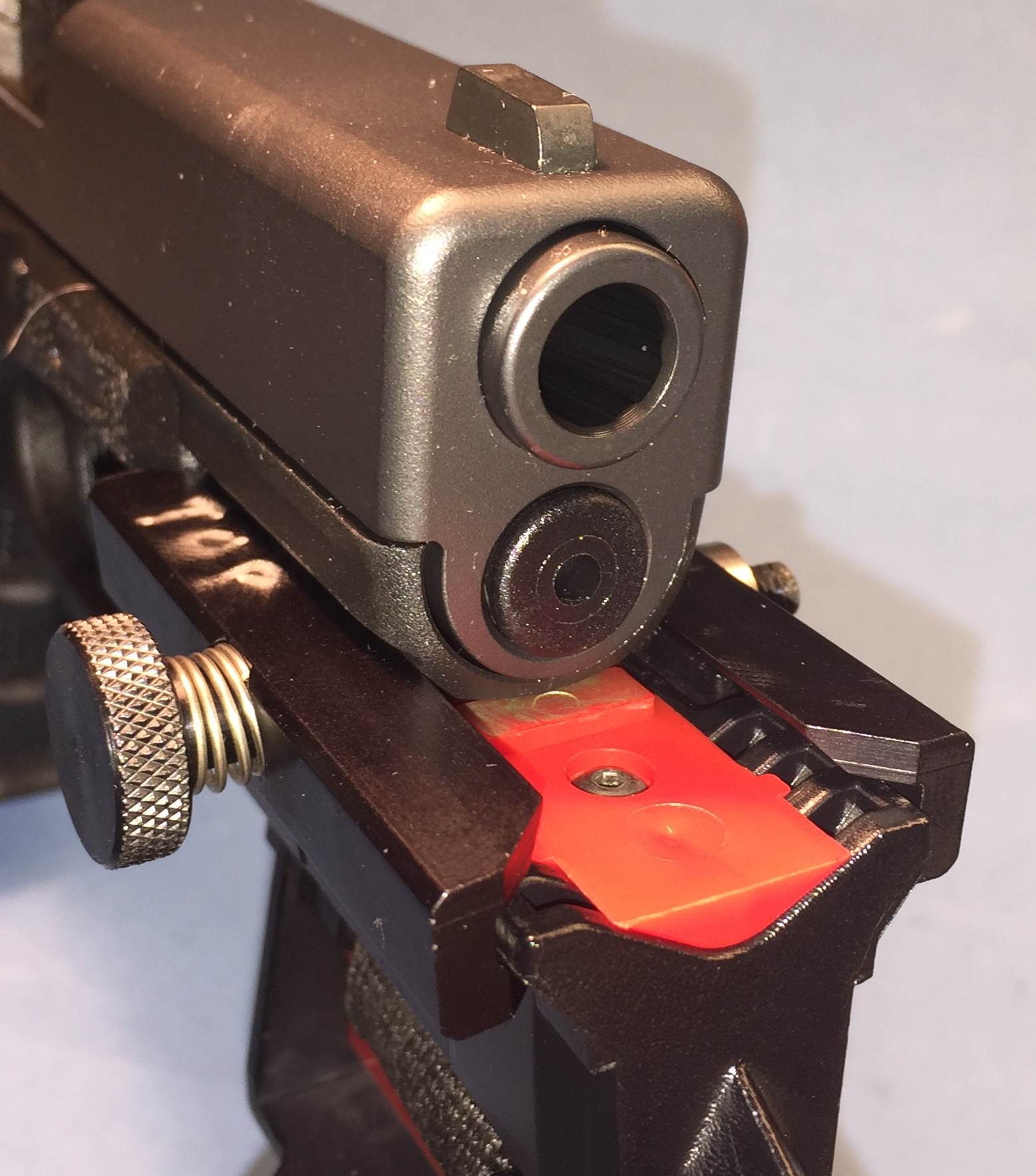

    Beware of the upward rake a lot of the (usually gen 3) glock rails have if using it with a glock.
    Have you tried this? With the chrono? The rails on a Glock aren't meant to take much weight, especially cantilevered out like that. Chances are it won't function. That rail is pretty much strictly for lights. Anything tight on there or heavy will warp the dust cover enough to prevent it from cycling. If you've ever seen a Glock in slomo, you'll see that the frame twists and bends at the dustcover.
    But if you have it all it may be worth a try. Perhaps resting the weight of the chrono on a bag or something would help. Good luck!
    I did; and it did not work. Using the magnetospeed rail adapter, I could not rig it such that a) it would pick up the bullet; and b) the bullet would not hit the magnetospeed bayonet due to the significant upward angle the sloped rail induced. This was with multiple gen 3 glocks.
    I am sure a slow motion video would have showed the whole setup vibrating all over the place.

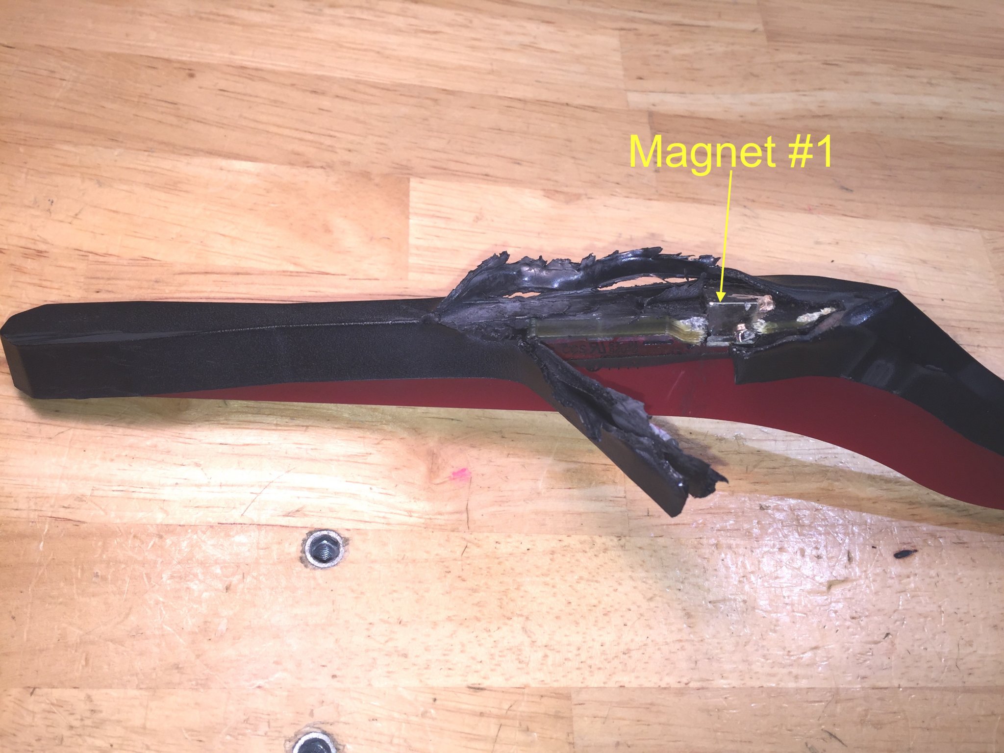

    This shameful result actually occurred while I was prototyping free-floating rifle mounts for it. Emphasizes the need to really re-evaluate the clearance between shots or shot strings.
    Necrothread bump. Anyone using on a Beretta LTT Elite or similar Beretta model? Same rail as the FS, A1, etc...but different from the later M9A3/4 and newer 92's like the X). It's soooo close to being spot on yet still so far away.

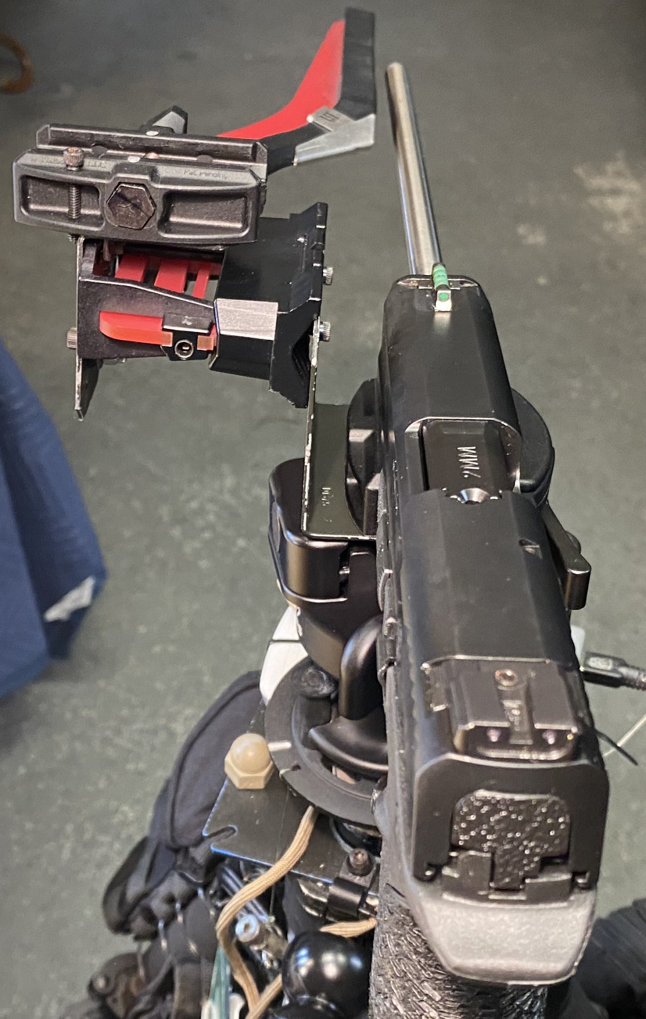

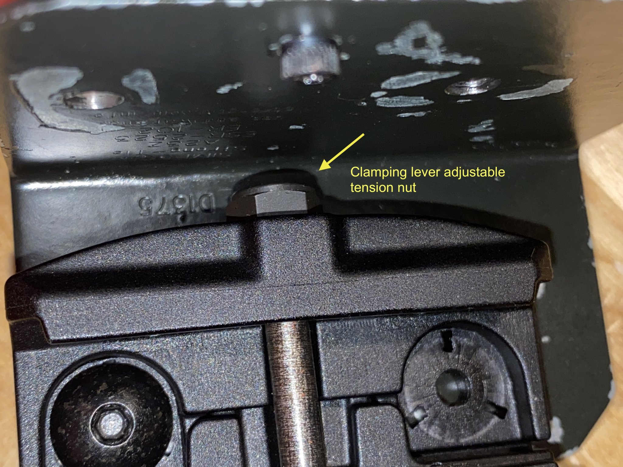

    After scraping up the rail a bit, I figured it out. When in doubt, cut up the cheap parts. The clamp portion of the rail adapter is too long for the Beretta's rail grooves. I cut a bit off both sides of the rail adapter clamp and it works like a champ. Puts the barrel a bit less than half an inch from the top of the Magnetospeed. Hopefully that'll work with the sensitivity dialed up a bit. Will post images later for future reference.
    Would it be possible to mount the magneto speed onto a solid fixture such as a tripod, then shoot over it, or is there a requirement that the unit be affixed directly onto whatever firearm's velocity is being tested?
    I think I would abandon the idea of attaching to a polymer dust cover. It would seem easier for right handed shooters to have the bayonet laying on its right side supported by a fixed object while holding the gun's slide parallel to it. That way, with both eyes open, you can keep an eye on the parallelism of the gun to the bayonet and still reliably have the bullet's path close enough to the sensors.

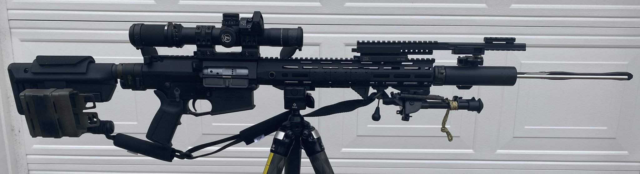

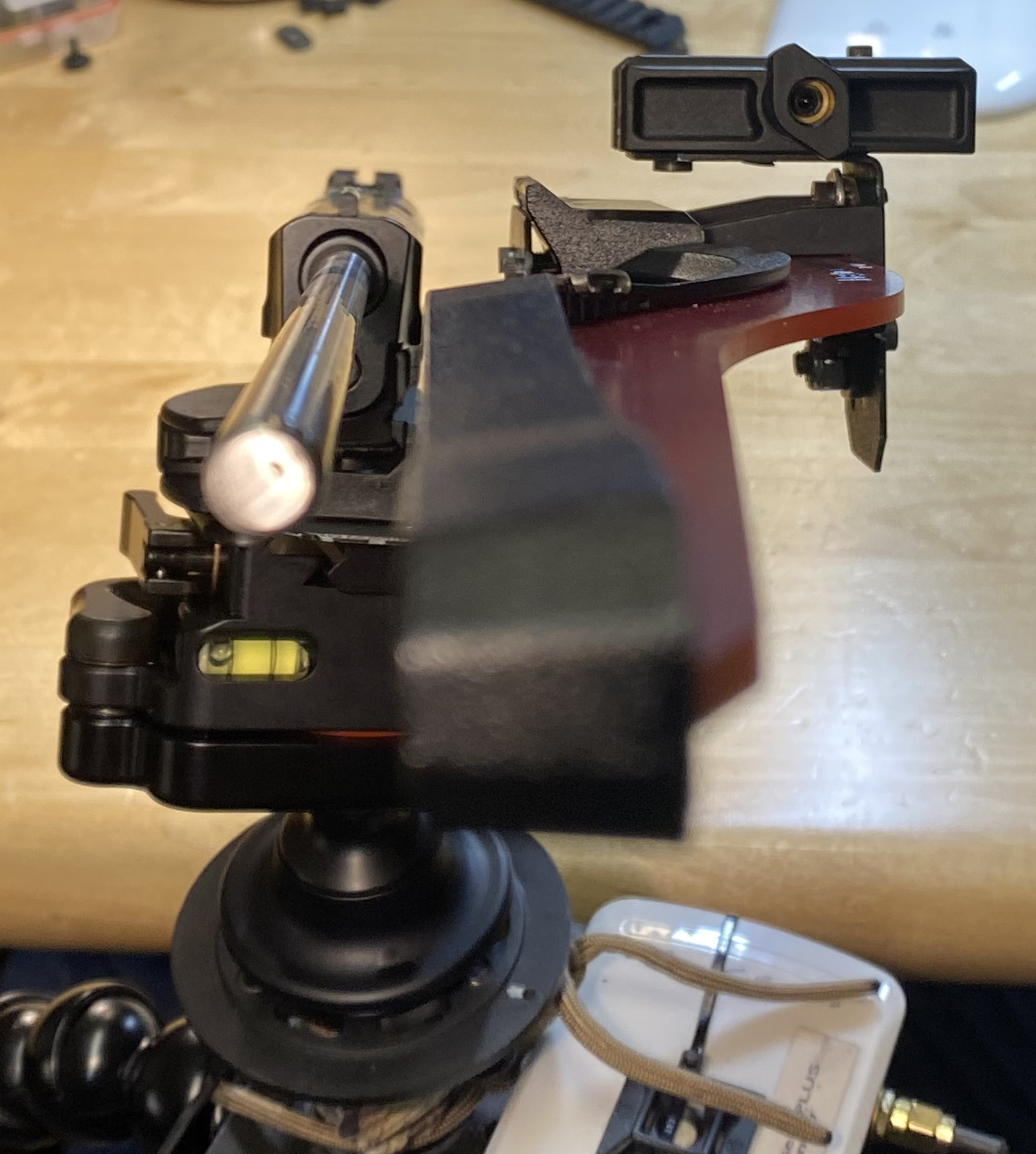

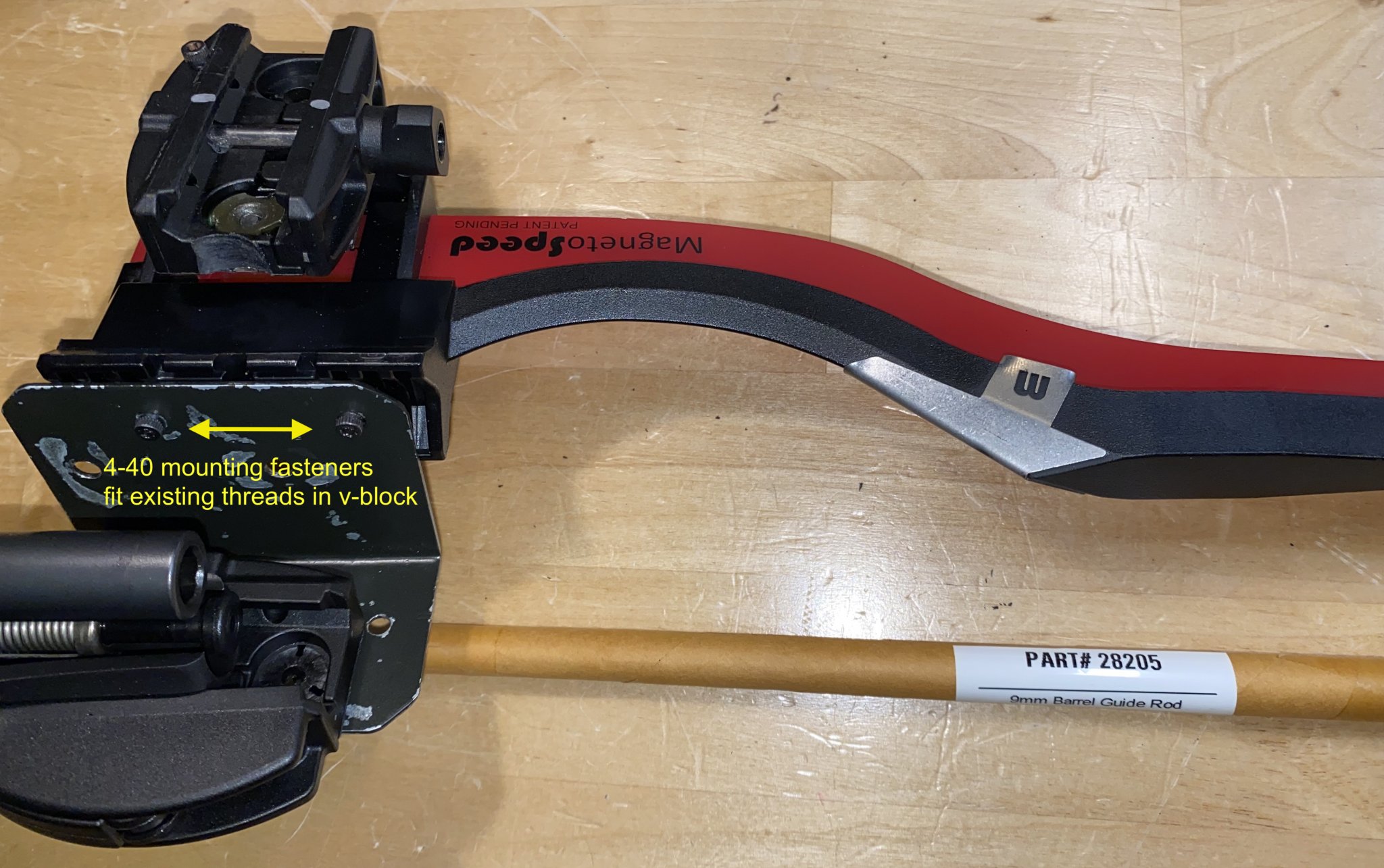

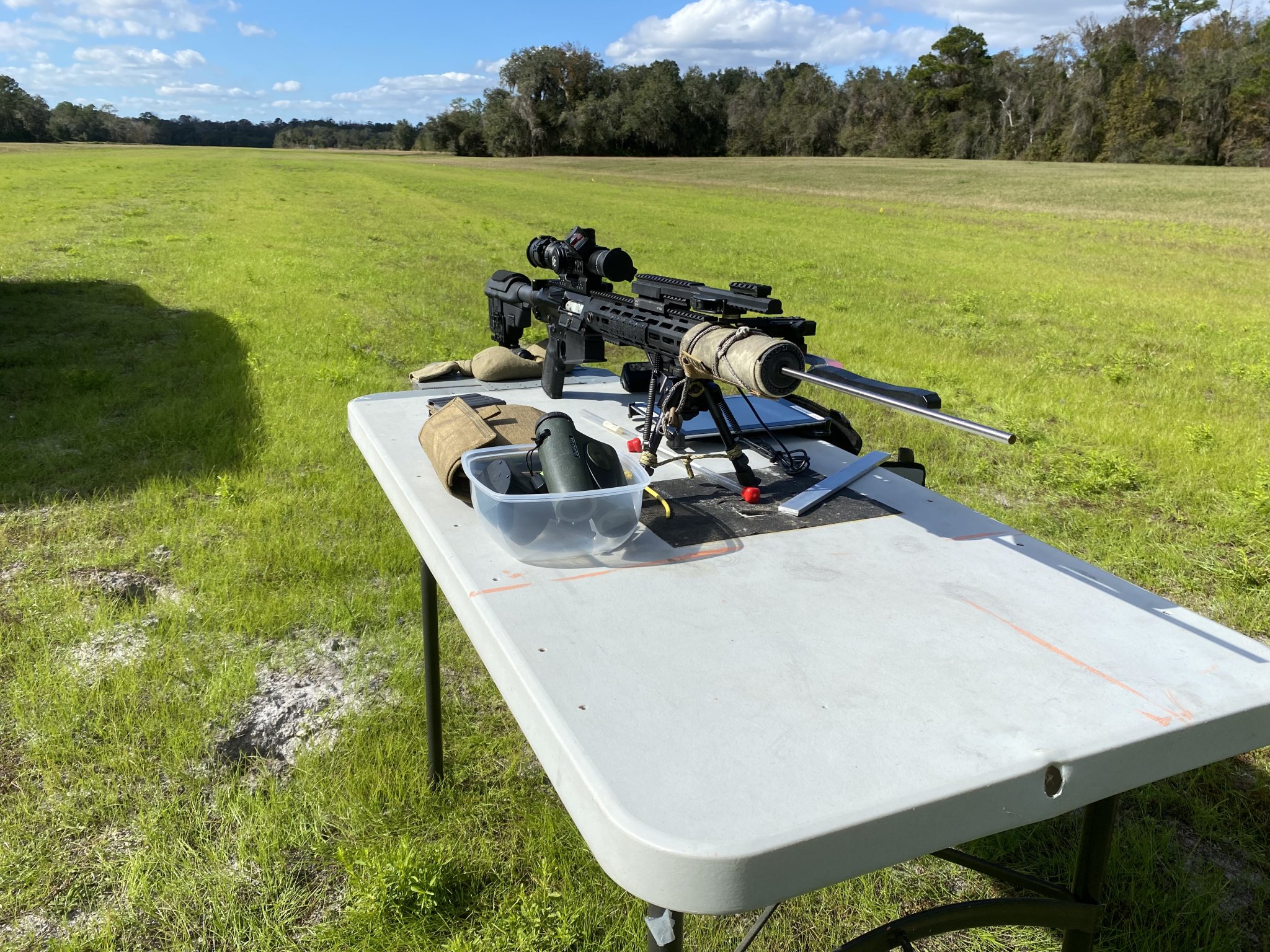

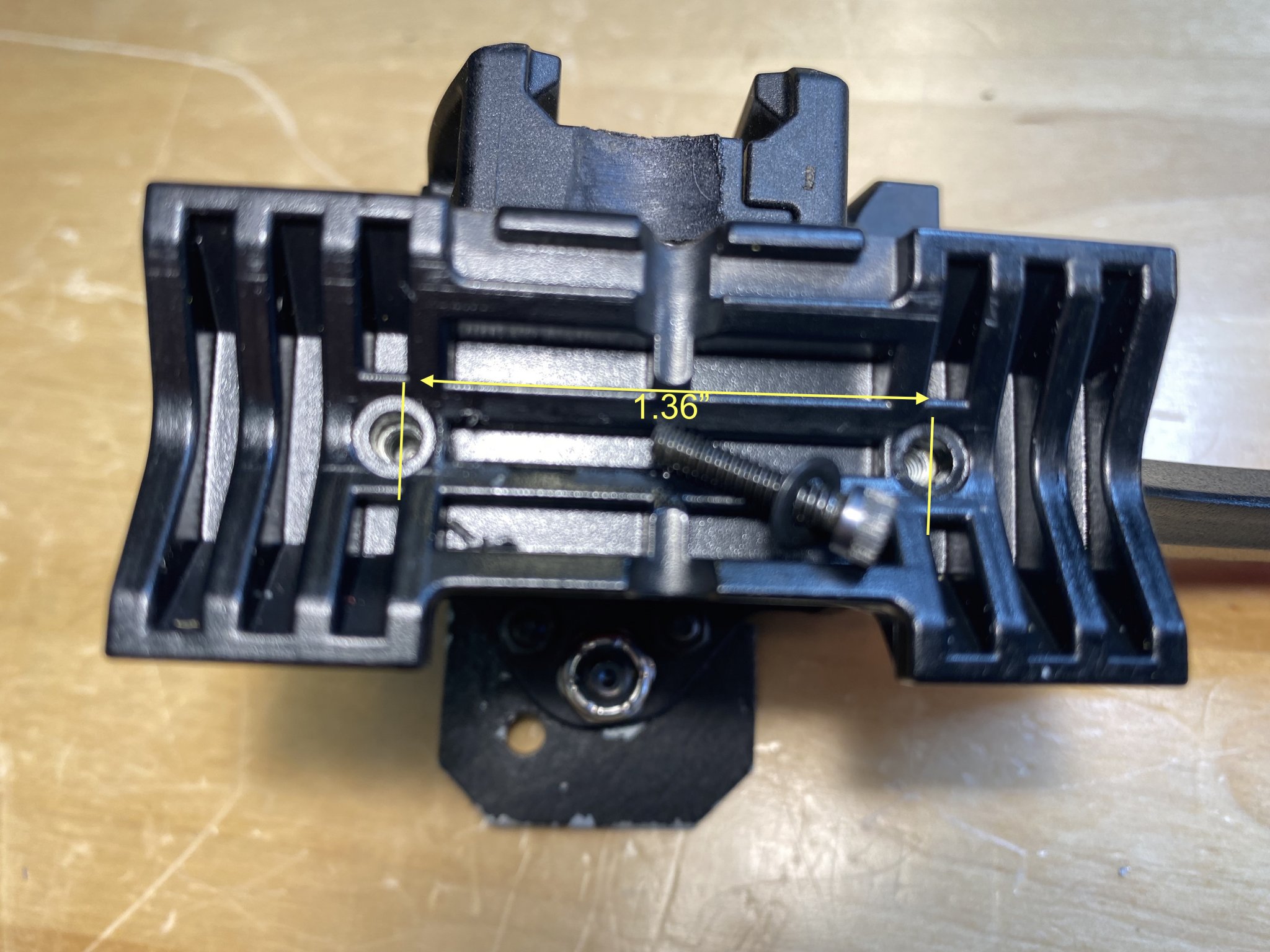

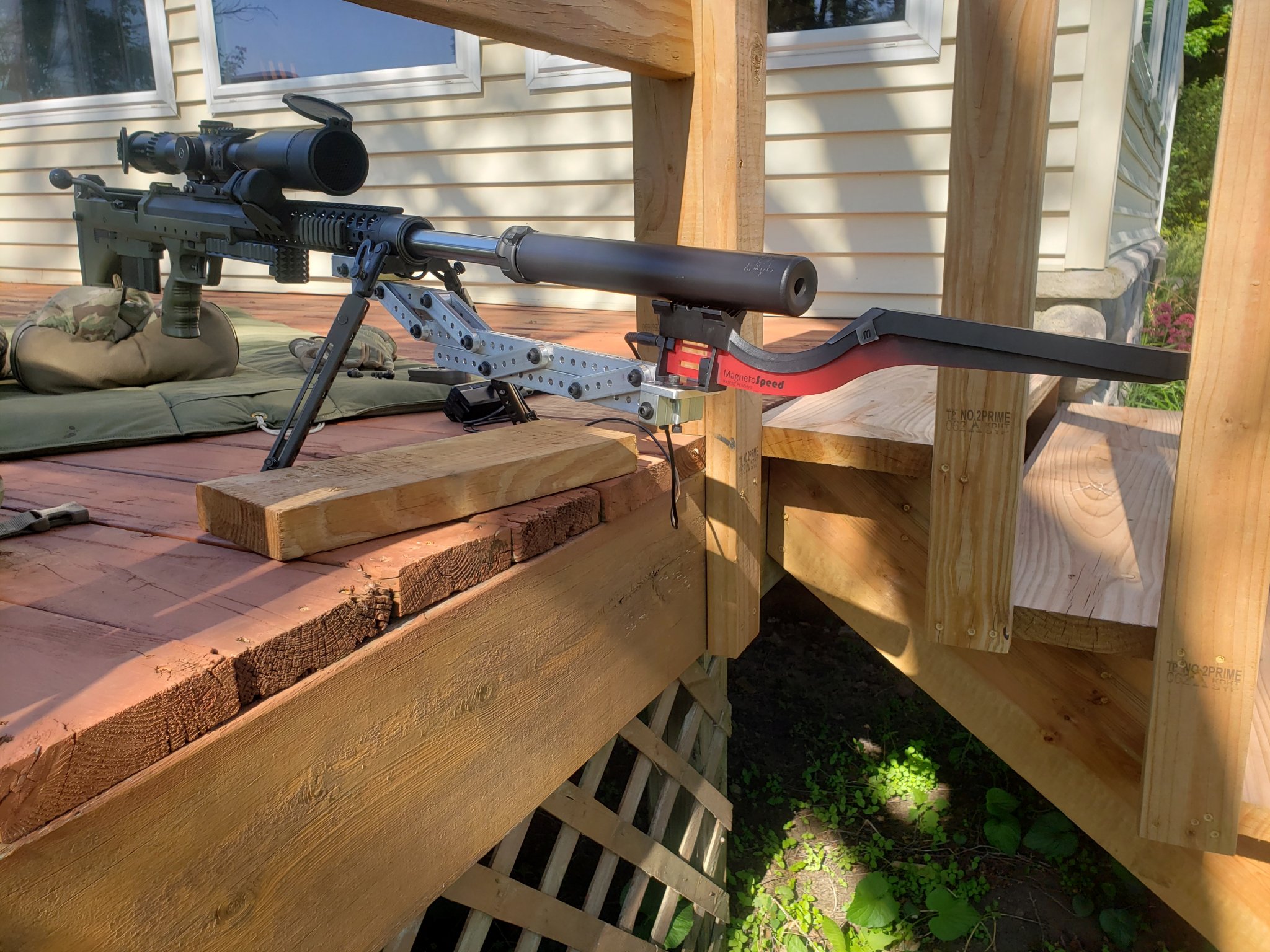

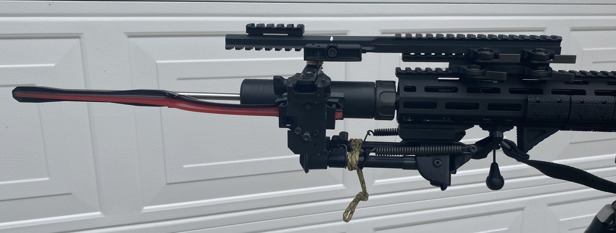

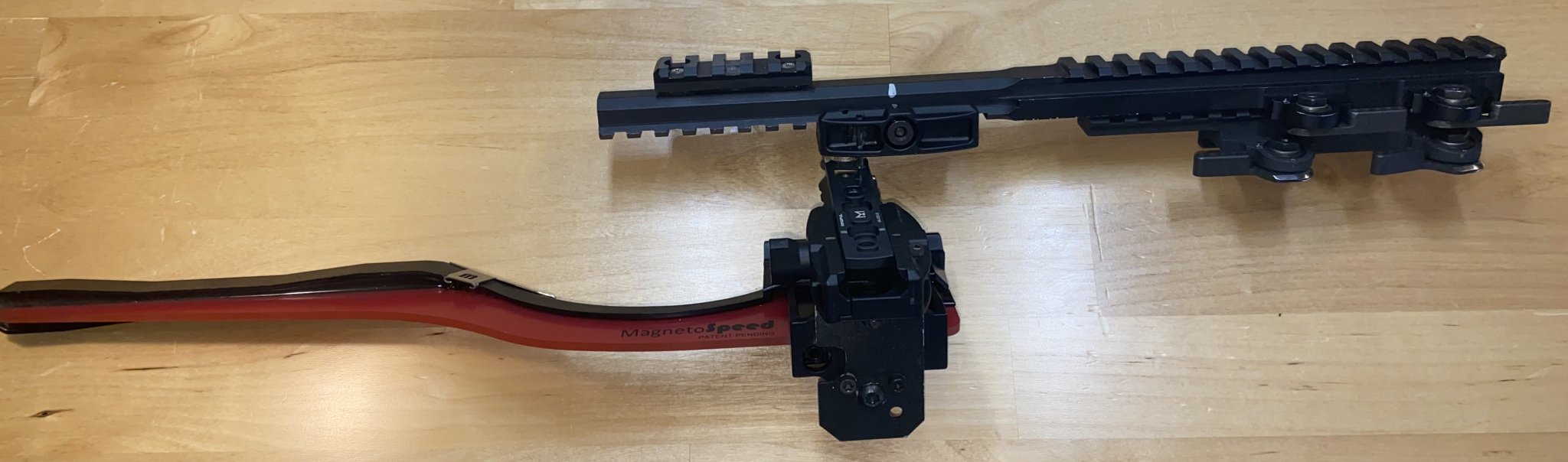

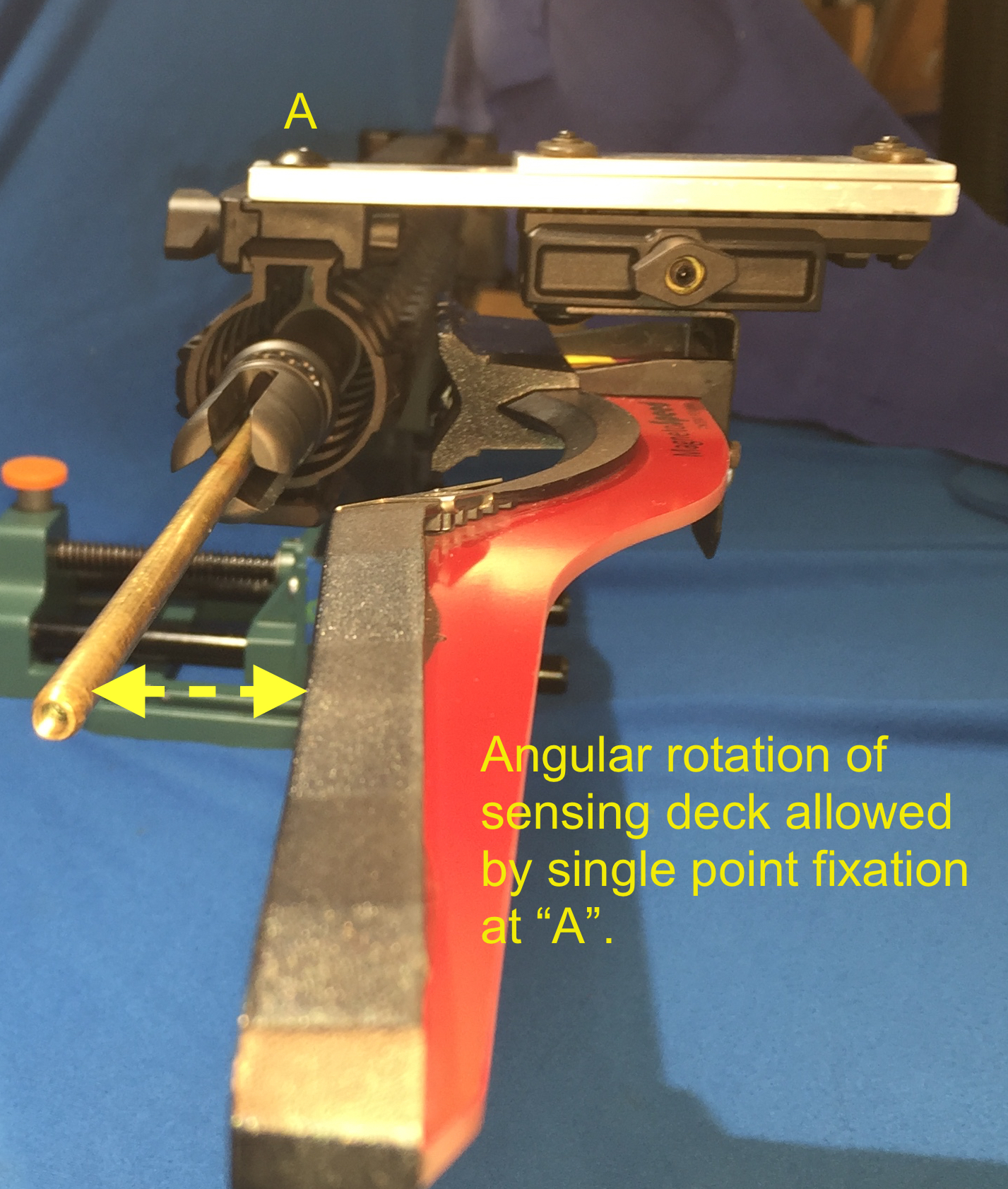

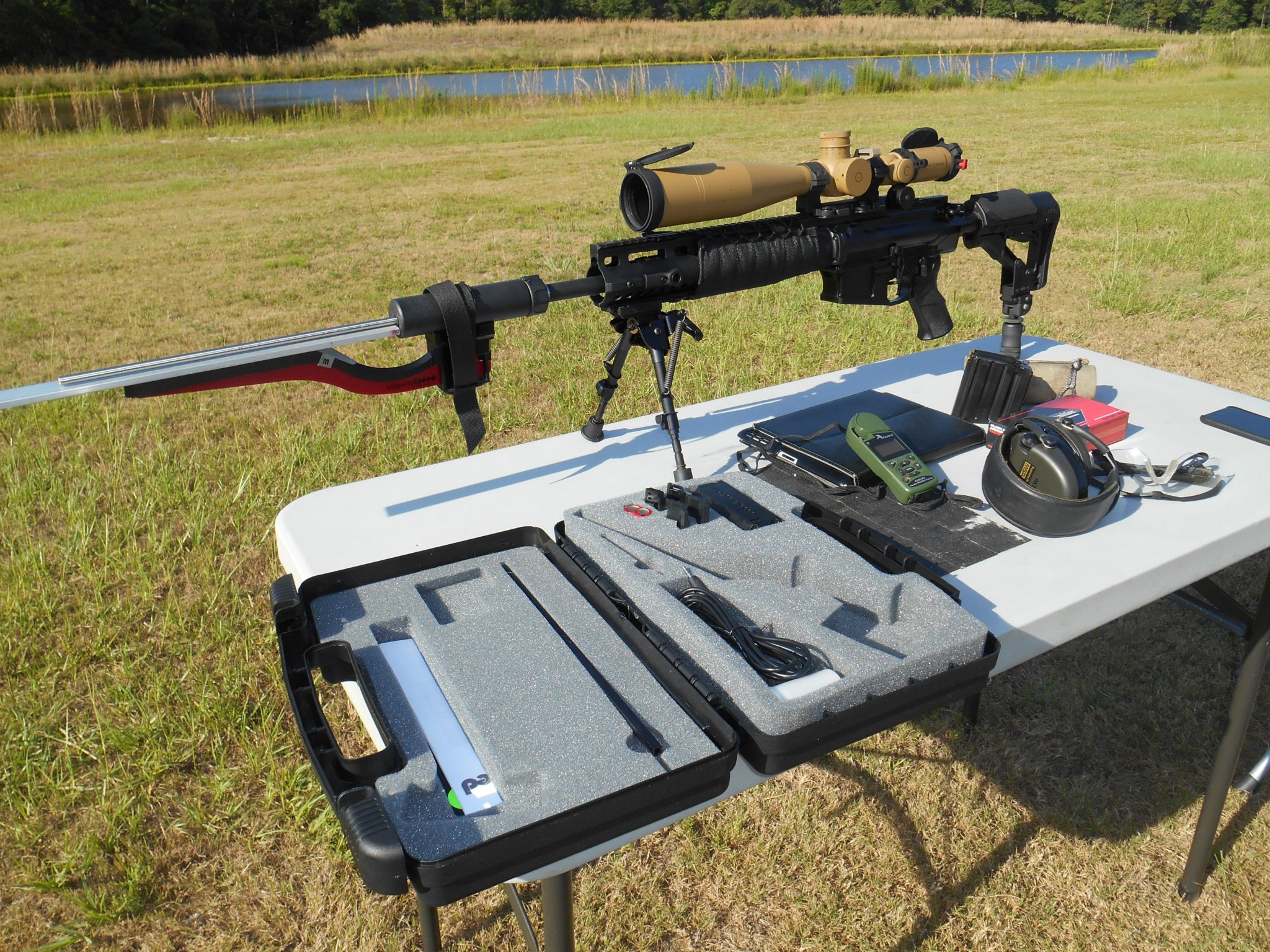

    I will be getting a LabRadar as soon as they again become available, but in the mean time I will share my MagnetoSpeed adventure which started with the V1 which had issues but still more user friendly than open chronographs at the time. I skipped the V2 and have had a couple of V3's, at least one to replace the hideous scene shown above. Around 2016 - 2017 a few of us swapping ideas regarding improving the bayonet mounting on long guns and eventually free-floating mounts to avoid POI shifts and barrel harmonic issues (as well as melting the OEM rubber v-block inserts).

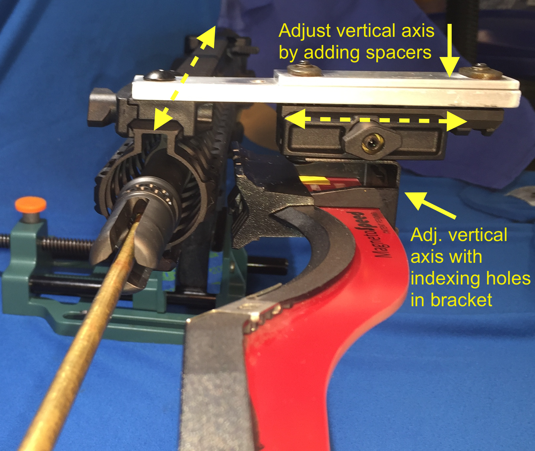

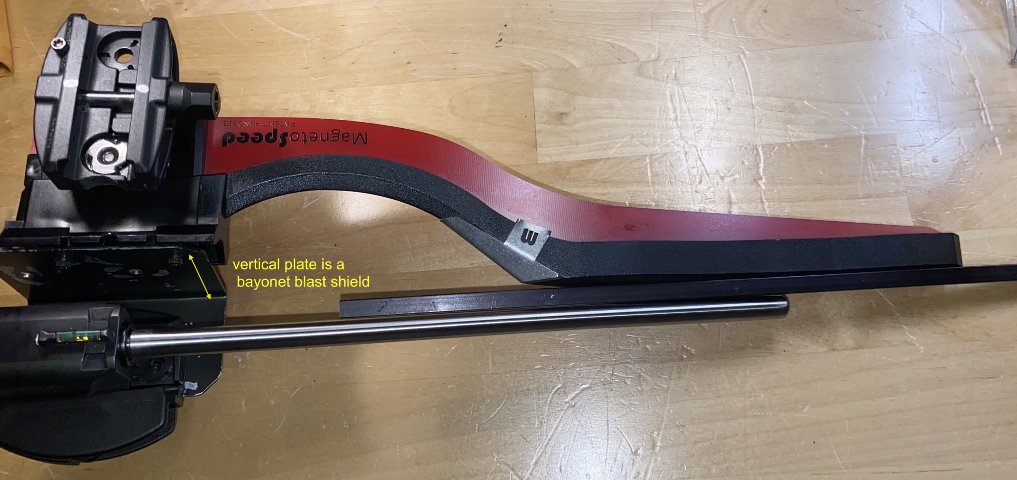

    Below is my 4-axis adjustable rifle configuration for the MSV3; it's a rigid system that I can adjust for various barrel lengths / diameters and suppressor widths. I can set it up at home and go to the range and mount it with two cam levers. I prefer having the primary mount above the
    barrel. The primary mount is from a LaRue S.T.O.M.P. platform.
    Early in this post I shared various pistol mounting to the bayonet which was effective but limited. It will take a few posts the tell my experience.

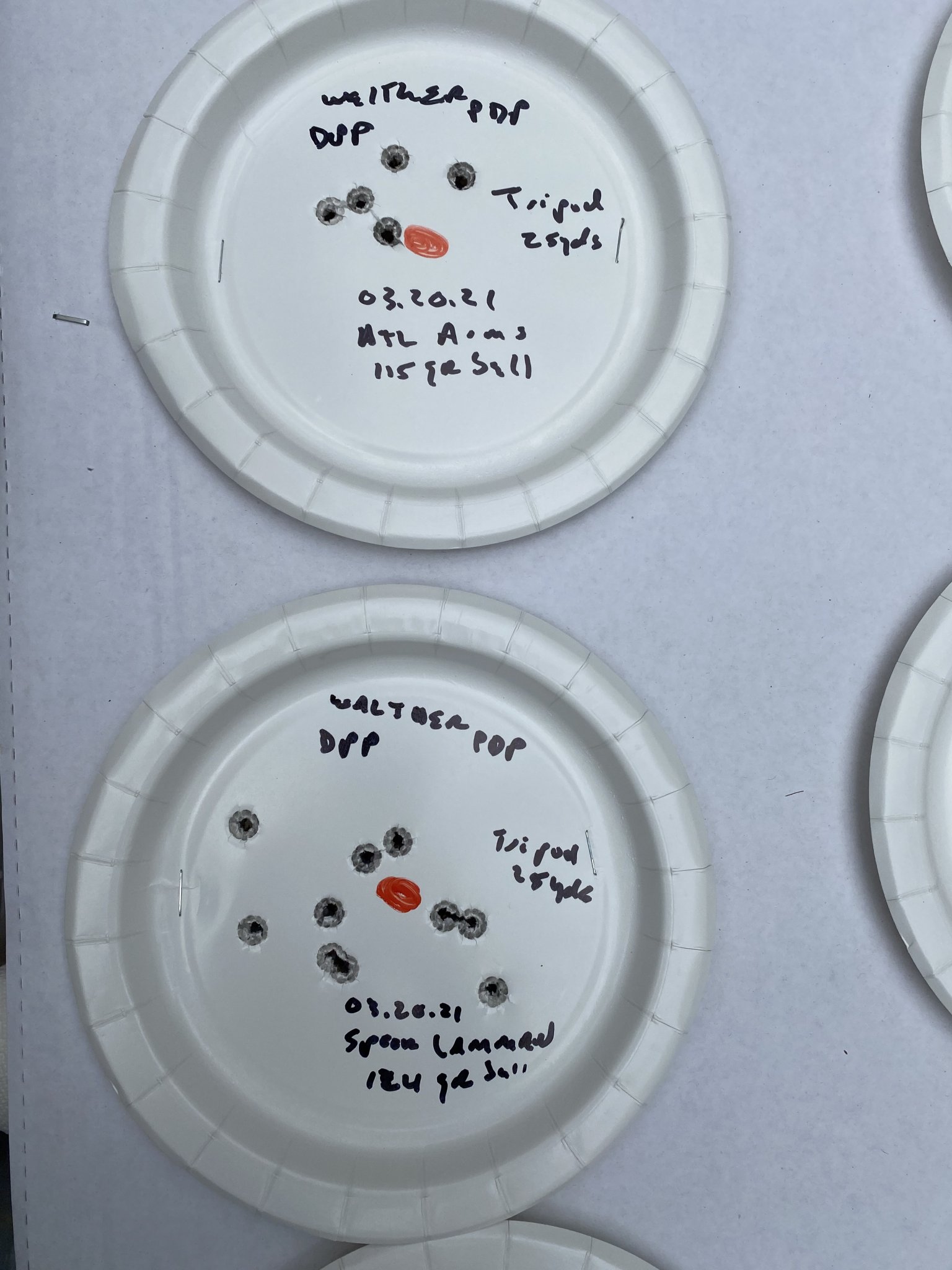

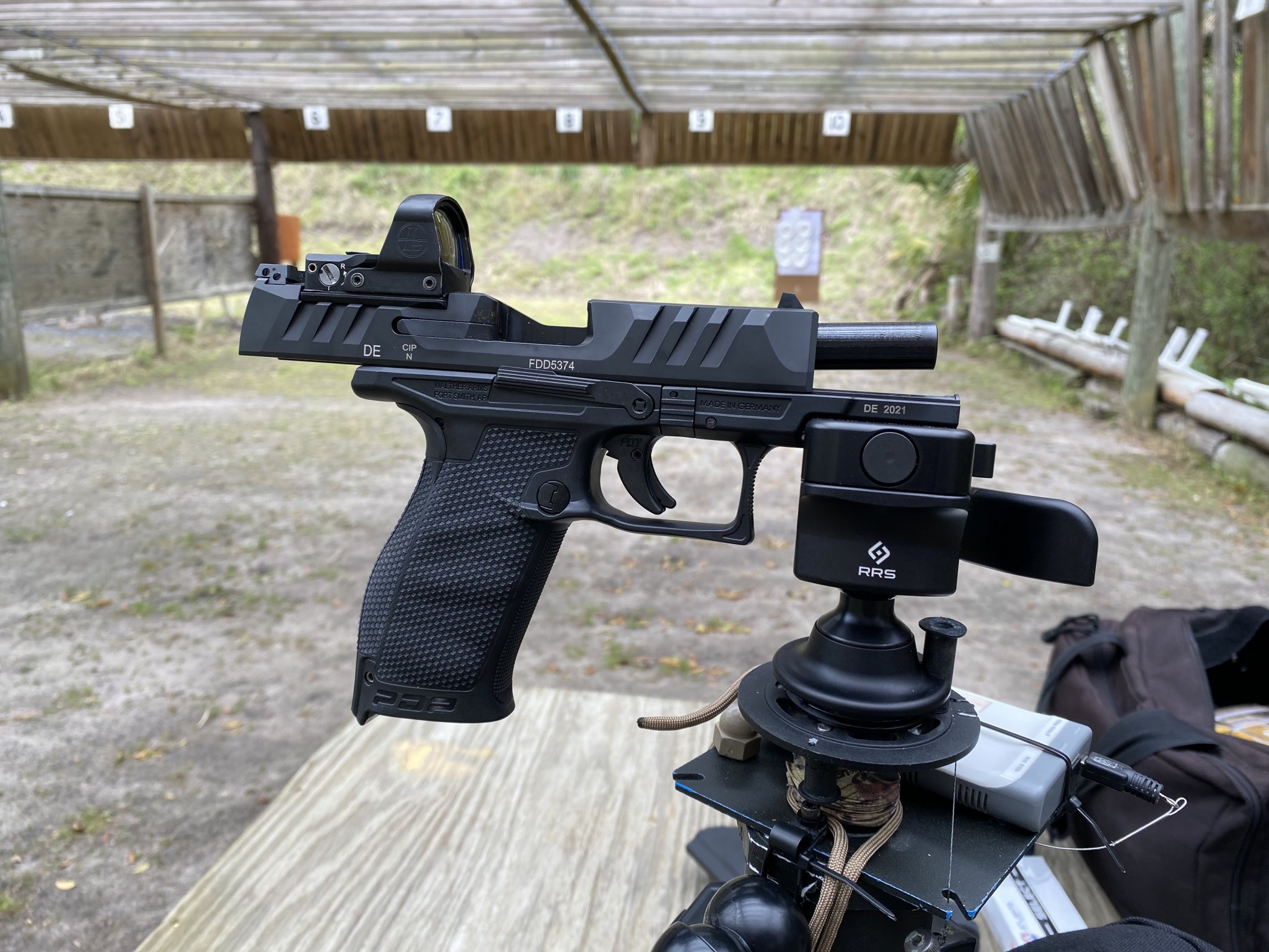

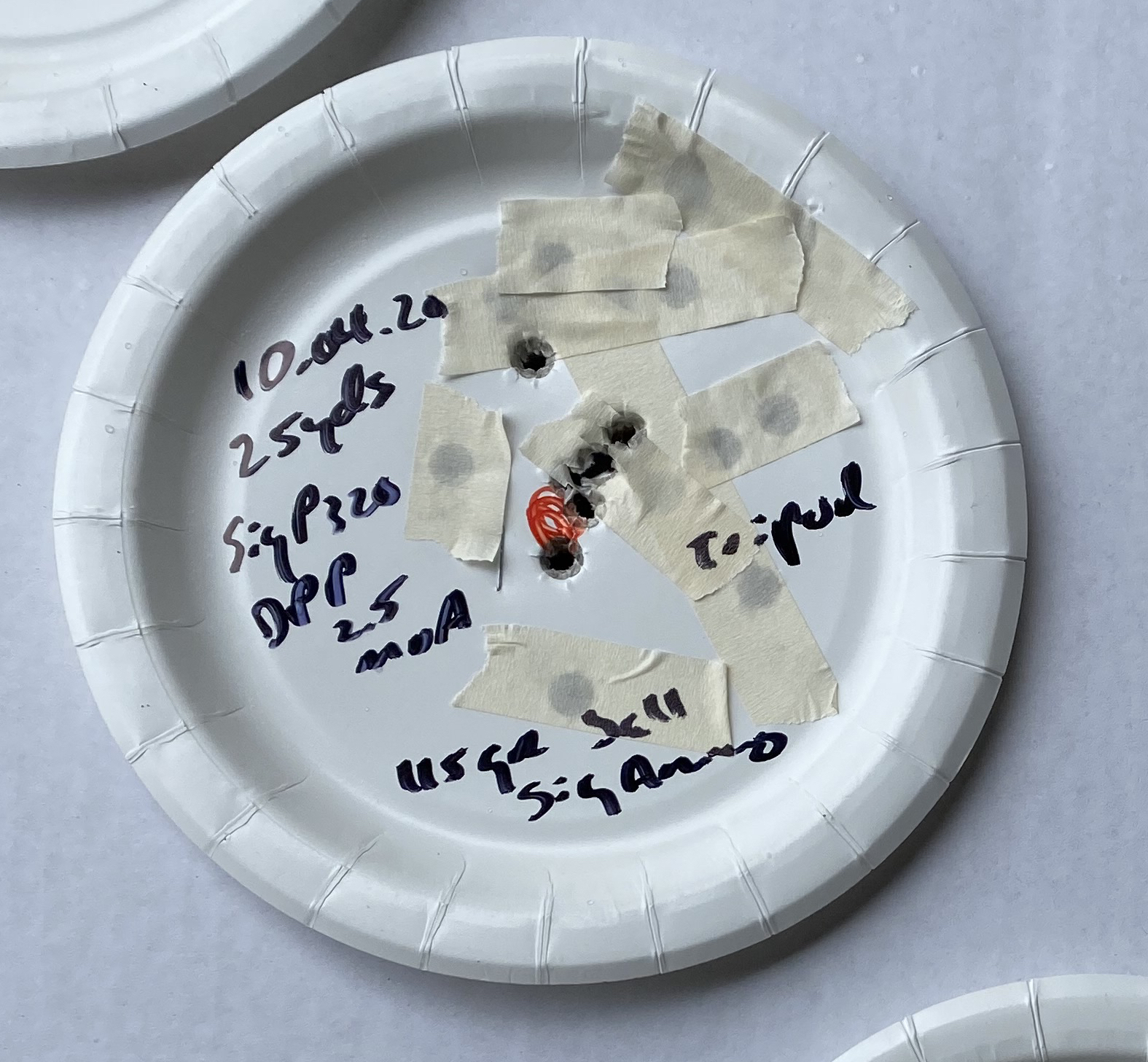

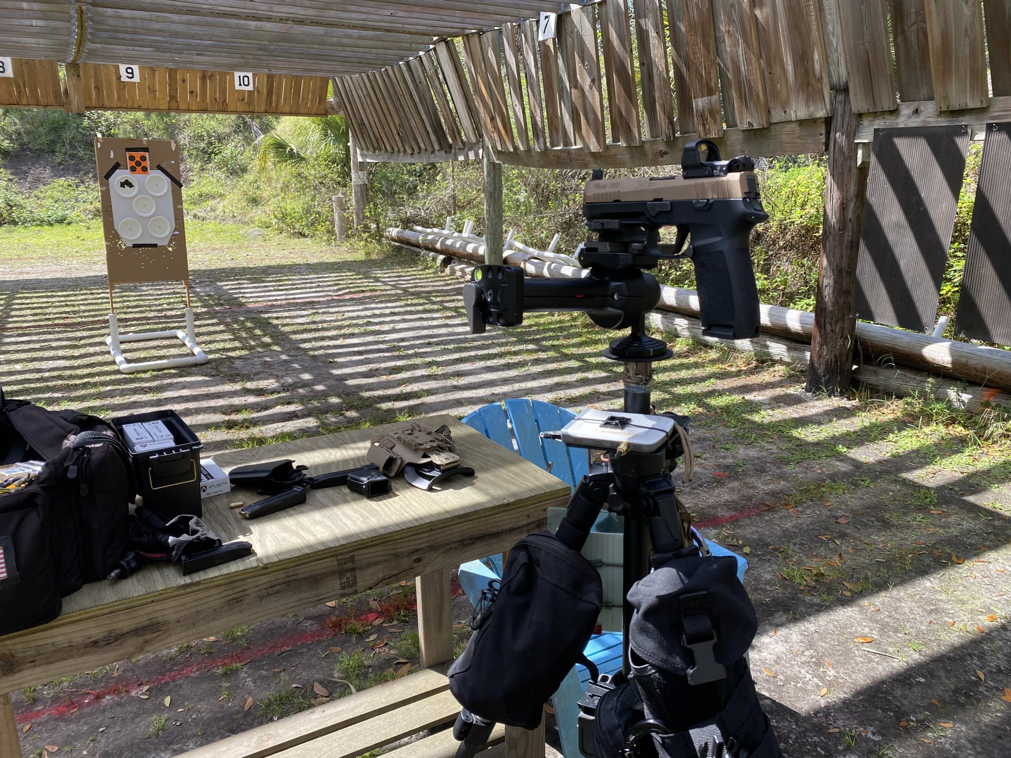

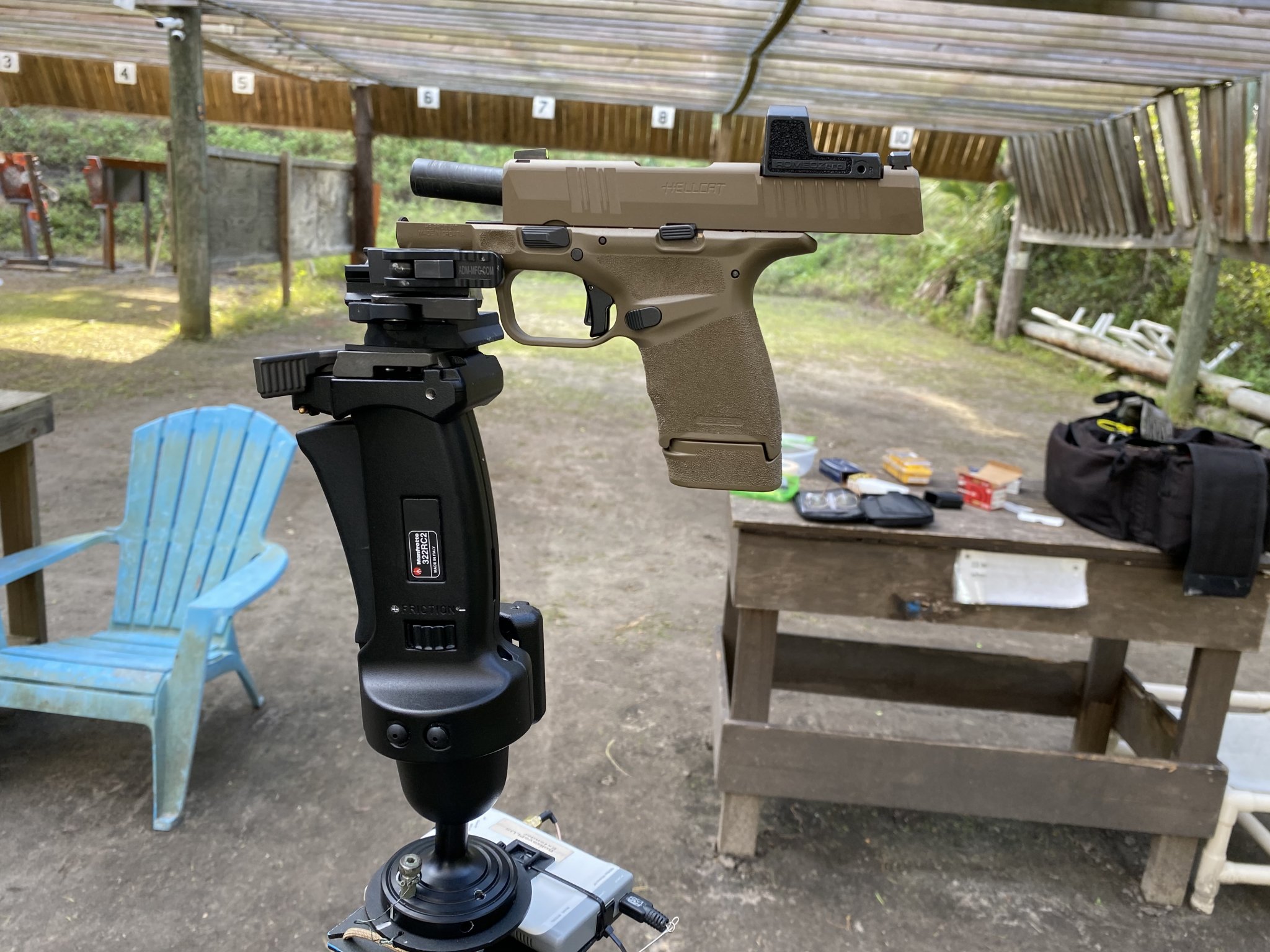

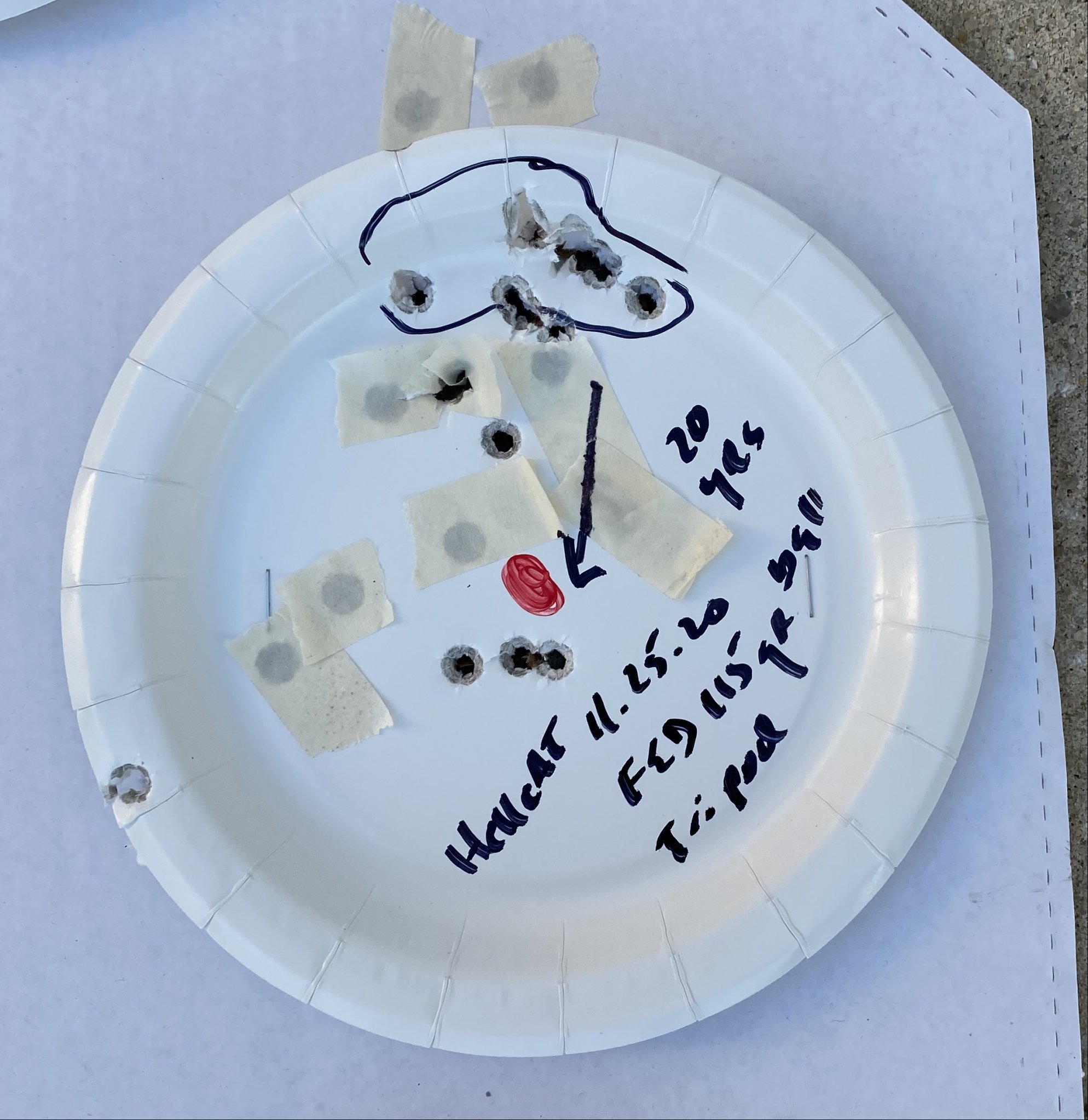

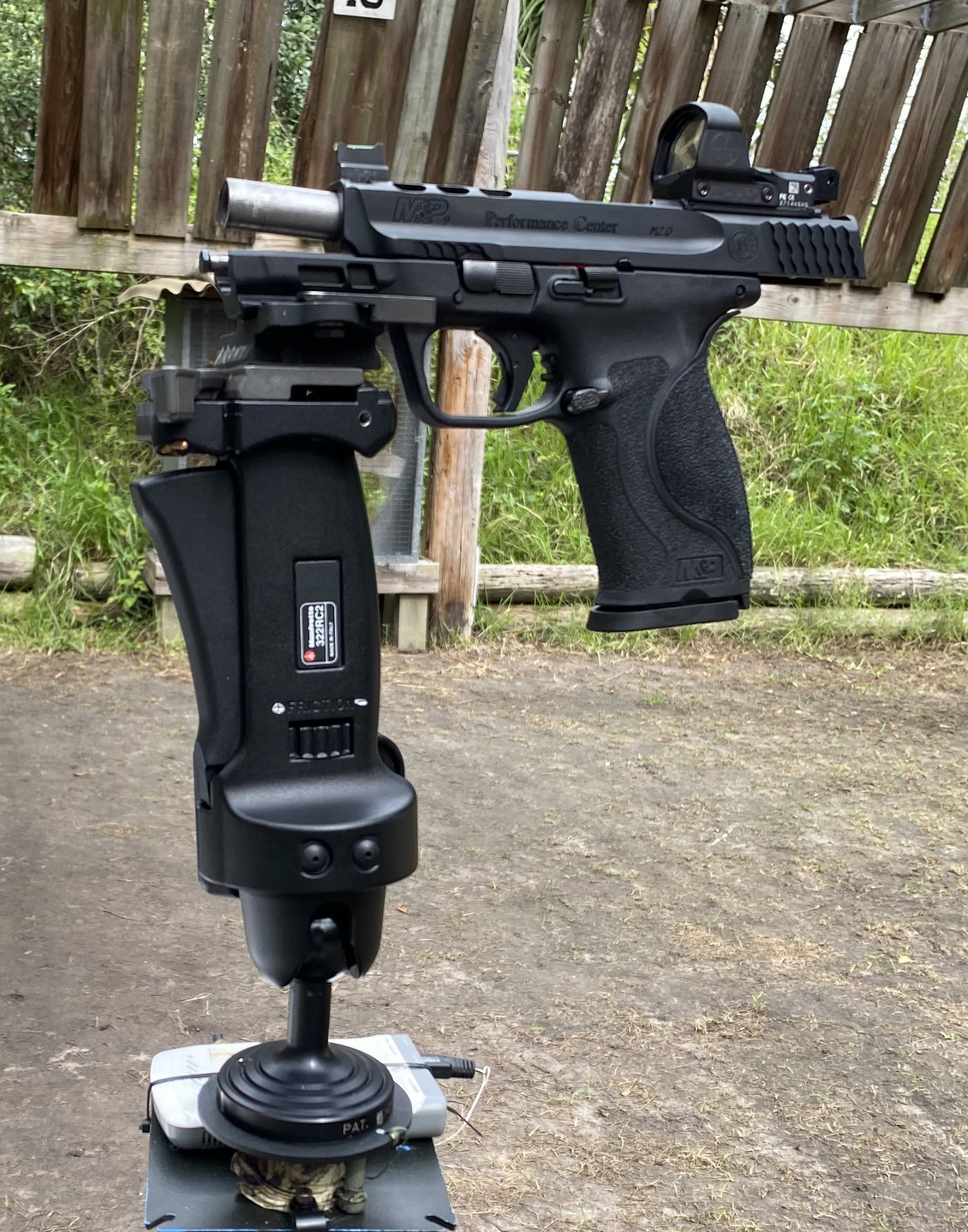

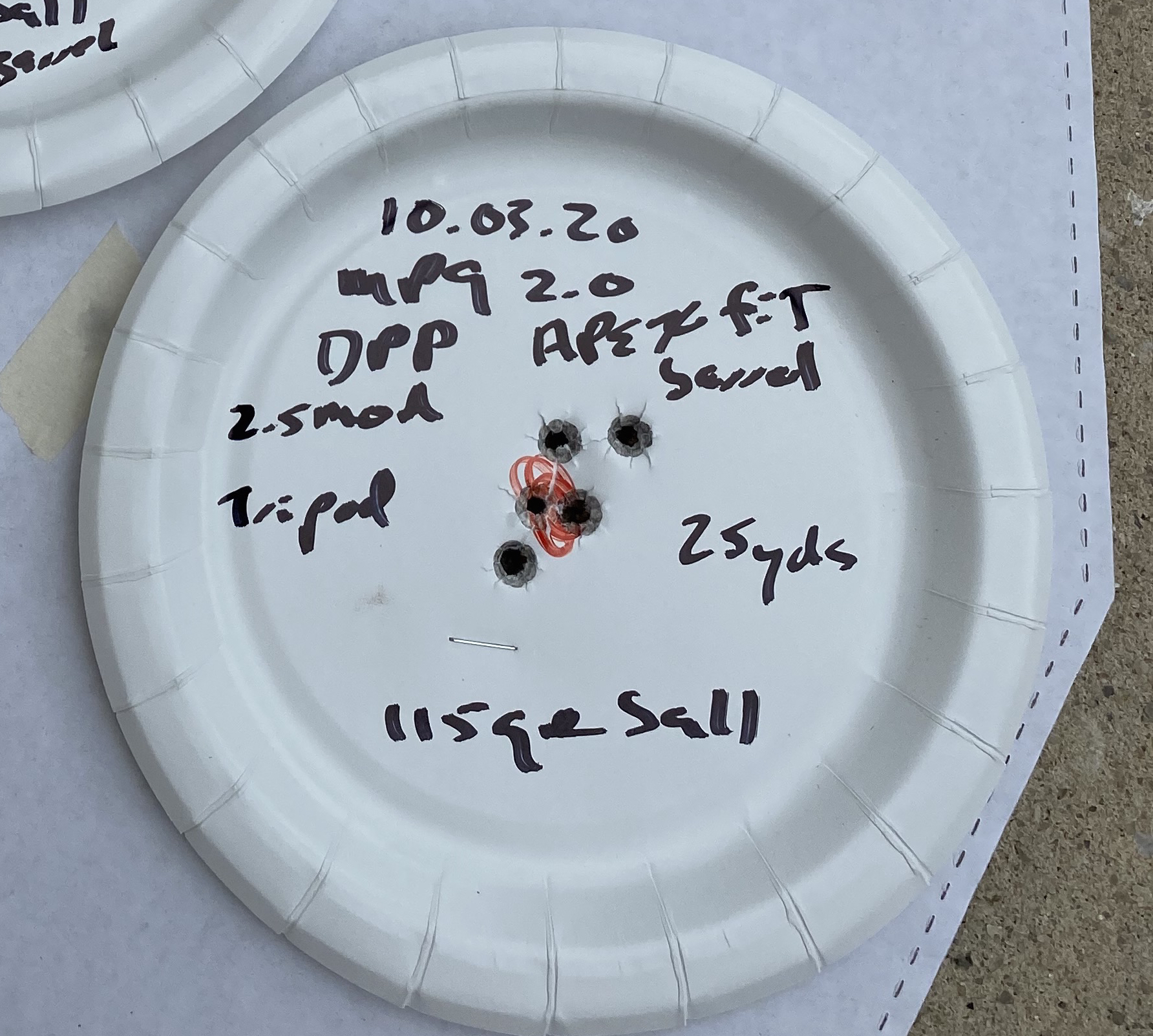

    I like to use a tripod to zero pistol red dot optics for best accuracy in my hands , so I have been intellectually scheming to self, how I could efficiently acquire muzzle velocity data contemporaneously with the zeroing process. I have used a variety of tripod interfaces for the pistols, Manfrotto and more recently RRS Anvil-30 mount.
    Leupold Delta Point Pro #2 FOP Range Zero with Tripod Picattiny Mount 03.08.20IMG_5012 copy.jpg
    Leupold Delta Point Pro #2 FOP Range Zero 25 Yards Tripod 10.04.20IMG_6643 copy.jpg
    Smith & Wesson M&P9 2.0  Apex Fit Barrel Leupold DeltaPoint Pro Target Zero 25 Yards v. Sig P3...jpg
    IMG_8623Walther PDP 2nd Range Seesion Variety Ammo RRS Anvil-30 Adapter 2  03.20.21 copy.jpg
    IMG_8625Walther PDP 2nd Range Seesion Variety Ammo RRS Anvil-30 Adapter 2  03.20.21 copy.jpg
    Springfield Armory Hellcat  Apex Trigger QD Mount Romeo Zero Sight In 11.25.20IMG_6994 copy.jpg
    Springfield Armory Hellcat  Apex Trigger QD Mount Romeo Zero Sight In 11.25.20IMG_7001 copy.jpg

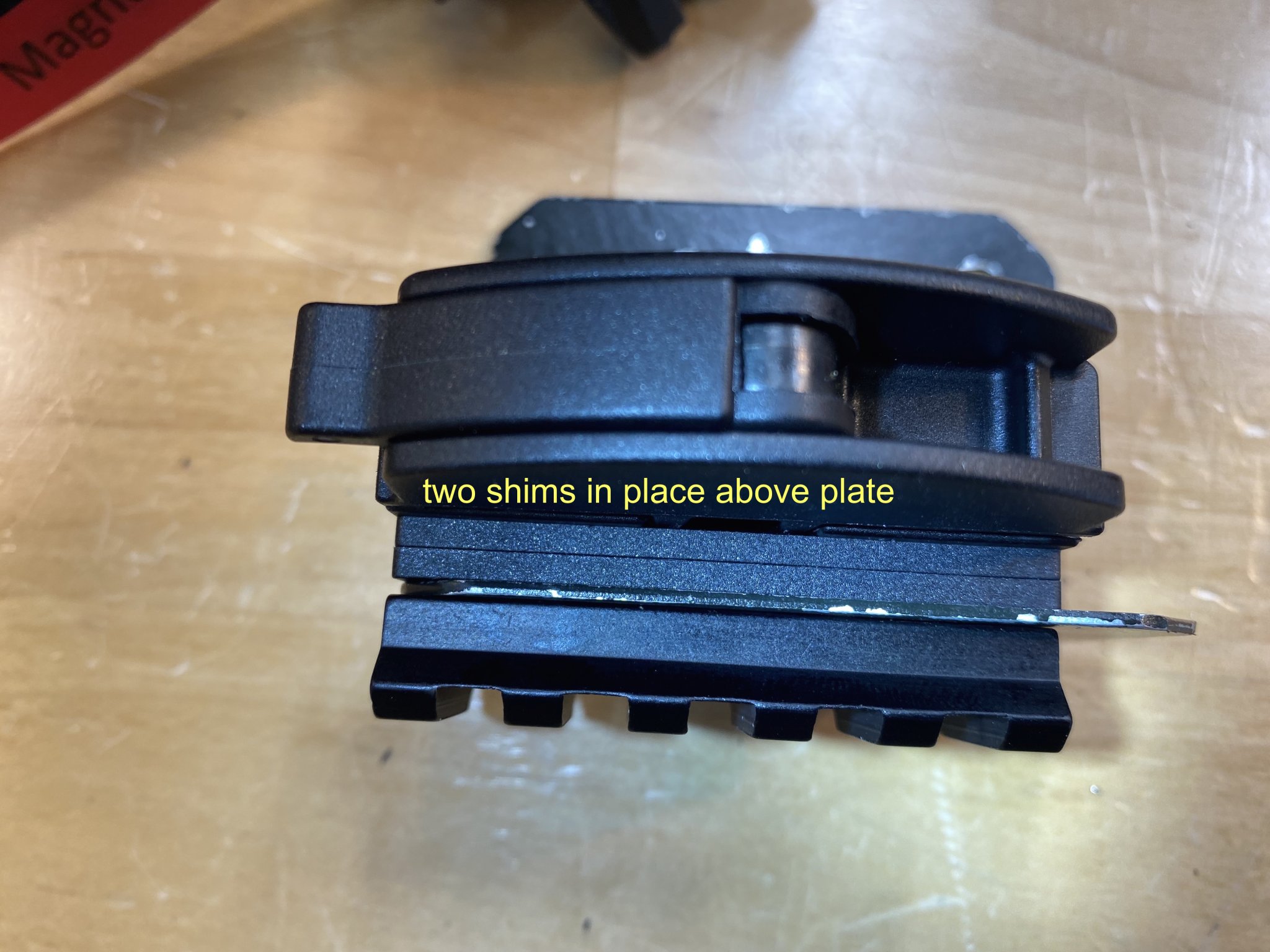

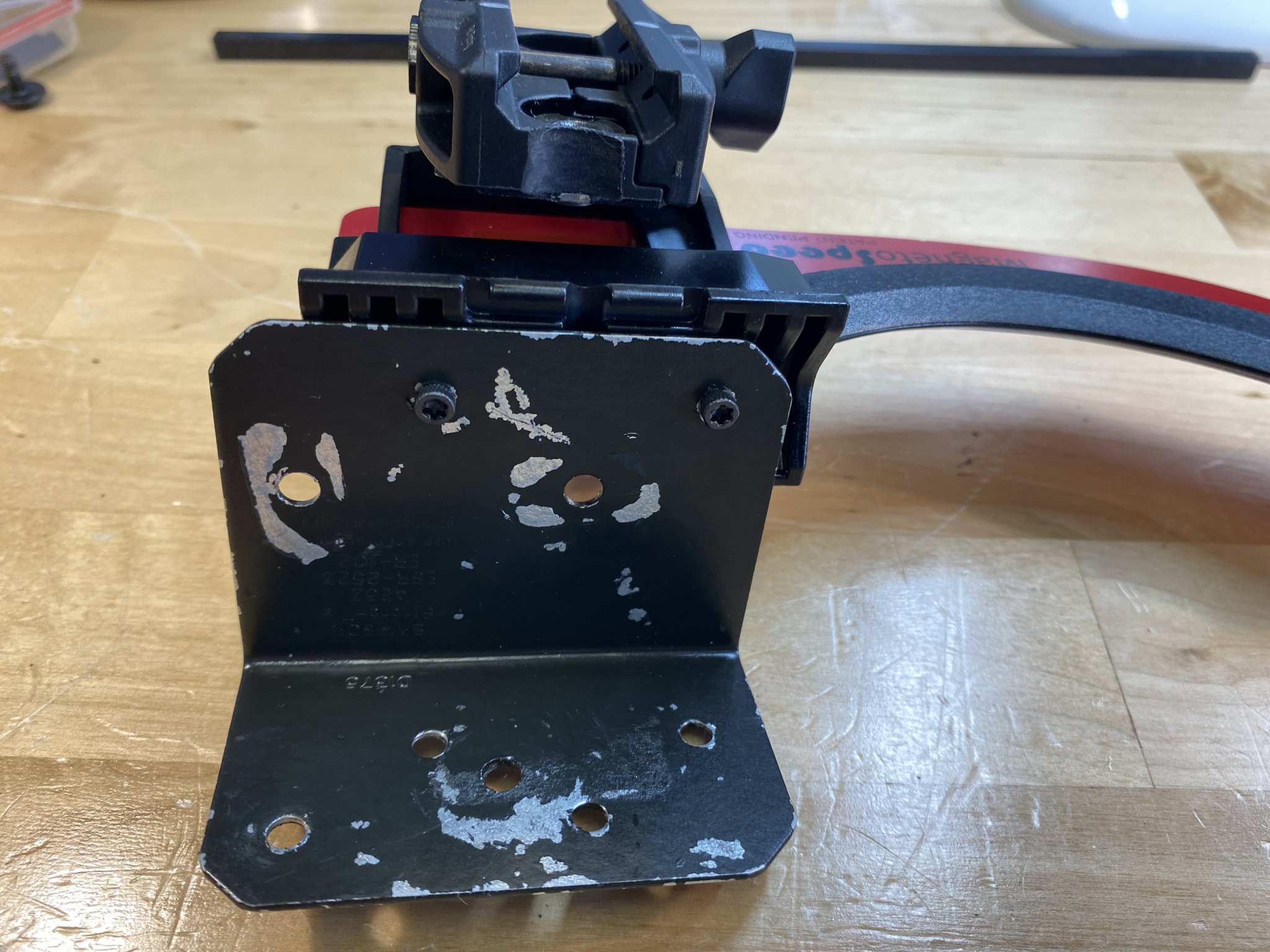

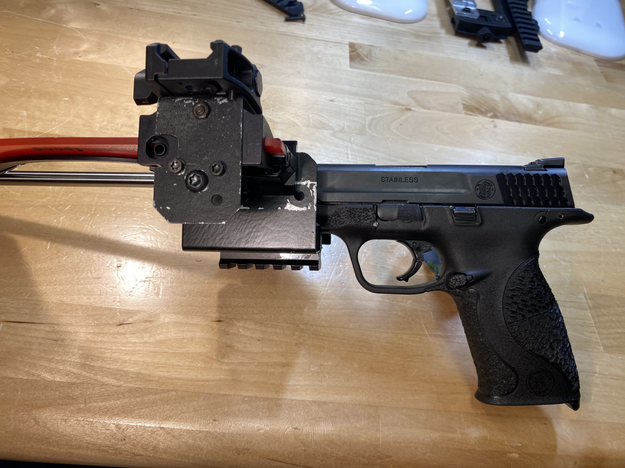

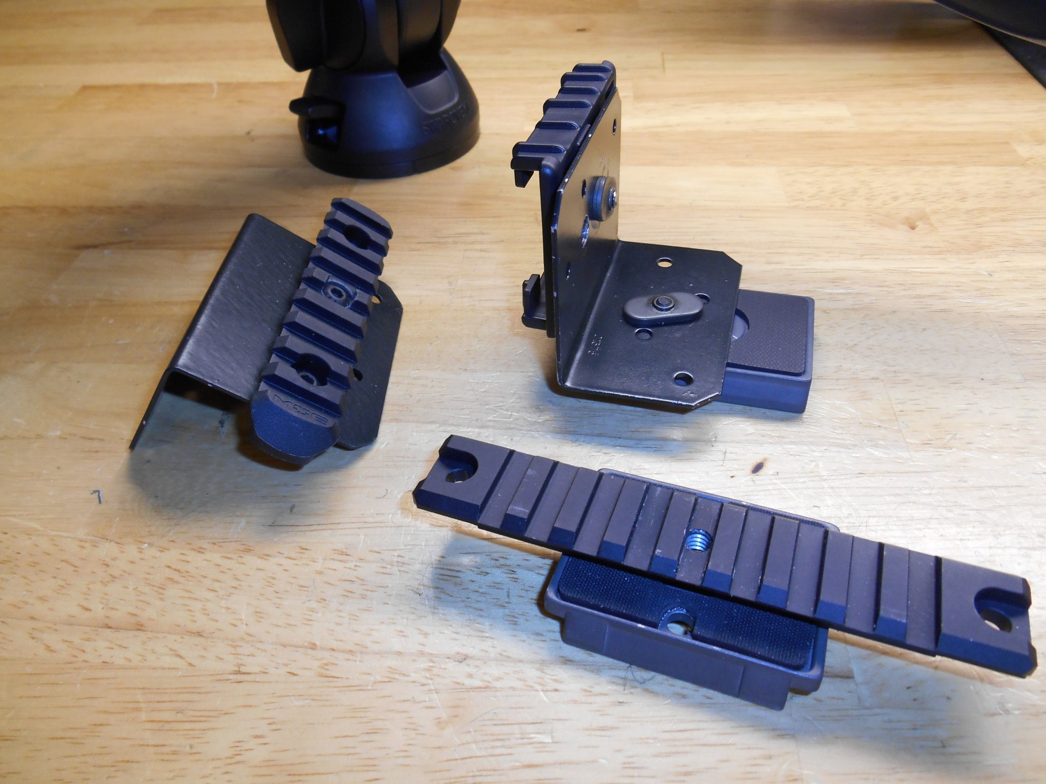

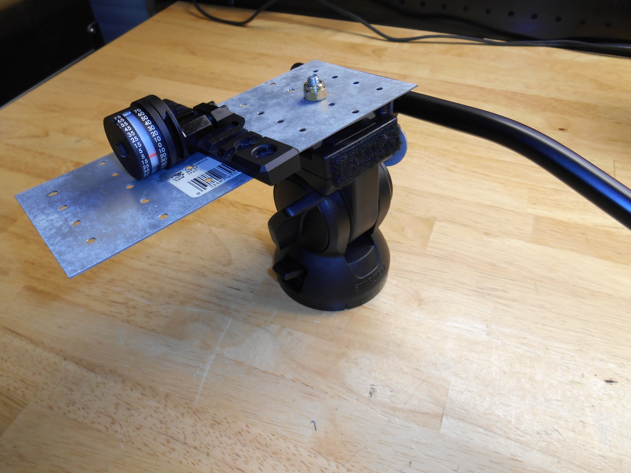

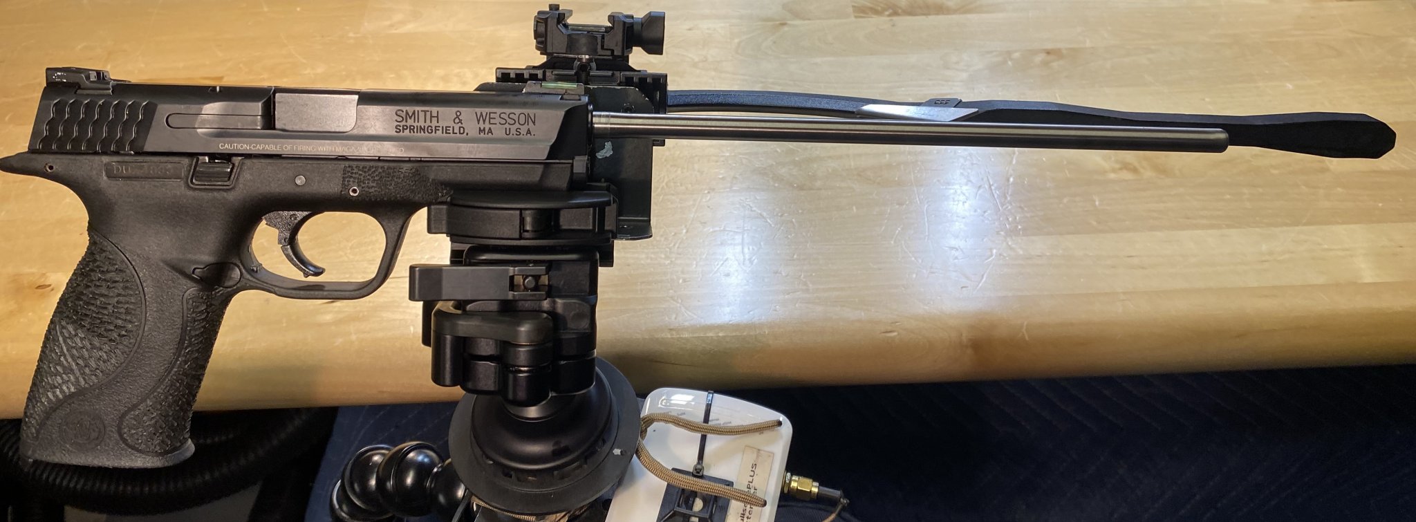

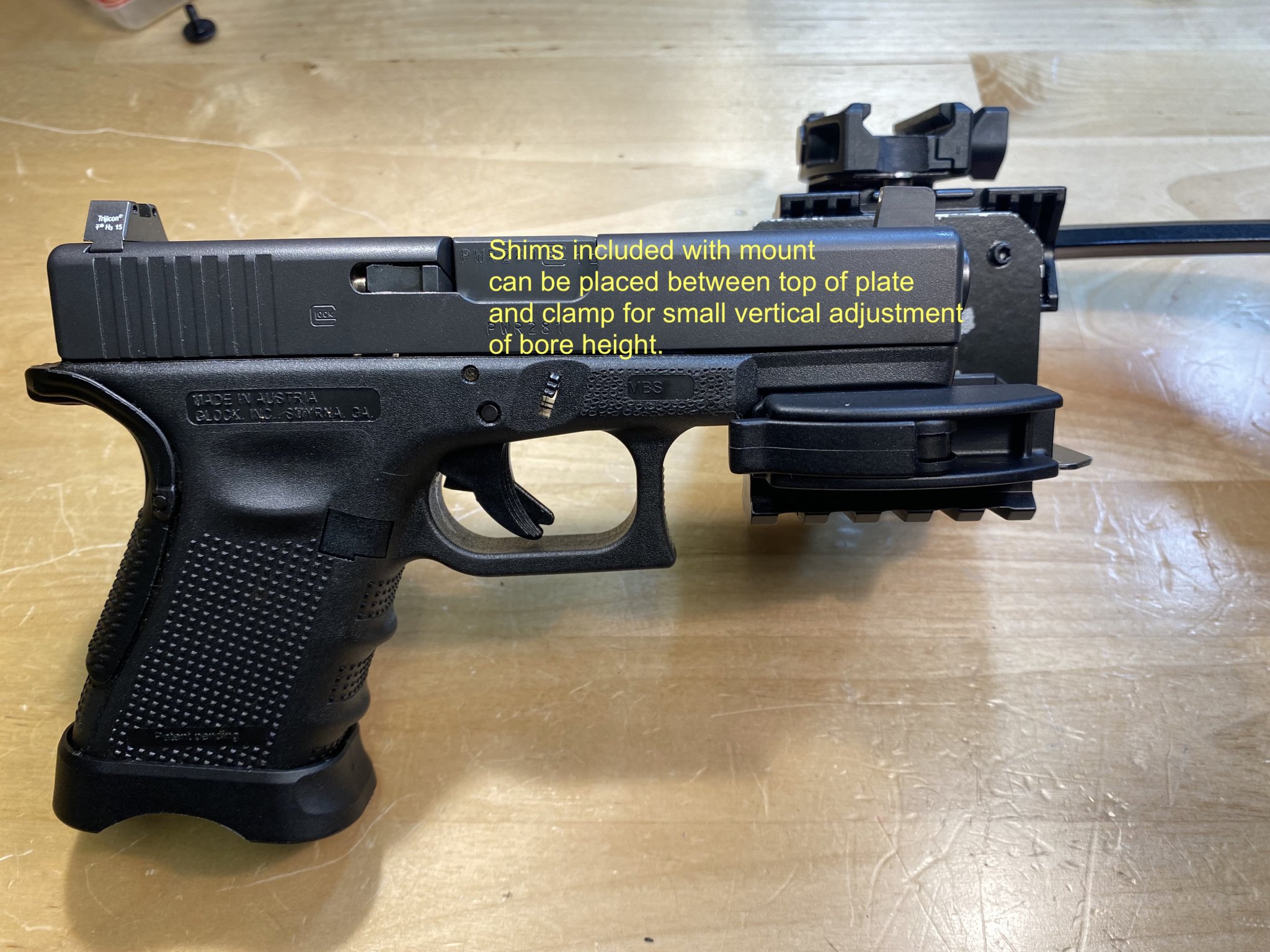

    I have used construction galvanized steel thin plates, straight and angled, for a lot of mounting options of devices to tripods etc.; extremely
    light and strong that can be drilled to fit various device fastener mounting points; of course paint to desired applications.

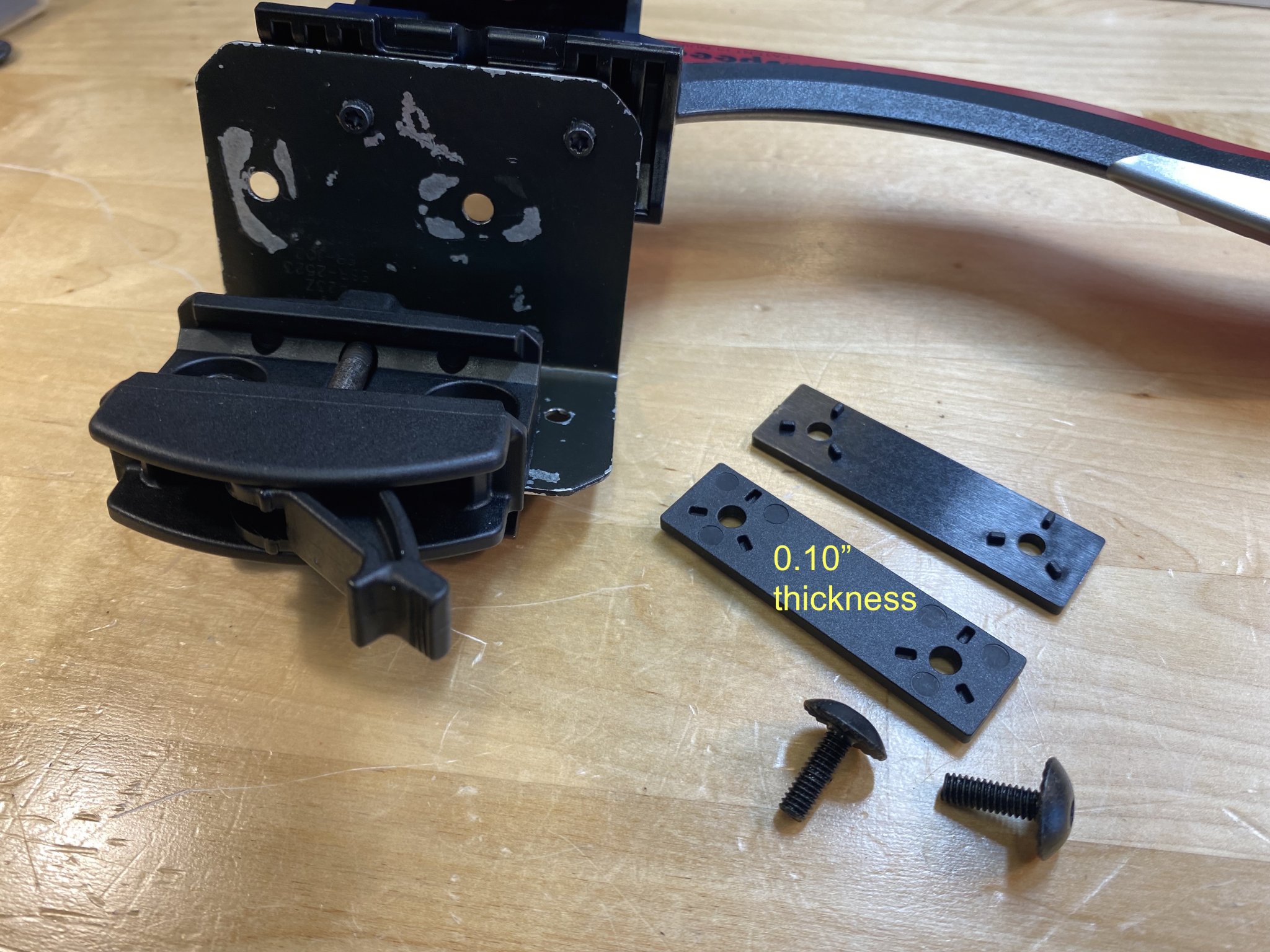

    So this is version 1.0 that I have been using. Simplicity in cost (mounting plates 49 cents each @ home depot), a re-purposed Rogers optic mounting clamp ($25) and 4-40 fasteners; done. It allows for rigidly connecting the firearm (regular picatinny rail, fussy single dust cover mount location slots (Hk, Glock, Springfield Hellcat, etc) with an adjustable clamping tension screw so you can securely hold polymer frames without compressing them to the point of impairing normal cycling actions; the center-to-center MagnetoSpeed V-block threaded inserts are exactly the same as the Rogers picatinny rail!; best of all, the bottom of the configuration allows direct attachment to your
    favorite tripod clamping system. The Rogers mount also has two 0.1" thick shims to fine tune the bore height relative to the sensor deck on the MagnetSpeed.

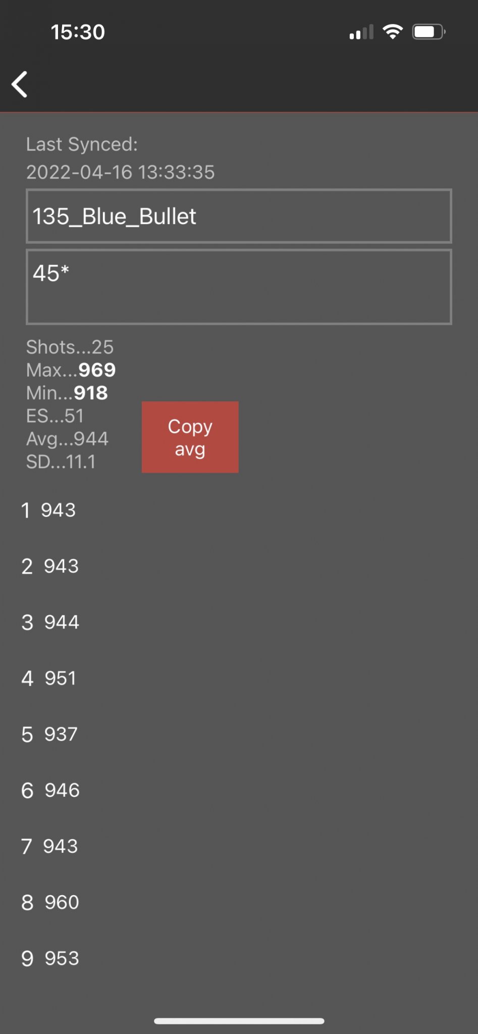

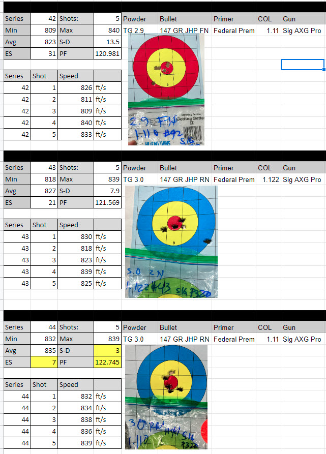

    Hi guys, what's the ideal sensitivity setting for a pistol ? I am getting readings but not sure how accurate they are. Attaching it to my Sig P320 AXG Pro
    Did the Magnetospeed read all of the shots?
    We're the velocities consistent with each-other, or did you see a large ES?
    We're the velocities in the range they should be for the ammo are you using?
    #1 Yes
    #2 Yes on consistency, ES were ok
    #3 I have no idea
    I've been trying to get good sub load for my AXg pro to meet minimum PF.
    I did not chrono the 3.2 TG / 147 grn FP but that felt perfect for steel targets in USPSA competition. That's my next assignemnt.
    I guess I should Chrono factory loaded ammo as a baseline to see if my settings are correct ?
    Here is what I got on my last session

    #1 Yes
    #3 I have no idea

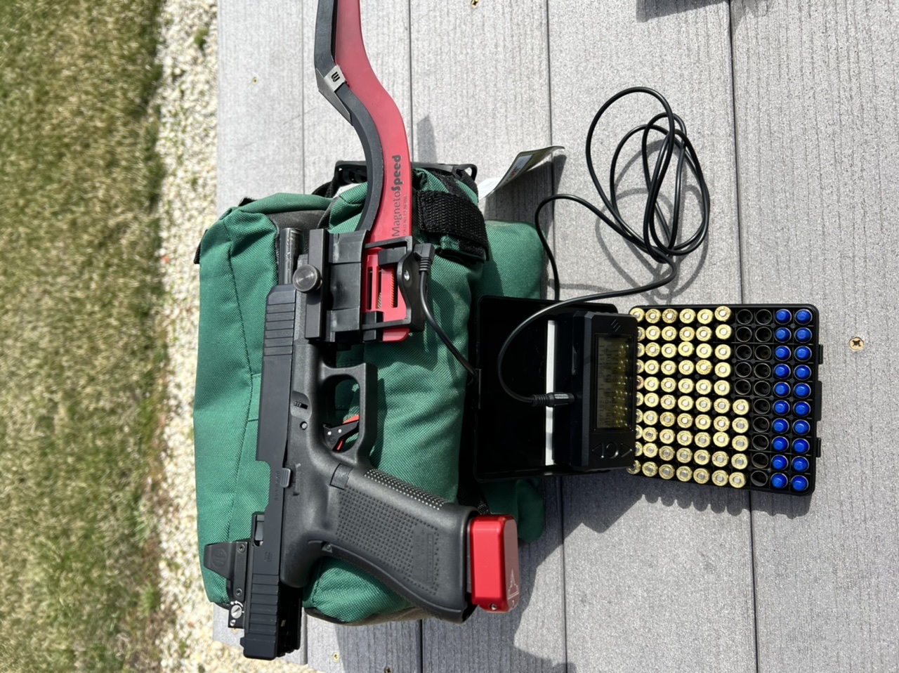

    I'm sure your getting good data from the Magnetospeed as long as the ES and consistency is good. Try the factory ammo you like or have to confirm.
    I personally couldn't get anything consistent with my Magnetospeed. It'd either give me an error or wildly inconsistent readings with an occasional string of what seems plausible readings. I wish they'd come out with a pistol-specific bayonet. I had more issues with P+ factory loads, more success with my hand loads for whatever reason.
