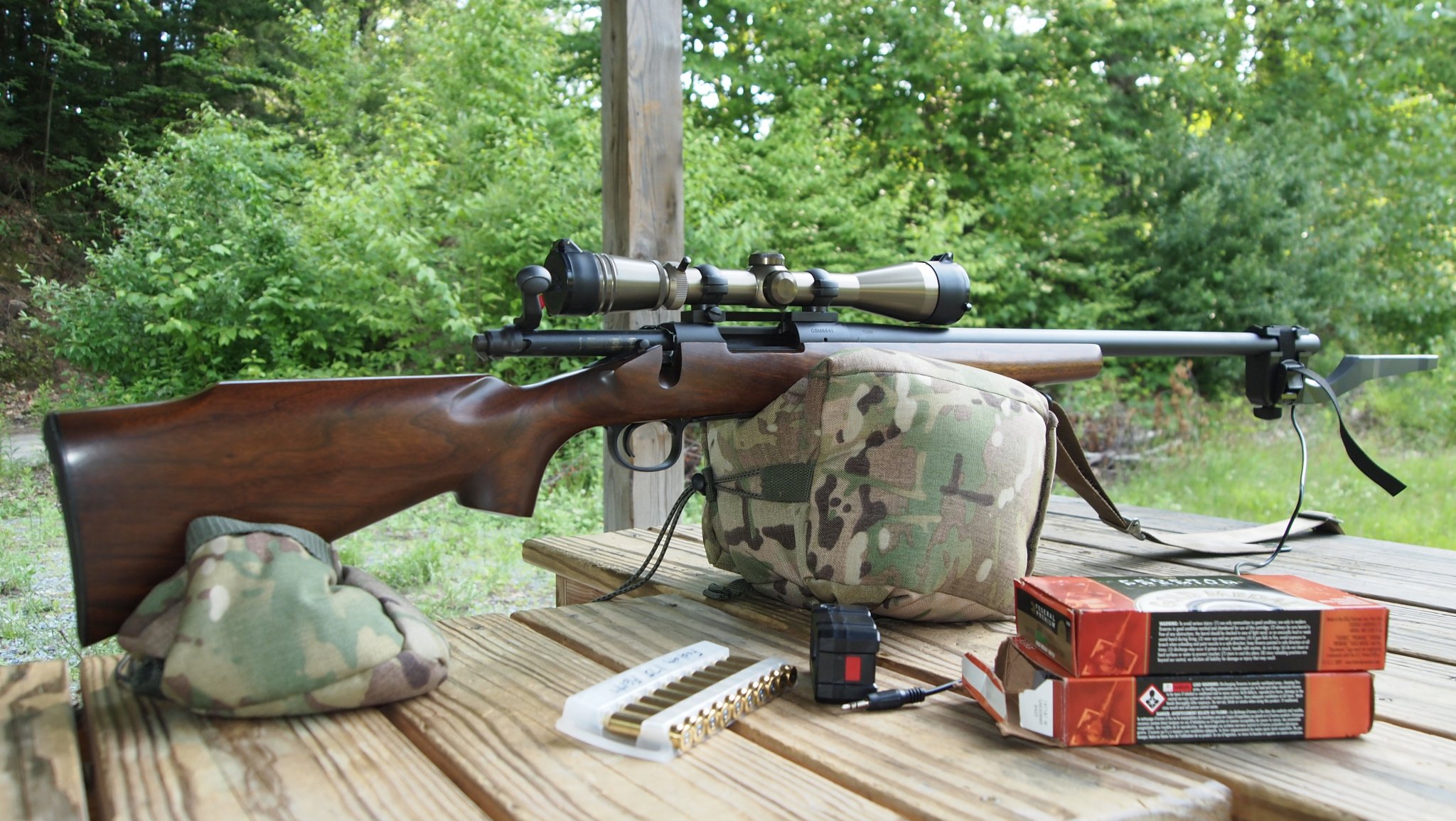

I'm with you, run my sporter with the rubber block removed on an Ultra 7. I've got the MFR app and the gizmo you plug into your iPhone and the data recorder, email The results to myself and keep it all on a spreadsheet.
Really wanted a LabRadar but ended up buying a Sporter off the PX here for a good price.
Having fun with it...
