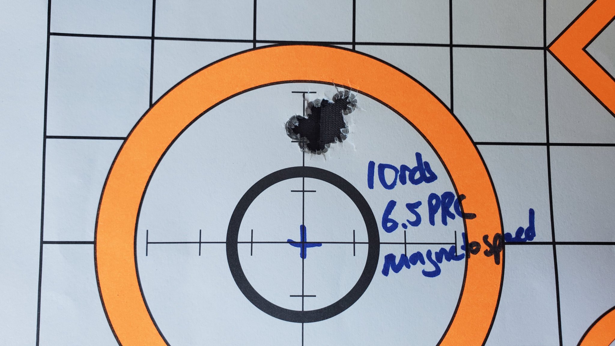

I see a poi shift with magneto speed, but I've never had a problem with it affecting accuracy. I do load work ups with it on.
