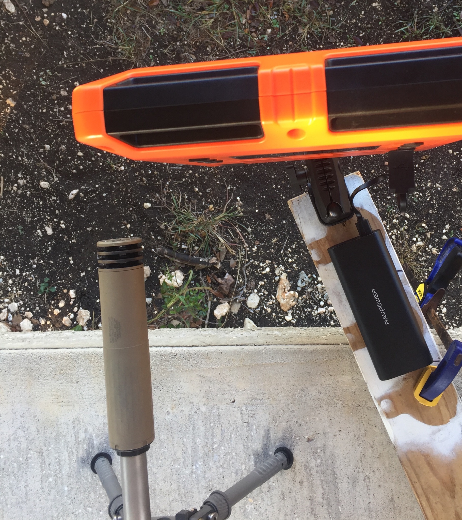

Finally got to use my new Labradar this weekend and was disappointed. Consistently missed reading shots from my 6.5 creedmoor rifle with SiCo Omega suppressor. It would only read when the Omega's brake was right next to the unit <6" away at it's highest sensitivity level. It was also detecting another fellow shooter's bullet who was 2 benches away (He had a muzzle brake). If I turned down the sensitivity to not-detect his muzzle blast it wouldn't detect mine. Needless to say the right side of my new Labradar is all blackened. Out of 30 shots my Labradar detected 19. Going to tinker with it again next time it's above 40°. Kind of miss my trusty Caldwell Chrono.
Stick the LabRadar a bit in front of the can. Can limits the blast so put the radar where the blast is most.
Try one of these.
Reactions: earthquake
Which power bank port i use to connect it to Labradar?
I have 2 port on my power bank 2.1V and 1.0V?
10 000mah power capacity.
If they are USB, they are both 5 V, but one is 2.1 A and the other is 1 A. I would probably use the higher one, but they claim it draws 800 mA max so it theoretically shouldn’t matter.
