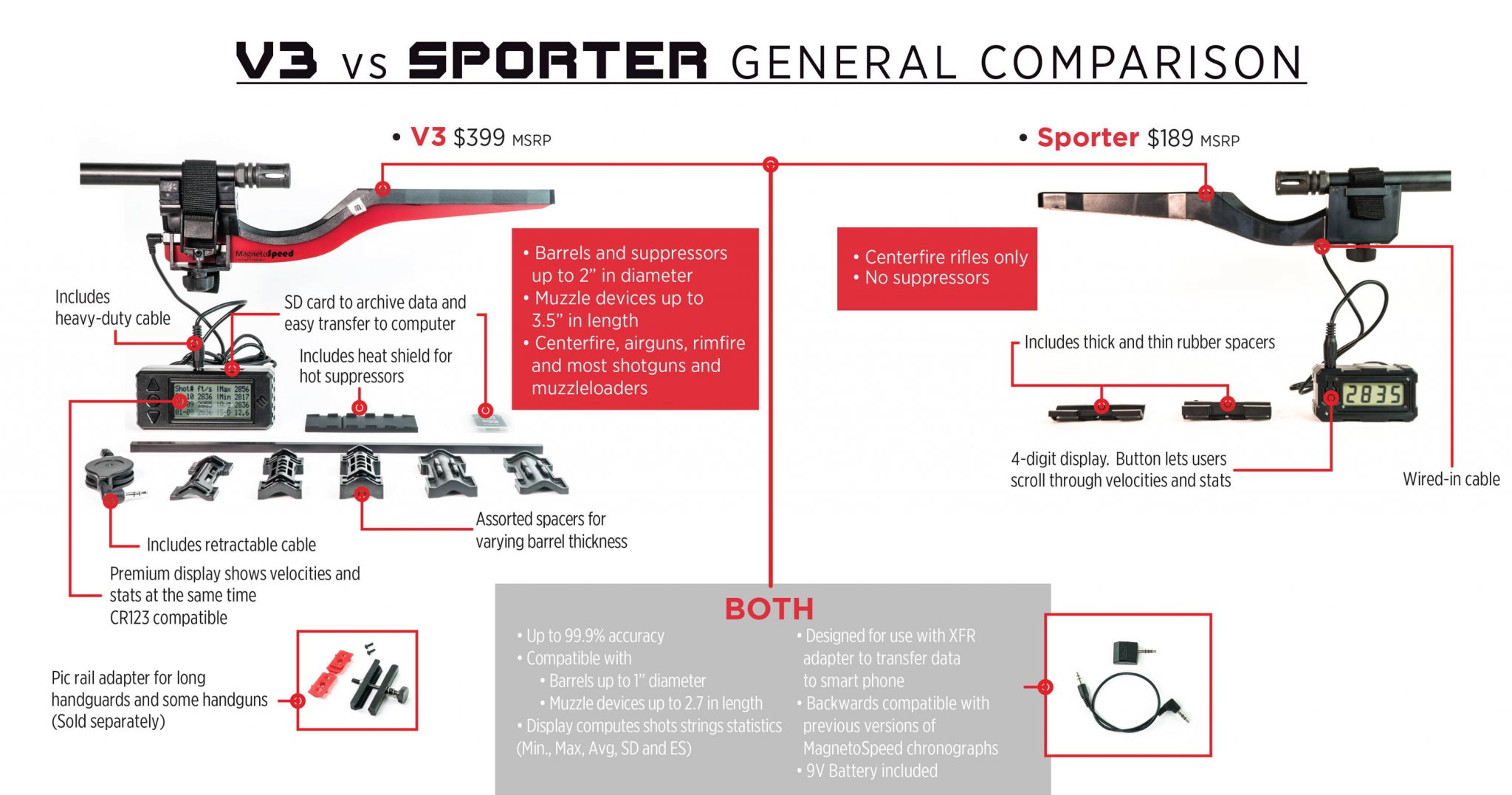

If you never plan to shoot suppressed or with large brakes the sporter will be just fine. The V3s biggest appeal is better/easier mounting options. They make a pic rail adapter for it that I use with some of my ARs with long handguards. Zero POI shift or group alterations with it. FYI I have found that on most of my bolt guns (MS strapped to the barrel) my groups actually get noticeably better with it on. POI does shift a few inches though.
Reactions: Who?Me?
I do better with graphics: this is straight from the MS website.
Referring to the differences between the V3 and the Sporter

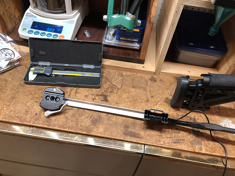

I did get a MKM mount for it to get it off the barrel.

sadly I cannot find the link someone else posted about that rod that moves the magneto speed off the barrel
