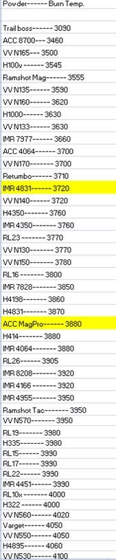

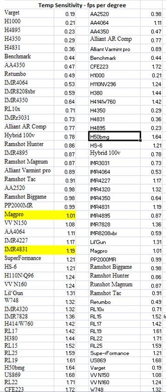

Just a head up as you'll find your results with MagPro different from the IMR-4831, though MagPro's burn rate is close to IMR-4831, MagPro burns significantly hotter (see charts below), which also effects your internal ballistics. You'll be using much more MagPro to get your MV than you did with IMR-4831.
I've been using MagPro lately for my 6.5 PRC since I haven't been able to get the Retumbo I like. It does OK for me.
Reactions: 338dude and XP1K
View attachment 7810364 View attachment 7810365

for all the 300 wm I load for imr-4350 works great with 168 & 210 bergers. as we have seen in my neck of the woods if gun wont shoot bergers it is out the door and no looking back!
I tried Magpro on my brother's 7mm RM because I had a new 8lb keg, which I bought at normal prices during the height of the COVID shortage.
ES and SD weren't good at all until I got right up on book max, then they tightened up to ES in the high teens and single-digit SD.
Accuracy was acceptable.
I have not tried it in temp extremes, but I'm assuming that it would be more sensitive than a lot of other powders.
