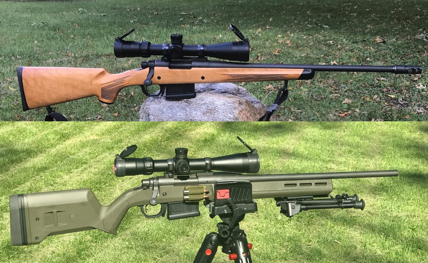

I tried something with the MagPul mags that didn't work out too well. I have a Remington 700 in .243, and I wanted a DBM system for it. Dropped it into a MagPul Hunter stock, and it feeds like it was made for it with the 3 mags I have. Then I decided that it was really the bottom metal and mags, I was after, so I took the original stock, a mag, and the bottom metal (plastic) to my gunsmith, and had him inlet it a bit for it. I was so happy. Fed perfectly. Well, Once home, I ran into that "tuning" problem you guys with the high dollar chassis systems talk about. The magazine I gave him fed perfectly, but my other 2 drug on the bolt. Seems they set too high in there, so it went back in the hunter stock where it feeds smooth as butter from all 3...
If I can get it figured out, I'd like to put the .243 back in the maple stock, but with all 3 mags not dragging on the bolt. I have a SPS Tactical in .223 I'd like to drop in the Hunter stock, but then that will require metal mags (or possibly the MDT ones) seeing as how MagPul saw fit not to develop a .223 version... I really love the feel of the Hogue stock, but the fore end just isn't all that solid.
