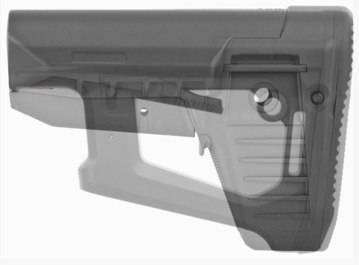

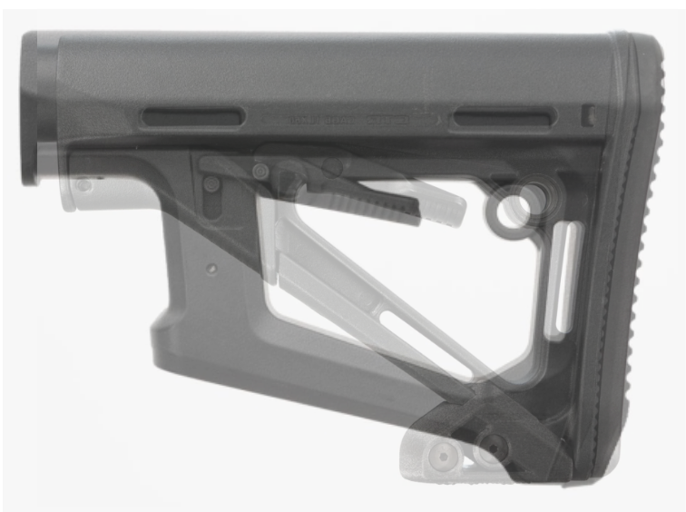

The sloped bag rider was one of the bigger selling points for me on this stock because it allows the bag more room to be slid back and forth to make micro adjustments for elevation. I just ran into an issue recently with the BCM stock where I couldn't quite get the perfect elevation so I was stuck between trying to crush the rear bag and/or adjust the bipod legs, and I made it work but it was frustrating.
I made a pretty close to scale overlay to show how much more room you have to manipulate the bag compared to the BCM and a CTR with a Subrevtec bag rider.
