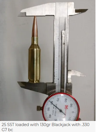

    Since when is a true short action 2.860? 2.955 give or take in any custom action.
    Only poor (or the very very fortunate) people use R700s
    My point was the SST's were designed to run 3300 @ 2.860 with some room to grow COAL as more .25 pills become available. Unlike the std SAUM's that are more mag restricted in a short action with the high BC pills.
    There's another thread on here somewhere with a very similar new cartridge .257 Blackjack
    My SST is in an ARC Nucleus 1.1 SA. The ARC mags allow 2.955 as you stated.
    Pic clipped from Sherman web sight.
