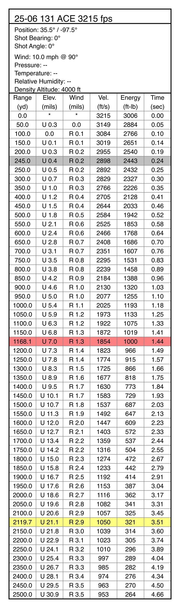

While it may not be a popular thing to do, a 25-06 host could shoot both 3040 and 3215 fps for a rifle that can make all of those competitions listed and do quite well in each, with its strengths actually being in the ELR and longer range matches.
Utilize 4831SC for the slower nodes and lower recoil type matches and then use H1000, Retumbo or RL26 for the ELR matches.
The recoil will be on the higher side of the PRS stuff but at 3040 it won't be too bad and on the other side of the coin you would get to enjoy the lowest recoiling rifle in the entire match in the NF ELR format matches out to 2000 yards while suffering to hit % loss except the few targets beyond a mile or more.
At NF ELR we makeup about 4-5% of the field population and end up with 15-20% of the top 20-25 and have taken home steel the both years we've brought rifles running the 131 ACE at 3200-3350 fps. Logan and I rarely shoot, so in the right hands this setup would do a lot more.
Ballistic ARC may be off a tenth or two for ELR work but it's easy to export dope cards.

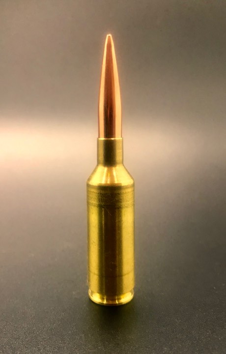

The 257 Blackjack cartridge (60.0 gr H2O) which will be released with fully commercial, ready to load brass in Q1 2021 will achieve this 3200-3215 fps design goal in a SA format and was designed for the crossover shooter who wants to shoot some of the cooler, longer matches and also utilize this low recoil platform for LRH too. 257 BJ can be loaded down to 2970-3040 as well if a guy wants to run slow for recoil considerations.
