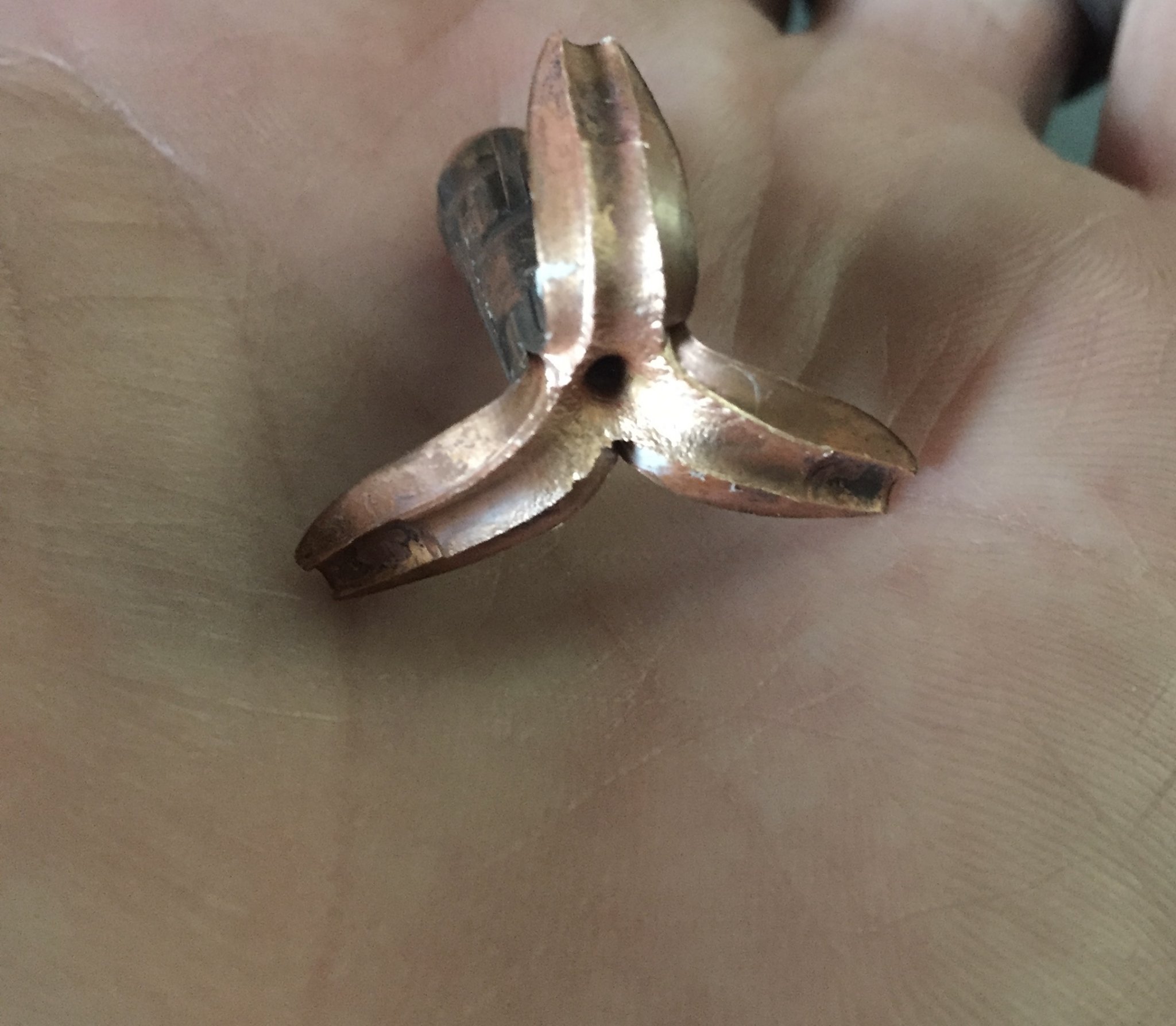

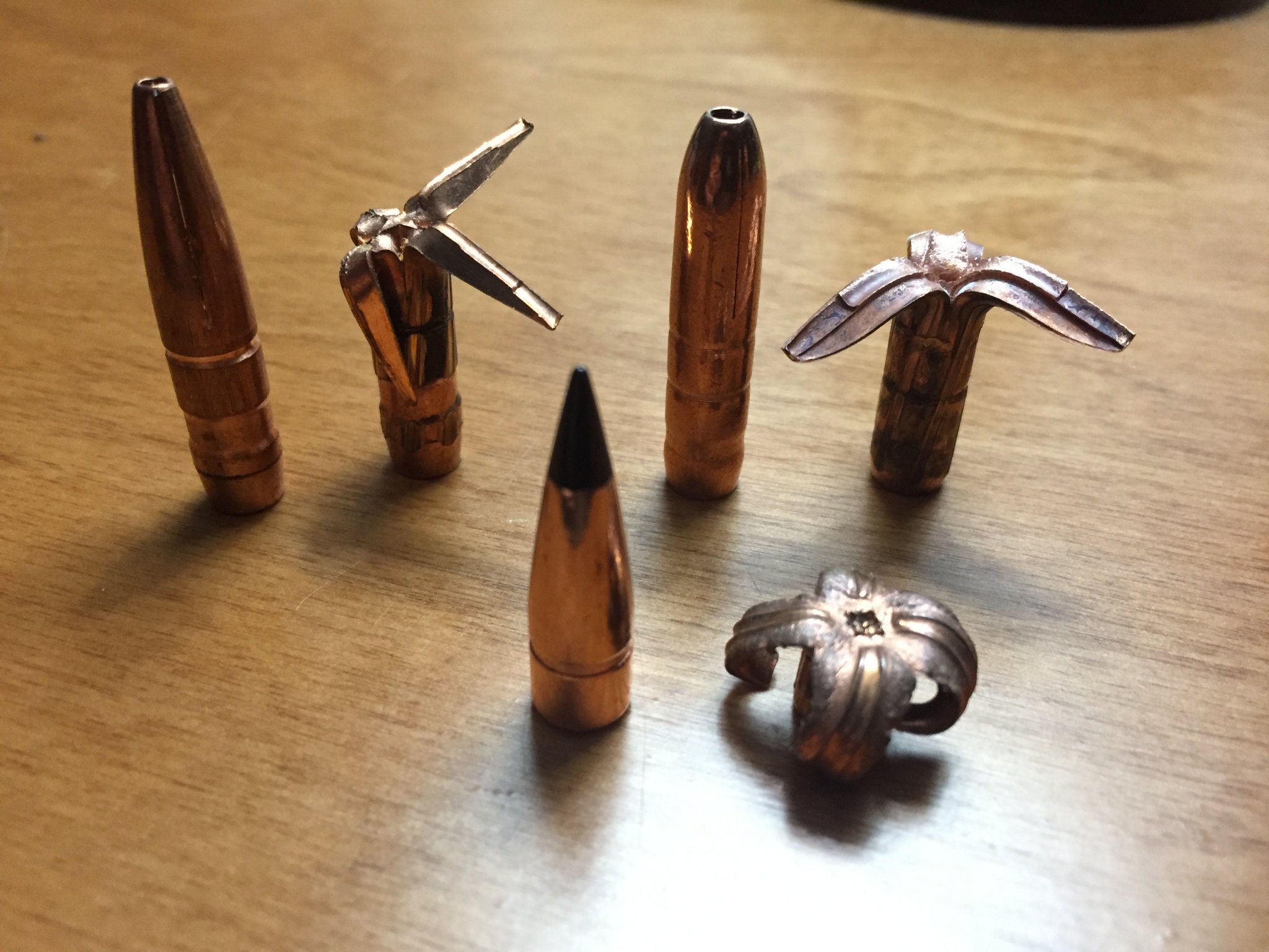

I have shot both Lehigh and Makers into water jugs at around 1000 fps. I know it’s not a great bullet test, but its all i had at the time. I felt the Makers opened in a more consistent manner. Some of the petals on the Lehighs always bent back as they tumbled but the Makers always held up.

I saw the same results. Actually did the water jug test several times just cause it's fun. Same results every time. Should also note that the bullets recovered from two of my deer looked identical to those shot into the gallon jugs and no loss of pedals

Ive done the water jug test several times. At 1000 fps they both passed through 3 ea. 1 gal. jugs of water and stopped in the 4th. One of the Lehigh lost a petal. The Makers peel back perfectly like in their adds. The Lehigh hits with a loud Crack. Sounds nasty. I've done this several times cause it's so cool. The Makers always "peeled" back where the Lehighs seem to open up but the petals want to stay more straight. So far I've only used the Makers on deer and have 100% success with them. Having said that, I wouldn't hesitate to use the Lehighs if i didn't already have 50 Makers loaded up.Hope this helps.
