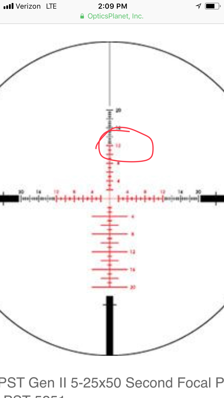

With a 40 moa rail you can zero in the top area of your reticle at 100 and gain max dial and hold over
Yes your true zero and the center of your reticle would be more than 100 but you would still have a 100 yard zero in the reticle
PST gen 2 doesnt have the travel for 40moa of rail/mount
^ To expand on that - because it seems that a couple people aren't sure what slamming the erector to bottom or maybe shooting just a bit high, like 6moa at 100, is a bad idea..
The GenII PST (going from one I have on a 22LR) has roughly 20mils of total travel or 34.5 from the optical center for dialing of elevation. So if the OP cranked the erector all the way to the bottom, he is still a bit short with the -40MOA rail/combo. Assuming his rifle shoots perfectly straight, he'd loose (actual gain back) about 3.5 MOA to SOB and gravity, making it almost work.. So on paper, a guy might not see this as being an issue, maybe it isn't, on a single purpose rifle were you'll be dialed off the bottom and not use except for ELR.
Ruining the erector at the extreme does things that aren't desirable for most of us. It is away from the optical center, in some cases causes a darker less round sight picture for the majority of our shooting, creates *hold "unders" and mechanically great for the erector springs.
This is the same issue for any low travel benchrest scope and many high magnification "tactical" offerings for use in ELR. Unfortunately, the OP's situation is where a lot of shooters find themselves, when they chase magnification first.
*as an example a +6minute POI at 100 cause hold unders until you get to 450y with my 6.5. - remember you will not be able to use your elevation until past 450y (using my 6.5 data).

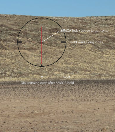

I am with you on the low cost option but there is a way most of us did it with great results and still do occasionally. I think Litz's team won a ELR challenge last year or the year before using the same idea..
Best part it is free and you can shoot all the other targets as you normally would.

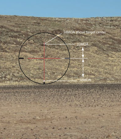

I recommended it in post #8; The key is to have a good well scaled index point.
Here is the OPs reticle illustrating using scaling.
Use anything you can create a fine index point..
Indexing on the target - you'll have over 3 seconds to drop into the target an see your impact
The only places this doesn't work is if you set your target to be sky lined.. or some how completely featureless.
