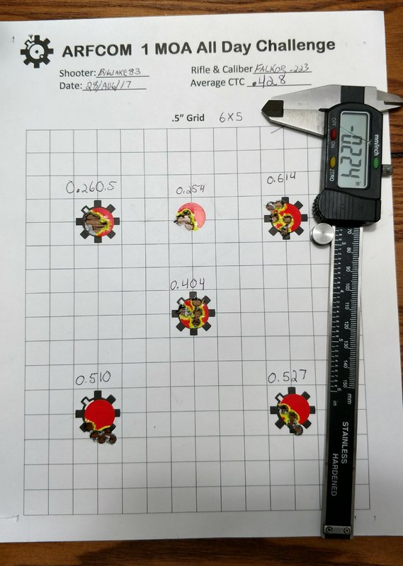

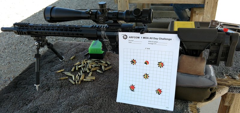

    Here is a 6x5 I shot the other day with a upper I put together for a friend, and as you can see my skill my be lacking, but the Accuracy is there, and this is with ZERO! Load development, I used the Same ammo that I've developed for MY AR, this target was shot with a completely different style/brand of Barrel. [IMG2=JSON]{"data-align":"none","data-size":"full","src":"http:\/\/i.imgur.com\/tIRPogd.jpg"}[/IMG2]

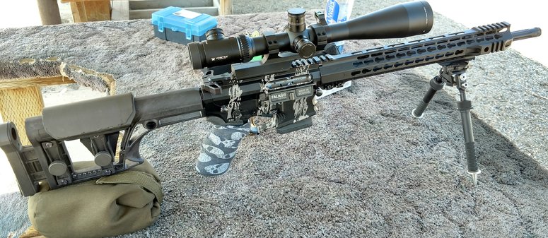

    So here are some final build pictures, and some final thoughts I wanted to Express about the key elements of building an accurate AR.
    #1 I would say the most important is to find yourself a quality Barrel I prefer to use Bartlein or Kriegers, in my experience those barrels seem to be among the most consistent on the market. [IMG2=JSON]{"data-align":"none","data-size":"full","src":"http:\/\/i.imgur.com\/s0x9Snp.jpg"}[/IMG2]

    Below is a target that I shot during break in last week with some cheap 55 grain Black Hills Ammo and to say the least I am very optimistic that this rifle will no doubt consistently shoot 1/2 MOA or less.. [IMG2=JSON]{"data-align":"none","data-size":"full","src":"http:\/\/i.imgur.com\/gZSgo0J.jpg"}[/IMG2]
    In case your wondering why the Buck shot pattern in the center, i was breaking in 3 different new rifles that day. [IMG2=JSON]{"data-align":"none","data-size":"full","src":"http:\/\/i.imgur.com\/kO652WY.jpg"}[/IMG2]

    I took her out yesterday when I was breaking in my new LaRue Grendel, and she's stacking them in one hole I'll get a 6x5 put up as soon as I can. I didn't do it yesterday cuz my target was shot to shit with Grendel holes, and I refuse to post cherry picker groups.
