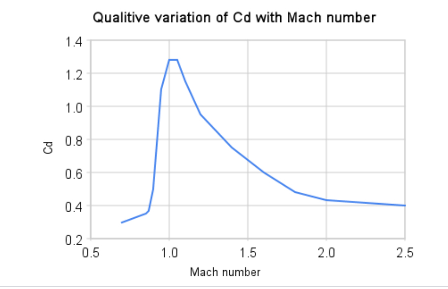

While I know this topic is about wind correction. The topic of change in Bc and velocity came up and wanted to add this chart as a visual representation of an example of the drag increase that occurs in the transonic realm.
M1 is around 1125.
M1.8 is around 2025 fps.
M2.5 is around 2800Fps.
Reactions: Baron23
