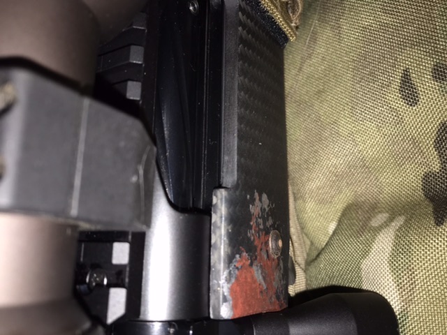

Yup will fit. The differences are usually in the ejection port and bolt release but the bolt release and ejection port will probably be the same or very close between those two. I have dropped a few different actions in mini chassis for Rem 700 and they all work. My last I put a TL3 in and the only difference is ejection port. As you can see in the pic the stock is a little longer into port but does not effect function.
