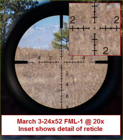

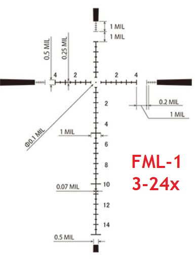

OP, are you looking for a FFP or a SFP scope? For me personally I find the FML-1 in the 3-24x52 to be a bit too thick above 20x, but if you consider the scope to be a 3-20 with the ability to go above 20x in a pinch, that is where it really shines. What type of shooting are you intending this scope to be used for?
The 5-40x56 is supposed to be even better than the 3-24 and as the image above shows the reticle is thinner, if you are looking for a FFP scope this has had good success, but watch for the turrets as they made both .1 mil and .05 mil turrets (my preference is for .1 mil).
