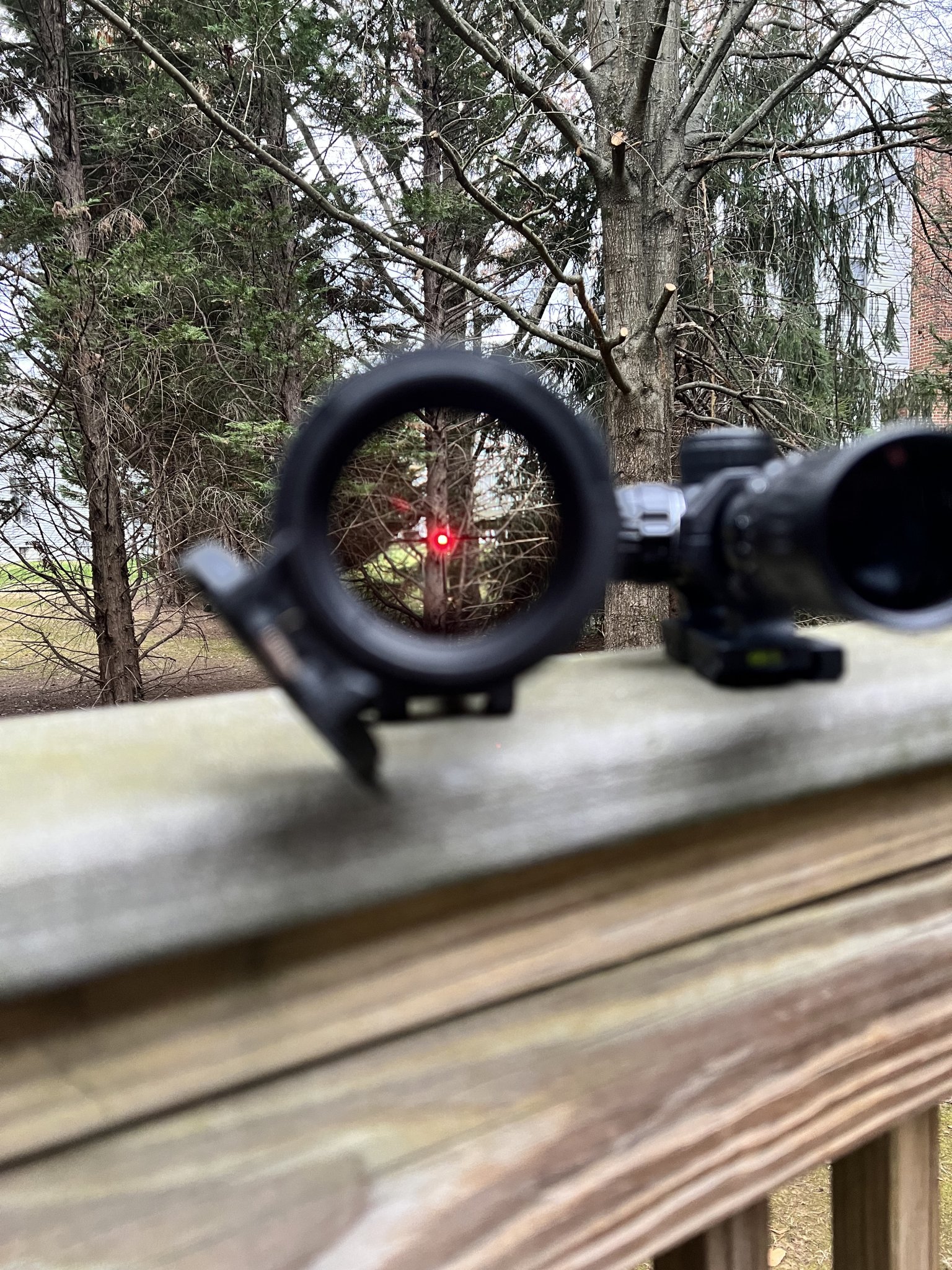

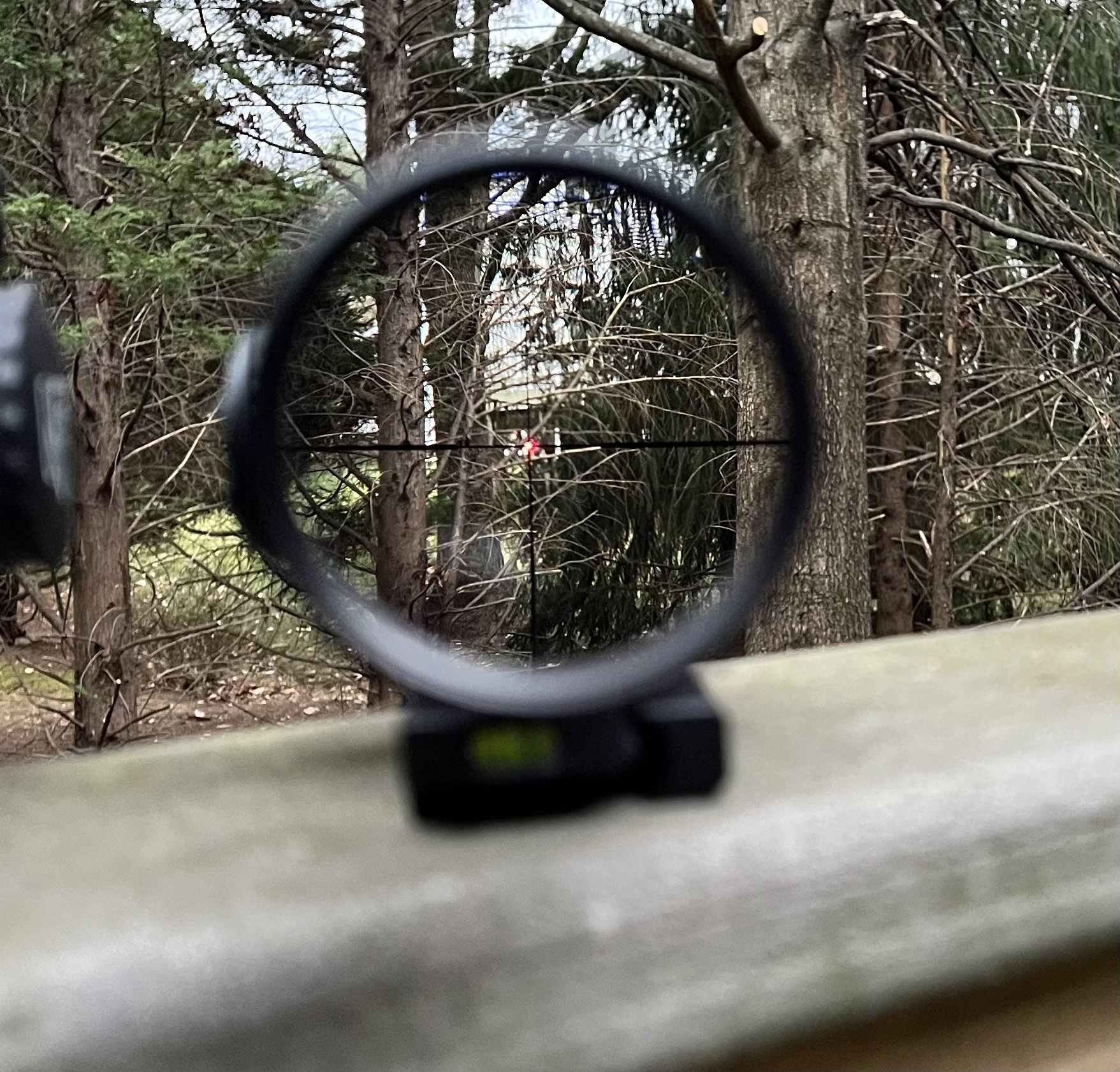

    Does anybody actually have pictures of the illumination of the dfp on the gen 1? I'm having a hard time figuring out the brightness of this thing. Some people say it's nuclear and some people say it's barely visible.

    It’s daylight visible, but nothing like an ATACR or Razor.
    The pictures shown above are an example of why I do not like comparisons of riflescope by individuals. The view is completely different betwen the two, the magnification is not identical and the illuminated to is not on the exact same target. One is on a dark tree trunk and the other is in branches with a light background.

    Yeah, beggars can’t be choosy… but can you answer why you didn’t bother to aim them at the same point? Otherwise, it really defeats the purpose of the “comparison.”
    Because I was doing both at the same time and not for some forum review? They’re aimed at the same area just offset, getting pix was a bitch. Just a quick comparison once I got the March in hand last year.
    I had no ulterior motives and in the end sold both. The ATACR is brighter with a more 1x usable reticle, though more obstructive. It’s heavy with terrible FoV and very low value for the MSRP.
