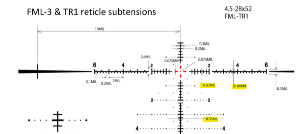

I really want one of the March high masters, either this or the 5-42, but I am unsure on their reticles. It seems like they are on the thick side, but I have never had a chance to look through one.
This is why I recommended you consider the FML-PDK or the FML-LDK for the 4.5-28X52 HM; These were designed with finer lines for the reticle. They are not illuminated in order to keep them fine at the higher margnifications. For the 5-42 model, the March-FX 5-42X56 HM Gen 2 offer the fabulous FML-WBR reticle, which also was designed to have fine lines throughout the range and is also not-illuminated for the same reason. These reticles were designed to provide the information that you need without obstructing the view. The LDK for the 4.5-28X52 and the WBR for the 5-42X56 eschew the use of Christmas trees as some top tier PRS shooters are moving away from them.
The FML-TR1 actually is thinner that the FML-PDK/LDK. The FML-TR1 is .03mil thick up to the 2mil hashes then it is .06mil thick. The FML-PDK/LDK is .07mil thick throughout. The FML-WBR would be the winner for me if only they made an illuminated tree version.
You're confusing the FML-PDKI with the PDK and the LDK. I'm of the two designers of the PDK and the LDK. The lines are .03mil thick. The PDKI came later and as it's name states, it's the illuminated version of the PDK. Its lines are .07mil thick.
You are right, I was looking at the PDKI which is .07mil, the PDK is .03, which is a bummer. I guess I don't use illumination all too often.
The TR-1 is .07mil according to the specs at the website.
TR1 is .03 from the center out to 2 mil then .06 beyond that, unless I am reading the specs wrong:
I'm not very familiar with the TR-1, but if I read the specs right, it says .075mil at the crosshairs, the illuminated portion, and then down to .03 mil from the beginning of the segment outside the crosshair and up to 2 mil. After that it's .06mil, as you say. I missread 0.075mil as .07mil, my bad, I dropped the 5).
