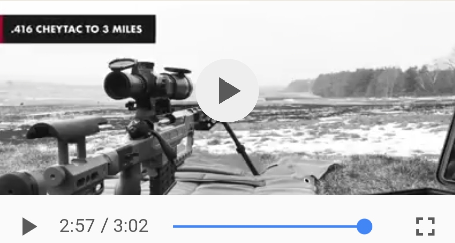

Guys - its out. 400 MOA should keep the ELR guys happy and I am keen to try 22lr at 1000 yards. Integral mounts too.
  • MARCH Genesis UK Download leaflet.pdf

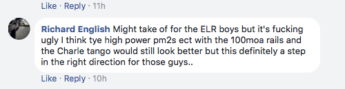

European Fan Reactions,
And I am not the only one that thinks about this competing with the Charlie Unit
The reaction is mixed at best, I am sure you'll get a rush of initial sales, but only time will tell if people want to drop $5k vs $1500

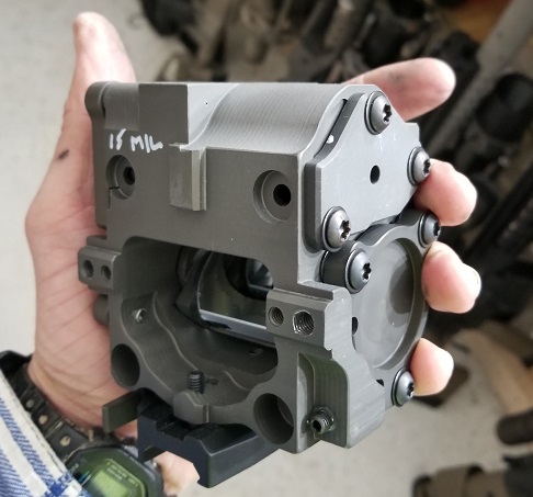

How come no one has mentioned that you can combine the prism and scope together and get 800 MOA?
This is another tool in the ELR toolbox. If someone wanted 800 MOA as an option, they have that option now. At 60 power, with the high master lens system.

I don't know that that would work since the front objective lens of the Genesis moves up and down. Would that not affect the performance of the gadget you place in front of it?
I always appreciate innovation, and generally am excited that manufacturers are spending this type of time and money on development and going out on a limb. The "wide angle eyepiece” sounds also seems like it would be a great addition to March’s other lines of scopes (ie 3-24x52).
Not a 100% sure , but I think a wide angle eyepiece might introduce edge distortion
problems , in an optic with high internal travel . The Genesis doesn’t have that issue
due to its design , it’s always perfectly centred .
Thanks. Could you define "somewhat?" It looks like Genesis can have as much as 5 degrees of cant.
Sure. The rear aperture on the Charlie is situated rather low on the unit, in this case working in your favor. Given the right stand-off from the objective, 5 degrees should still grant a clear line of sight to the lower mirror assembly inside the unit. The entire mirror does not need to be visible to function as intended. If mounted to the objective bell, I'm certain it would function flawlessly. If rail mounted (like the one in the pic) as long as the unit was close enough to the objective to allow a mostly uninterrupted line of sight (i.e. the scope is looking at the device and not down at the rail or barrel) it should work, no problemo.
