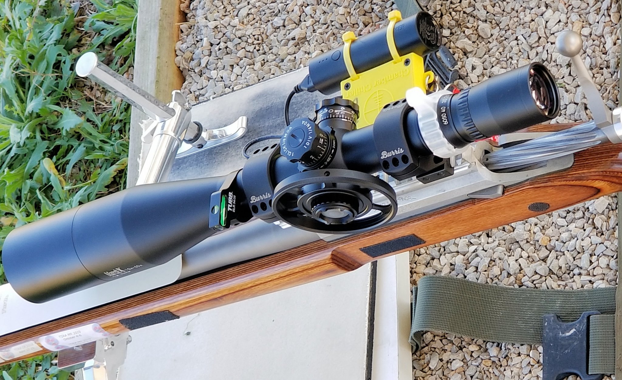

I 3D printed a focus wheel to the size I wanted. It is as big as I can make it while still being out of the way of the elevation turret. Focus rings are definitely handy!

I also have the March wheel on the focus knob; very nice to use and you can be very precise in focus.View attachment 7268170
