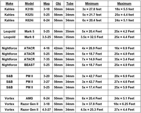

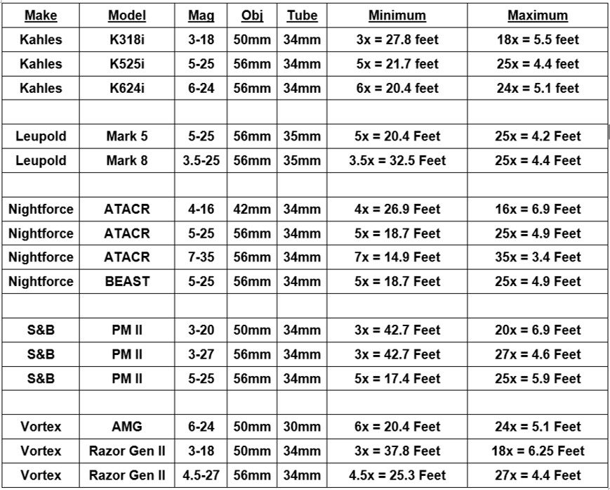

There are 2 things pointed out above, that will most likely get lost in all of the chatter, but when it comes to a Military optic these days, they matter!
LOW END FOV
Take a look at the chart above, and there are 2-3 optics that really stand out.
S&B PM II at 3-20 & 3-27 at 3 Power = 42.7 feet
Vortex Razor Gen II 3-18 at 3 Power = 37.8 feet
Leupold Mark 8 at 3.5-25 at 3.5 Power = 32.5 feet
In the real world of combat:
- Real targets are very dynamic, and you need the ability to keep up with that movement.
- A combat zone is extremely dynamic, and you need as much situational awareness as you can maintain.
Looking at the 15-20 foot "window" that most scopes are providing for their low end, is going to be very limiting and challenging. Having a 30-40 foot window does matter, and can make a big difference.
TOP END MAGNIFICATION
Nightforce ATACR 7-35
S&B PM II at 3-27
Vortex Razor Gen II 4.5-27
- Engagement distances are getting pushed further & further out. If you can't find or see the threat, then you can't shoot it.
- With current more stringent ROEs, you can no longer just put the crosshair center mass and pull the trigger. Per comments above, you have to positively ID an actual threat, and that could be something as small as a cell phone or remote detonator.
While you may not be able to run the high end of the magnification range all of the time, bottom line is you can't dial up magnifcation that you don't have.
In the past it was always pick one or the other, because you couldn't have good low end and high end performance in the same scope. Take a look at some of the scopes above, and that is obviously no longer the case.
When you look at both of those critical items in a scope, there is a clear winner in both, the S&B PM II 3-27.
The choosen Nightforce ATACR 5-25 is just in the middle of the pack, there are worse, but there are also better!
Honestly it is Military Procurement, so I am actually somewhat surprised that they did as well as they did!

Actually, the 5-45 is a "loser" on the low end. It's FOV would only be 25 feet at 5 power.
No offense, but you can tell the comments here that are coming from shooting on a one way range at static targets or shooting something like a PRS match.
The is a scope that is going on a rifle that will be on a 2 way range engaging real targets. If you loose your situational awareness looking through a soda straw FOV it could be a real bad day. There are times when having that extra 15-25 feet of view could mean the difference in seeing/catching whatever is trying to kill you. Also being able to crank the magnification up that extra 3-5 power could mean the difference in being able to ID what you really need.
Once again, the Nightforce 5-25 is NOT a total looser, but there is "better" out there on the low & top ends.
LOW END FOV
S&B PM II at 3-27
Good News, the USMC will be taking some steps forward with their new rifle and scope, but once again they are still not running the best that is out there.
