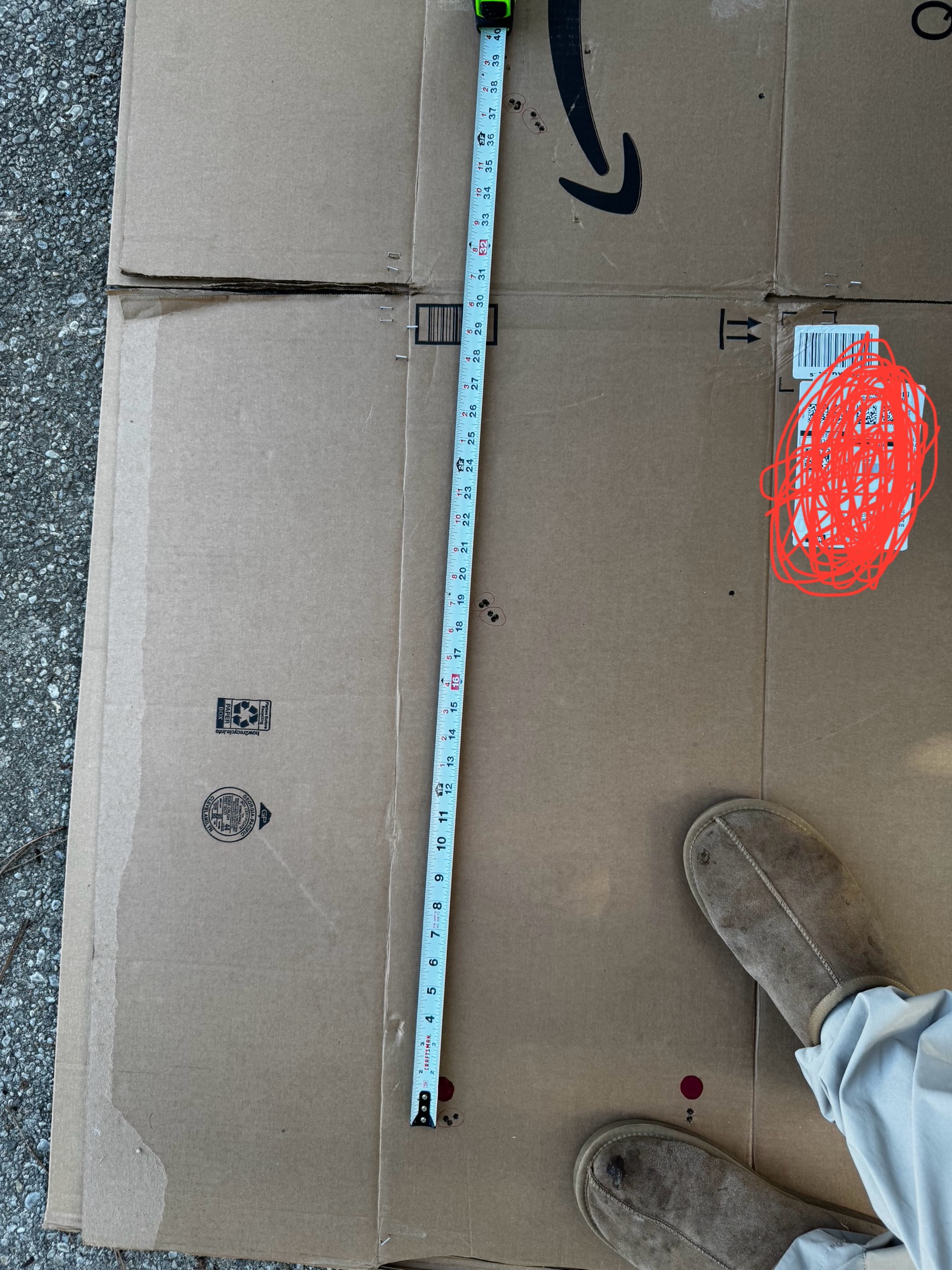

So here’s the problem, new scope I mounted right before a PRS match and my dope seemed to be off at longer distances. After trying to figure out what I was doing wrong I decided to test the tracking. I shot a group at zero then 2 at 5mil and 2 at 10mil all @100yrds. Problem is with 5mil the point of impact is moving 19” instead of 18 and at 10mil it’s moving 37-37.5”. Doesn’t seem like much but shooting .5mil high at longer ranges makes a difference. Do you guys see anything I could be doing to cause this or just a tracking issue? I shot the groups round robin to see shifts. View attachment 8682707
Edit: This edit is being added to address some questions or things that have been raised in this post. First I always shoot over a chronograph but it doesn’t matter in this test. Since we’re 100% testing impact shift at 100yrds then velocity, BC and all other influences do not matter (we’re only testing impact shift). Secondly I have already adjusted my data in the kestrel to match what the issue is, so that’s not really a concern.
The main reason for the post was to see if this is a common issue with the mark 4hd. I ask that because I have two Mark4 hd 6-24 scopes and suspect a similar issue with both. I bought a pr3 reticle for my 6.5 being built now and the pr2 reticle for 6gt. I received the pr3 reticle first so I threw it on and and shot a PRS match and found at longer distances I was shooting high compared to the (untrued data in the kestrel) and also when compared to friends guns running the same bullet and velocity as me. Right after that match the pr3 reticle came in so I swapped it onto the gun and went to true my data. Doing that is when I saw the actual tracking issue. I’ve been extremely busy so I haven’t had the time to run more tests but next week before sending it back to Leupold I will compare the two scopes side by side on a verified chart to see how much shift I am getting.

Not for nothing but you may want to edit the pic to take out the personal information from the shipping label.
Before sending it to Leupold for evaluation I'd mark out a grid on a piece of cardboard, 10 mils X 5 mils and lock the gun down and do a tracking test that way to see if the scope is tracking properly. I'm sure Leupold will take care of it if you want to send it in for piece of mind too.

He’s telling yall that it’s not tracking.
A chronograph has nothing to do with it.
OP, trust your tracking test provided it’s actually at 100 yards. You can push it off like that but you’ve observed it at various points now.

Not from what he wrote. His test is not a tracking test ( checks repeatability) but seems to be about checking that it matches known dope.
He said the new scope wasn't "tracking" with his existing dope, and then did a tracking test.
Definitely looks like a normal tracking test, which it has indeed failed.
The way I read the OP, he shot at group at his zero. He then fired (2) shots at 5 mils, and another (2) shots at 10 mils. Unfortunately for him the shots didn't land where he thought they should
That would be a form of tracking test.
I would repeat it by drawing 1 mil marks up to 10 from a zero, lock his optic or rifle down, and just adjust the scope and see if everything lines up. If it doesn't his original tracking test is confirmed and the scope needs to go to Leupold.

The opposite he tells us exactly that the scope is not tracking.
How much the reticle moves has zero to do with velocity. He adjusts the turret 5 mils and instead of going 5 mils it’s going more
3.6”=1mil@100yards and 3.6x5=18”
19”/3.6=5.278
37-37.5/3.6”=10.27-10.42
They change impact points dope is based on bullet ballistics and measured velocity
And if those all stay the same: at 100yards, how much should the scopes adjustment either scale or jump from what has been dialed?

It's always 3.6" = 1 Mil. Strelok Pro was saying 0.4" per click, and like a dumbass I assumed it was smarter than me (but now know it must just round up 0.36 to 0.4 since there's no room for the next decibel) and was talking out my ass. I own it.
@spife7980 and the others looking down their noses at me have been correct all along. I was confusing the relationship of MV to POI as somehow interacting with this instead of thinking of it strictly as a scale/ruler.
Sorry to be a dumbass (and I don't even have booze to blame it on lol).

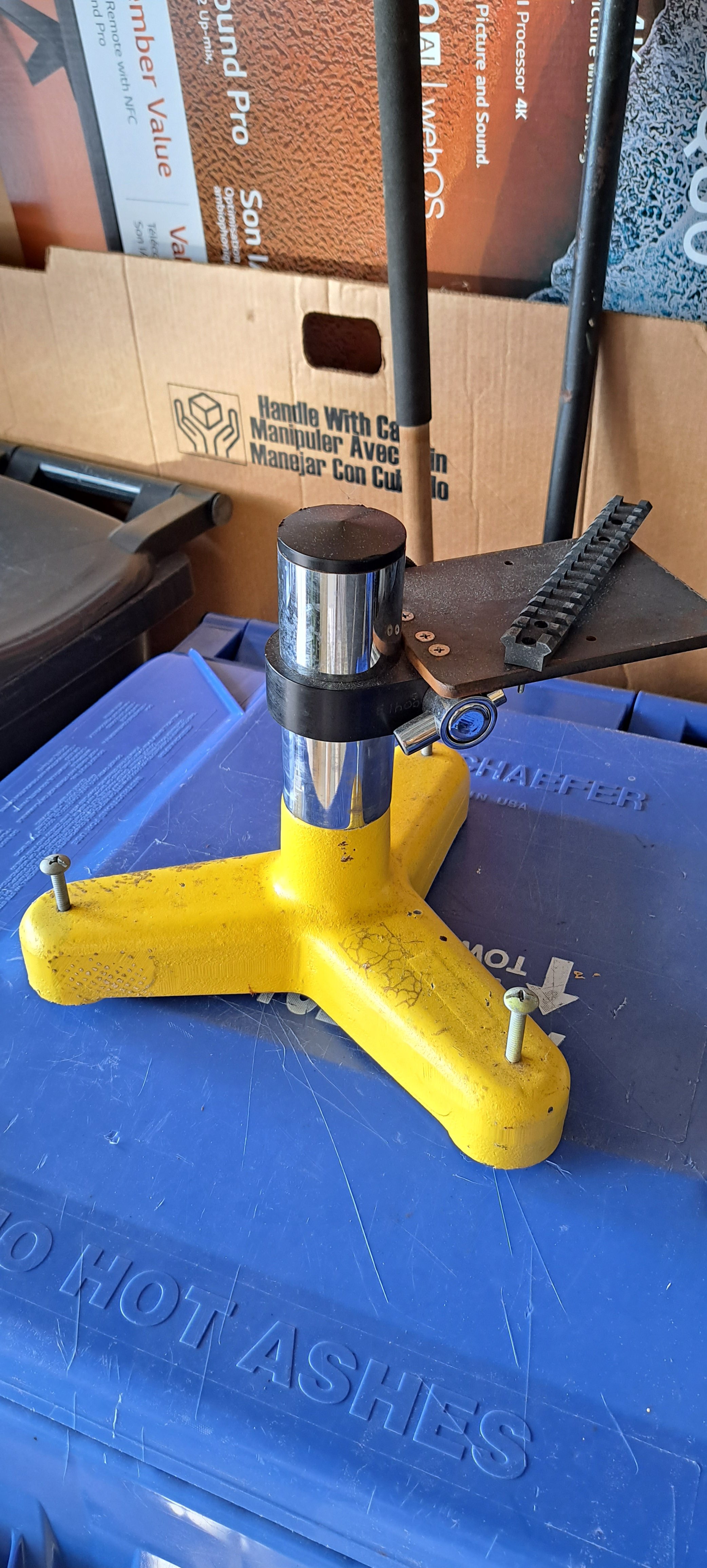

I have this heavy mofo just for checking scope tracking.
It'll help confirm if your scope tracks properly or not.
Yeah, yeah, yeah, I know. It needs a new camo sponge paint job.

he still does not know what a tracking test is.
OP
Get a tall target marked in mils and confirm your amount of error at the extreme ranges of the scopes travel - without firing any ammo. If it is fixed % of error you can adjust your dope accordingly and/or send the scope back for repair.
This ^^.
IMO, the OP's way of doing a "tracking test"...well, isn't.
Tall target like this (or really anything with say a 36" vertical line erected at 100 yards...exactly 100 yards and exactly vertical...use a plumb bob).
Set either rifle with scope or just scope (if you have a fixture to do that with) in a fixed and level position. A lead sled type thingy will do or really any way that will hold the rifle/scope dead steady in position while you exercise the elevation turret.
In this manner you have isolated the scope erector from any other factors....like your shooting, ammo, whatever.
And you will be able to quantify the error in vertical and determine if it skews a bit laterally with elevation movement.
Its actually quite easy to do....I'm a moron with tools and such and I can do it.

Goddamn this thread is painfully full of idiots and poor communicators. OP did a basic tall target test which shows that as he dials past 5 mils, his scope has an increasing error rate to at least 10 mils.
Using Litz’ own formula, 36/37.5=0.96
The scope has a 4% error at 10 mils of adjustment on the turret. Will that cause a miss at 1000 yards using a competition caliber on a 2 moa plate? It could. Is it acceptable to Leupold QC? I don’t know. Can OP use kestrel shenanigans to correct for it? Yes, if he wants to.
Maybe do the math to make sure your expected shift in POI is accurate. Maybe draw a line and use a level to make sure you are tracking vertically. Maybe just draw two dots 36” apart and send five more rounds at each. It’s not complicated. I’m with the OP.
