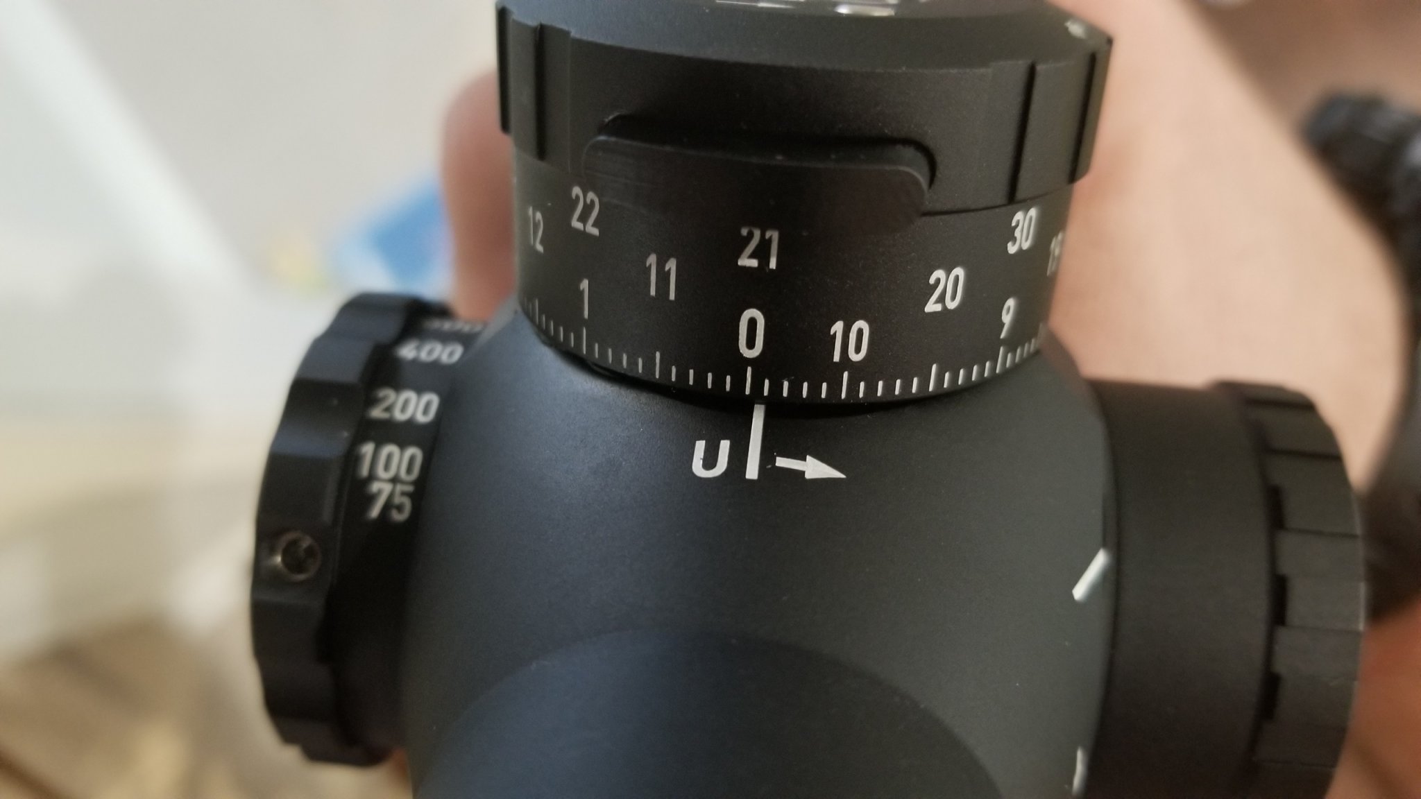

I just got my mk5 3.6-18x44 today and have an issue I'm uncertain of. The scope turret locks in at zero. I push the detent lock in to release it and start turning. At one revolution the detent becomes flush with the turret body but the top indicator button doesn't move from its original flush position. On the second revolution it doesn't make it all the way and stops at around the 17 mil mark. No third revolution. Is there something locked in at the factory or something? I am not going to force it beyond its stopping point at 17 mils.
I think the factory setting is what your saying. I took off the turret and played with the center column screw and now have a full three turns. The top indicator button only has two positions though. Flush first two turns and proud the third turn. Maybe its supposed to be that way. I'll check some videos and see if that the case.

When locked on zero does your elevation turret line up appropriately? Mine locks in between 0 and the 10.5 hash. I contacted Leupold about it but I don't think they understood what I was saying because they said it was due to military request in order to be able to make shots at closer ranges than zero.

Guys, I don't know how else to state that I understand you are able to turn down .5 mil from zero. What I'm saying is that is my turret locked in at what should be zero. Instead it locks in between the zero and 10.5 mil hash. My first click up goes to zero. No matter how I try to adjust the turret with the set screws this is where it locks in to 'zero'. Am I missing something really obvious here or what?

Leupold replaced two turrets for me because of the same issue. New turrets lined up perfect. What you are experiencing is not normal. Some of it has to do with one screw being tighter or more turned in when the other.

Thanks for the reassurance. I replied back to Leupold with a photo and an explanation that he wasn't understanding what I was saying and I haven't heard back. I'll probably have to call them.

It looks to me like the turret markings or the zero mark on the scope body are off, you can send it back to see if they fix it or not.

"The Mark 5HD is designed per military request that the dial does not stop on zero when rotating clockwise but in fact goes beyond by .5 mil. This is to insure accurate shots on targets using a high-mounted optic if ranges are inside the scope's zero.
Best Regards,"
Their words, not mine. He misunderstood what I was saying anyhow.
