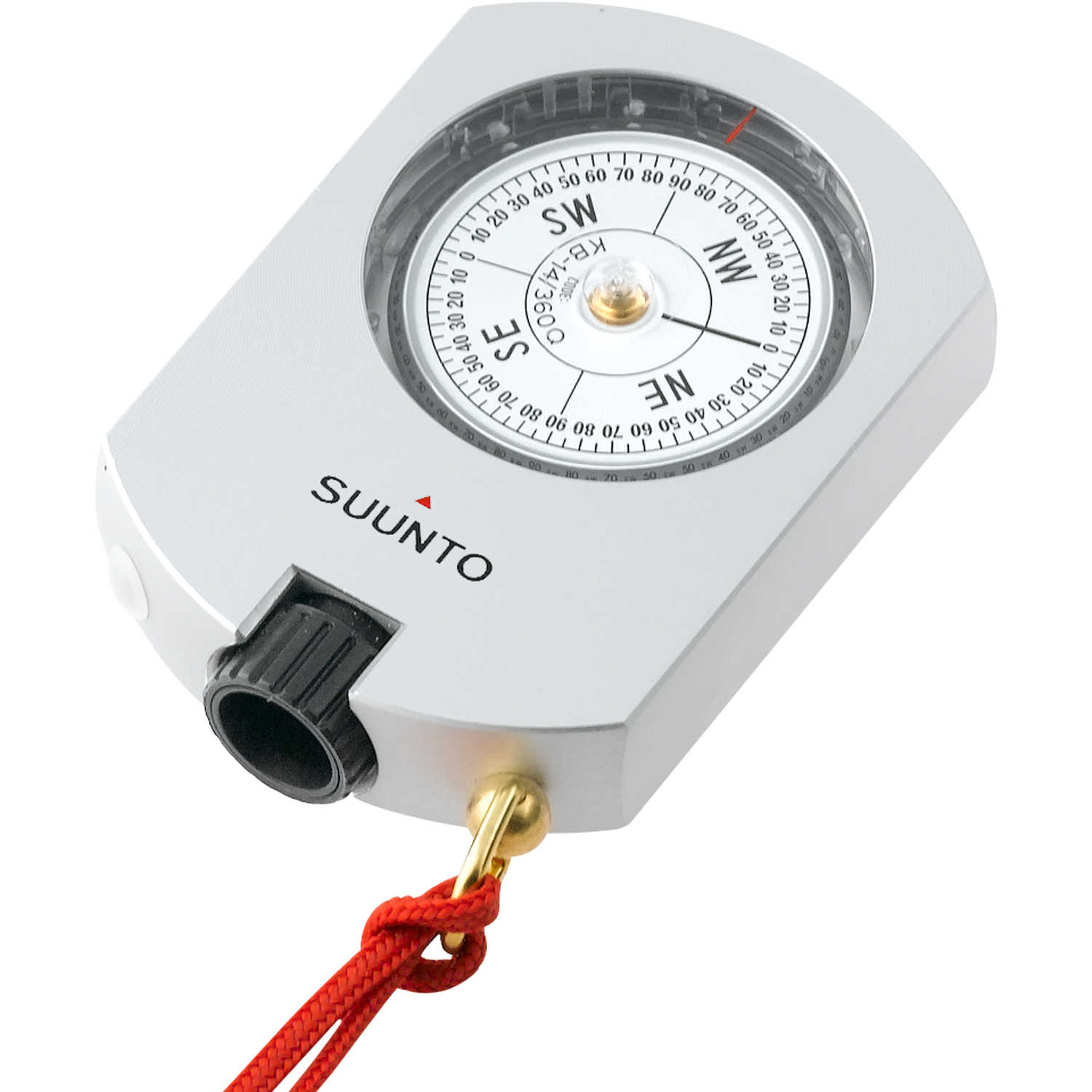

I’m doing this. I’m primitive though. I used an aerial photo to get a compass bearing, then used that to start. Every so often I’ll leave a tree standing if it’s directly in line where I want to go, and use that line of trees to sight down. Flag them with surveyors tape for visibility. I’m hoping to get 700 yards though, and I’m concerned how much I’ll wander by the time I reach the other end. I’m maybe 300 yards in now, but I quit for the winter. Maybe I’ll try some of the ideas above and start from the other end.
