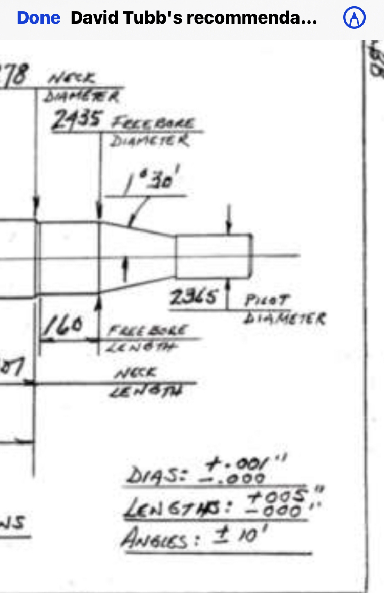

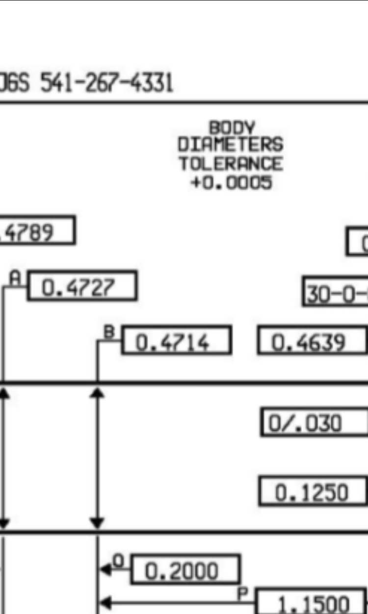

    i am curious if your barrels will have small freebore that is barely bigger than the bullets for each caliber.
    for example, will your .308 rifles have the tight freebore of typical 6.5CM rifles?
    Image result for tim and eric gif
    if you didn't understand the question, it pertains to a recent article on 6.5 western, where they cite the .0001 freebore clearance for 6.5CM and 6.5 western, and they attribute some of the accuracy to this, stating that this keeps the round more centered when it contacts the lands, making them inherently more accurate than the "typical" .001 clearance of the freebore for typical 30-06 or .308.
    All prefits for me, savage or shouldered. It was a big selling point for me to pick up an Origin action (and then the second that quickly followed). Preferred barrels doing the shouldered prefits under $400 (and with many chambering options, including sherman wildcats) makes a lot of sense. If my 7mm-08 barrel shows up and shoots well, they'll get more of my business. Wish they would offer lighter sporter contours though, seems many prefit companies dont want to (Criterions and preferred barrels sporters are quite heavy, X-caliber doesnt guarantee accuracy under their #4 contour).
    Have one of each. One accepts Remage and the other is a manufacturer/model that accepts widely available pre-fits. I’ve yet to swap out the barrel on that one but plan to myself when the time comes. The Remage Heavy Palma in 6.5 Creed was easy enough for me to install with the right tools, to include go and no-go gauges.
    Reactions: Stoweit
    The clearance is a moving target depending on what bullet you are shooting. The bullet diameter of say a 224 cal bullet may actually be .2237 to .2242 depending on the manufacturer or even vary this much from lot to lot of the same bullet. I usually spec my reamers about .0005 over nominal to avoid any issues, and the barrels shoot great. .001 over is probably not bad for a field rifle.
    I personally think the leade angle is more important for proper bullet alignment & accuracy.
    Reactions: theLBC
    right on, but i am talking about some rifle makers that ask the customer what bullet they want to shoot, and won't build them a rifle without the customer specifying exactly what he/she intends to shoot.

    Most reamer manufacturers wont/cant hold to .0001 in diameter. The 6.8 western folks can specify it, but they’re not getting it. Below are two prints, one JGS and one Manson.
    Exactly. If 0.0001 is the target for clearance, what is the allowable tolerance? Typically it'd be something less, correct? So now we're talking about jamming a reamer into a chamber and expecting to hold a tolerance somewhere in the range of 1-2 microns :ROFLMAO:
    And we haven't even yet talked about the folly of holding this clearance over a normal range of temperatures; even a perfect nominal chamber leade and a perfect nominal 0.264" bullet will go from this theoretical clearance of 0.001 to jammed tight (or twice as large) with a temperature shift of about 35°F (assuming COTE values of 6.5E-6 for stainless steel and 16.5E-6 for lead; actual values may vary depending upon the specific alloys involved).
    The point, of course, is that such tiny values are not regularly achievable in practice in real-world conditions. This sounds like yet another case of a gunwriter being suckered into repeating a line of garbage from some marketing guy, which presumably is the only reason that mags such as G&A still exist, and why you won't see articles posted by these writers anywhere that they are likely to receive critical feedback.
    EDIT: None of the above is intended to suggest that @THEIS cannot hold a chamber dimensional tolerance of 1-2 microns. Hell, his team can probably do that on a Monday morning or Friday afternoon. But that ain't gonna fix the other issues noted throughout this thread.
