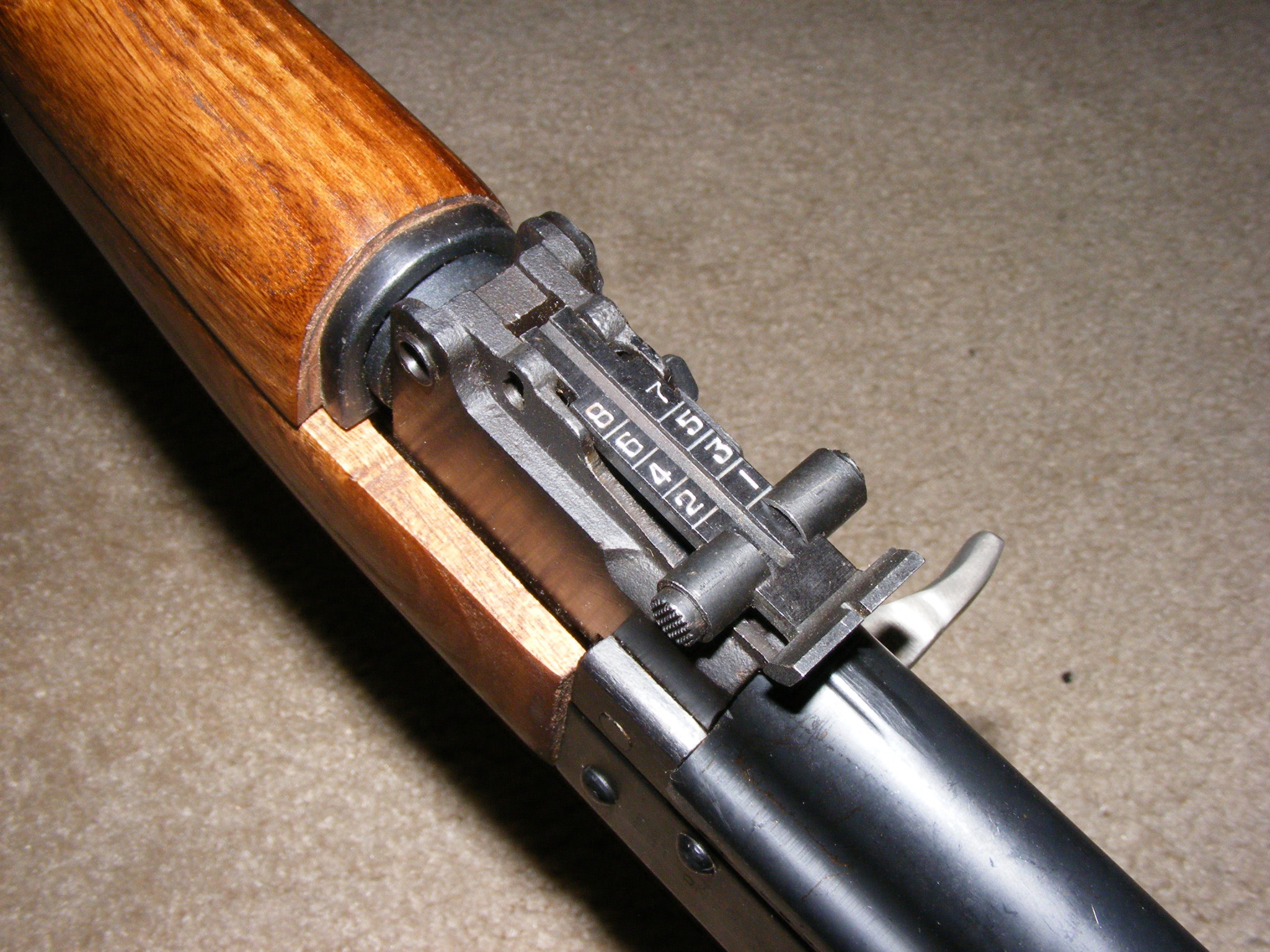

Sight 1) A universal tangent sight (such as on The Kar98, Ak47, SKS)

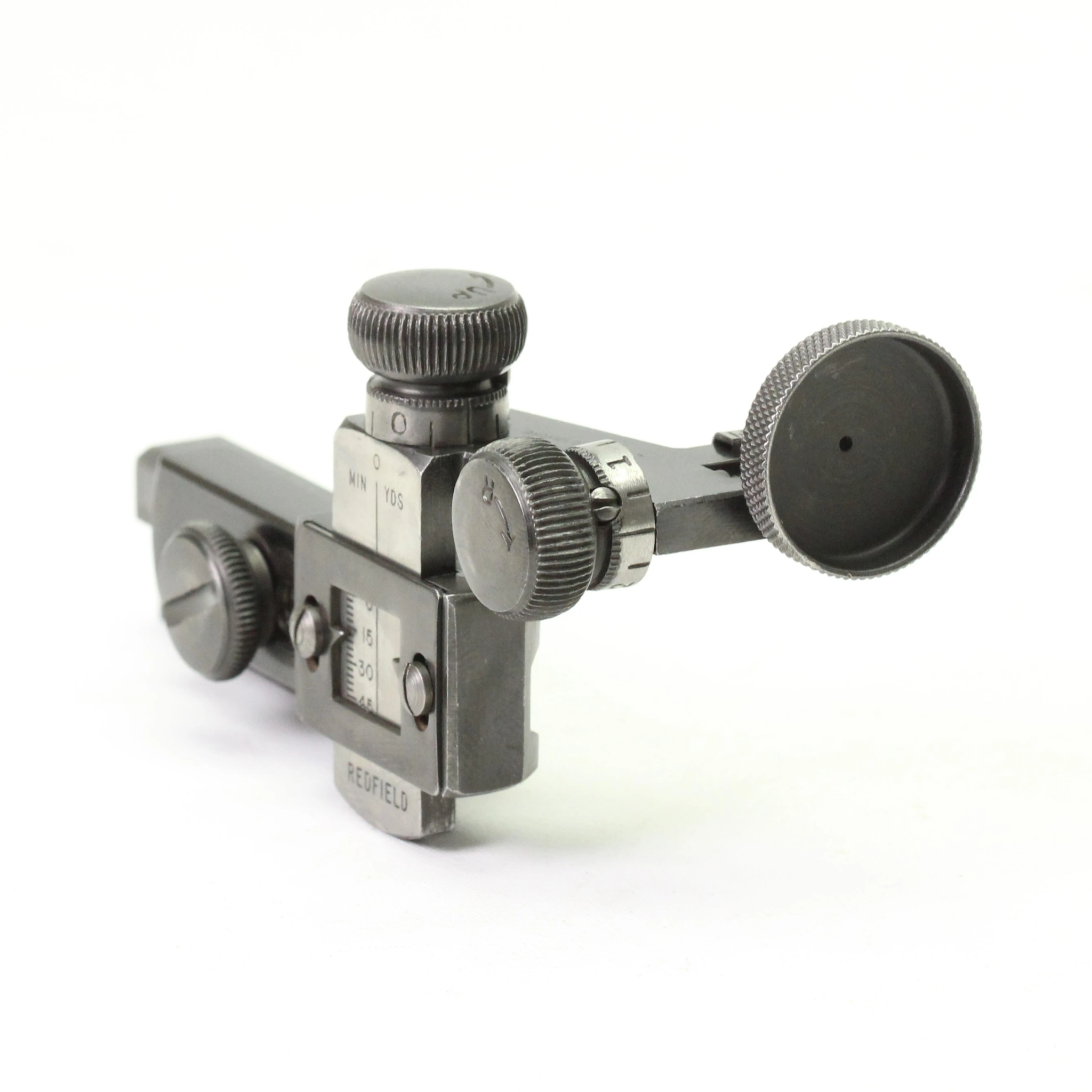

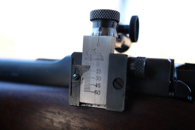

Sight 2) A target peep/aperture (sight such as the old Redfields and Parker Hales and the newer RPA sights)
1)
2)

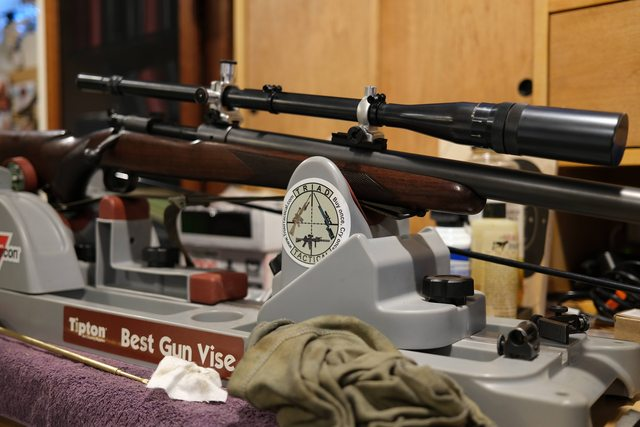

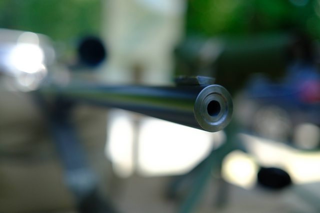

I went "Belt and Suspenders" on my Win 70.
Receiver mounted rear....
Front on a dovetail....
Scope blocks on receiver and barrel for optics....
Everything is "QD" and I have a blank to fill the rear sight base when the scope is mounted...
Changing block heights allows for all kinds of adjustment to compensate for barrel diameters or receiver mount heights.
My fantasy idea for this gun was a 30-06 capable of taking any animal in North America, optics for aiming yet irons for when the scope shits the bed.
I have a Redfield 3-9X I was thinking of mounting on this. If I did I would use a pic rail with some sort of QD rings or common 1/2 inch nut with a specific torque.
My rifle was easy as Most of the required prep smithing was factory. Receiver sight mount holes can be a bitch to do after the fact depending on hardness.

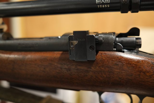

If you were going to mount the rear receiver sight on the pic rail Id suggest something like that on a Springfield 03A3.
Simple peep, rough range graduations you would have to confirm with your ammo, excellent windage adjustment for zero with expectation to use "kentucky windage" if actually needed.

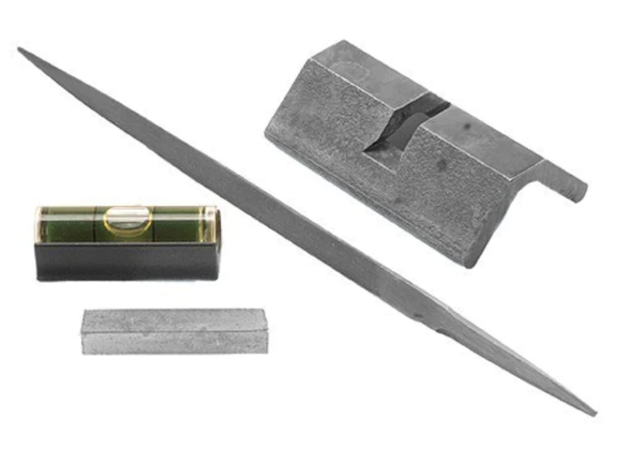

1) A dovetail. This could be hand fitted to prevent the need for a gunsmith. This is a kit from Wheeler Engineering:

One could always provide 2 front sight options I guess but the dovetail seems the safer. A dovetail and 2 front screws are the only 2 styles that I can think of that can be universally adapted. I think there are too many variables which will hinder the ability to use anything which goes over the barrel. If anyone can think of anything, then I'm all ears. The below barrel clamp in an option but is rather bulky. I guess that the design could be refined a little to clean it up slightly. It would be more of a temporary fitted sight though as opposed to a permanent fixture.

I hadn't come across the Springfield 03A3 sight before. They are quite a nice setup!

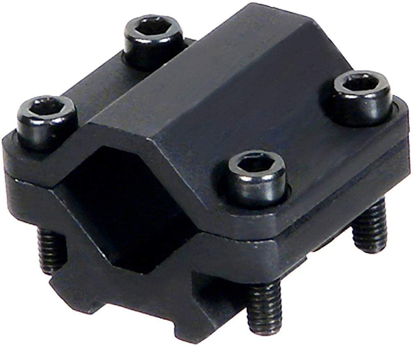

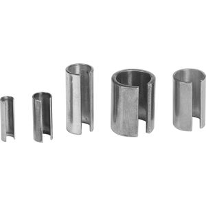

I like the slip on ring ideas but would need to account for too many different barrel types. I guess that these could be sleeved with bushes such as the images below. As @gnochi said though, because of the taper, this is an option prone to problems unless specifically designed for the barrel. The rear sight on Tikka Arctic are very cool but if they were for custom rifles then they would require the holes to be precisely drilled according to

Although target style sights (Sight 2 style) are more accurate, nothing, except a tactical scope to my knowledge, will be as fast for changing targets at varying distances as a tangent sight.

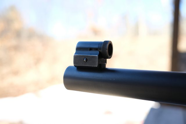

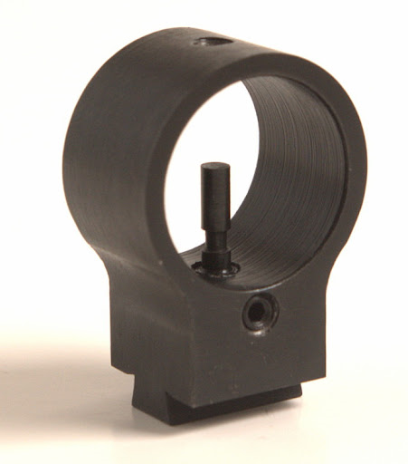

I was thinking of the M39 @MK20 front sight and would want all adjustments to be made at the front. After looking at a ton of options, I am thinking of something that is proven and works very well. And I keep coming back to the Mosin Nagant 91/30 front sight, with the one alteration being a grub screw to set the elevation instead of a file.
Maybe this style but with an open top would be better like the M39. This would prevent the problem of having to maintain the front ring centered with the post sight alignment (which would be a big problem with varying barrel sizes, height above bore axis, etc.). The M39 style "wings" would also have less chance of coming into sight picture of any optics if it were permanently mounted.
