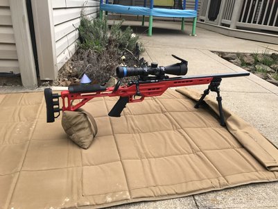

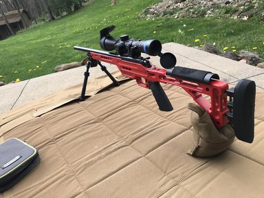

Originally a 16" Tacticool. Chassis was delivered in a little over 6 weeks. There's not a whole lot of clearance at the front of the forend so a Lilja straight taper probably won't fit (my McMillans fit the same way but being fiberglass, I was able to open those up). Weight is 11.4 lbs. as it sits.

[IMG2=JSON]{"data-align":"none","data-size":"full","src":"http:\/\/i.imgur.com\/FSgtQxj.jpg"}[/IMG2]

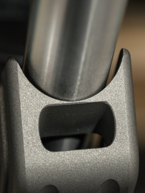

So, I got my action screw issues sorted and got the action torqued into the chassis, I think it's pretty well set up now. The Lilja bull barrel DOES clear the chassis, a dollar bill slides between them without touching and there's no flex between the barrel and the chassis even at the fore end. Here's a photo of how close it clears. I wish it were more centered in the channel, but this should be OK.

Anybody got a picture of an MPA chassis with the factory 16" tacticool barrel in it? How much clearance does one have?
Also, how easy is it to change the length of pull with a slimmer recoil pad? I ask because my kids will be shooting it quite a bit, but I too will be utilizing it and want a 13"-13.5" lop.
Post #1 and #8. Not much clearance but it does float the barrel.
