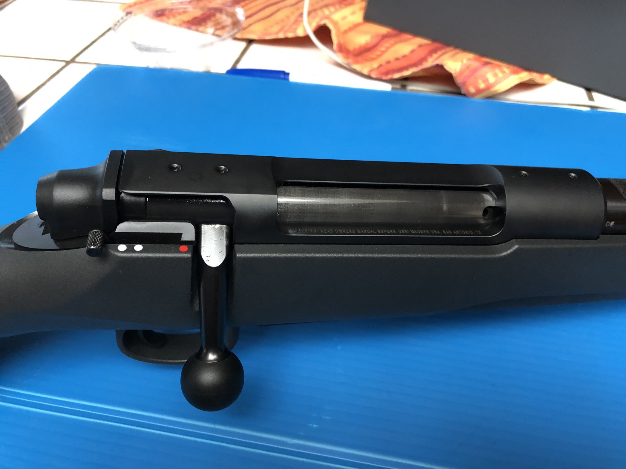

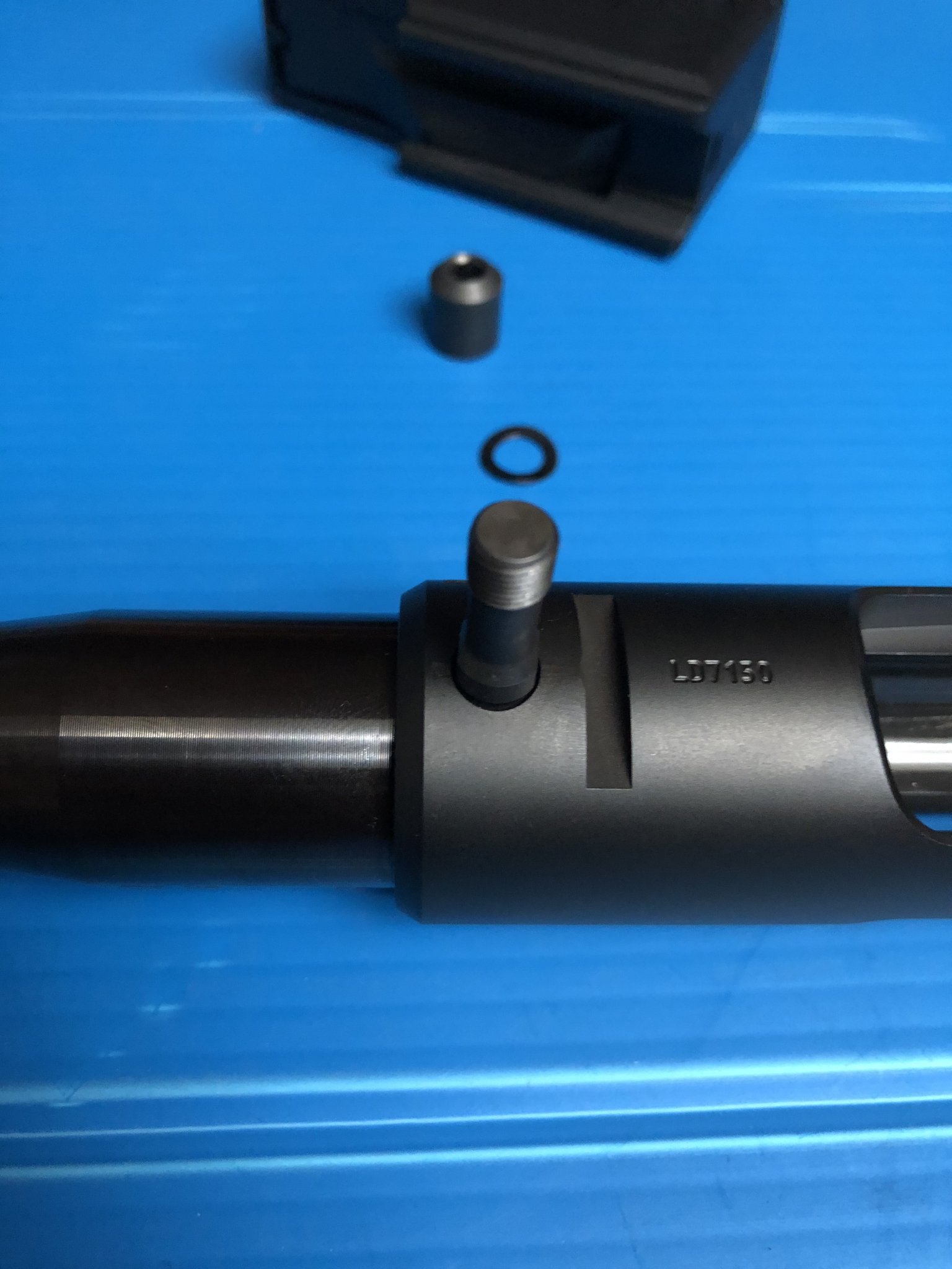

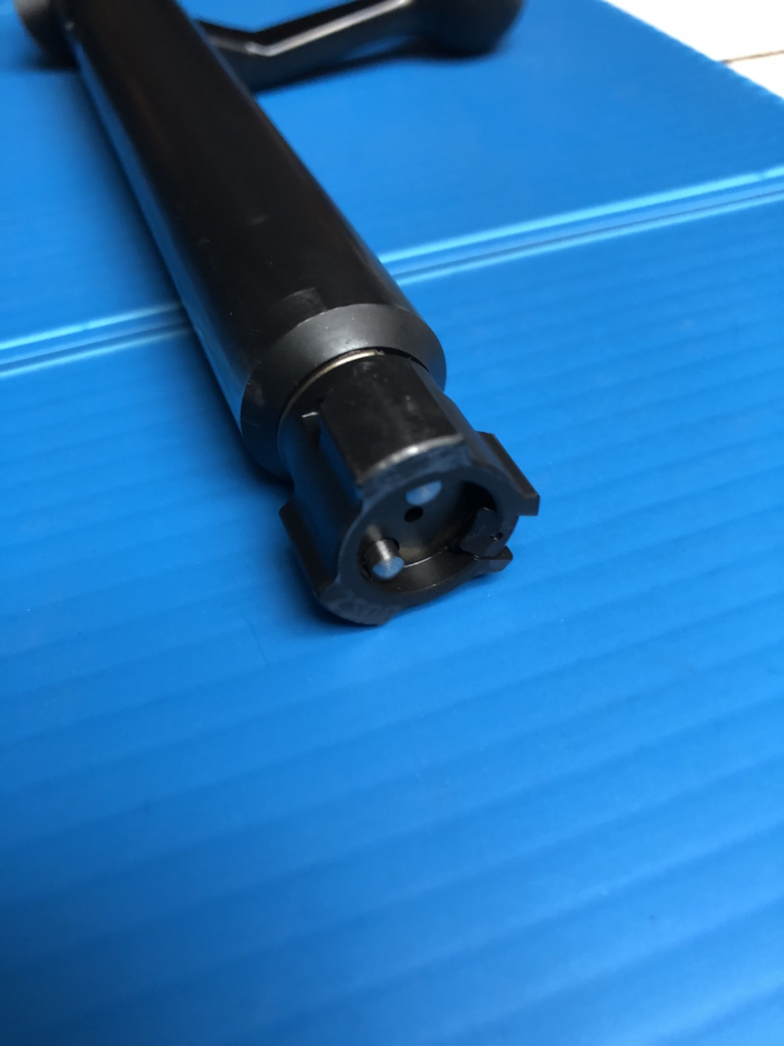

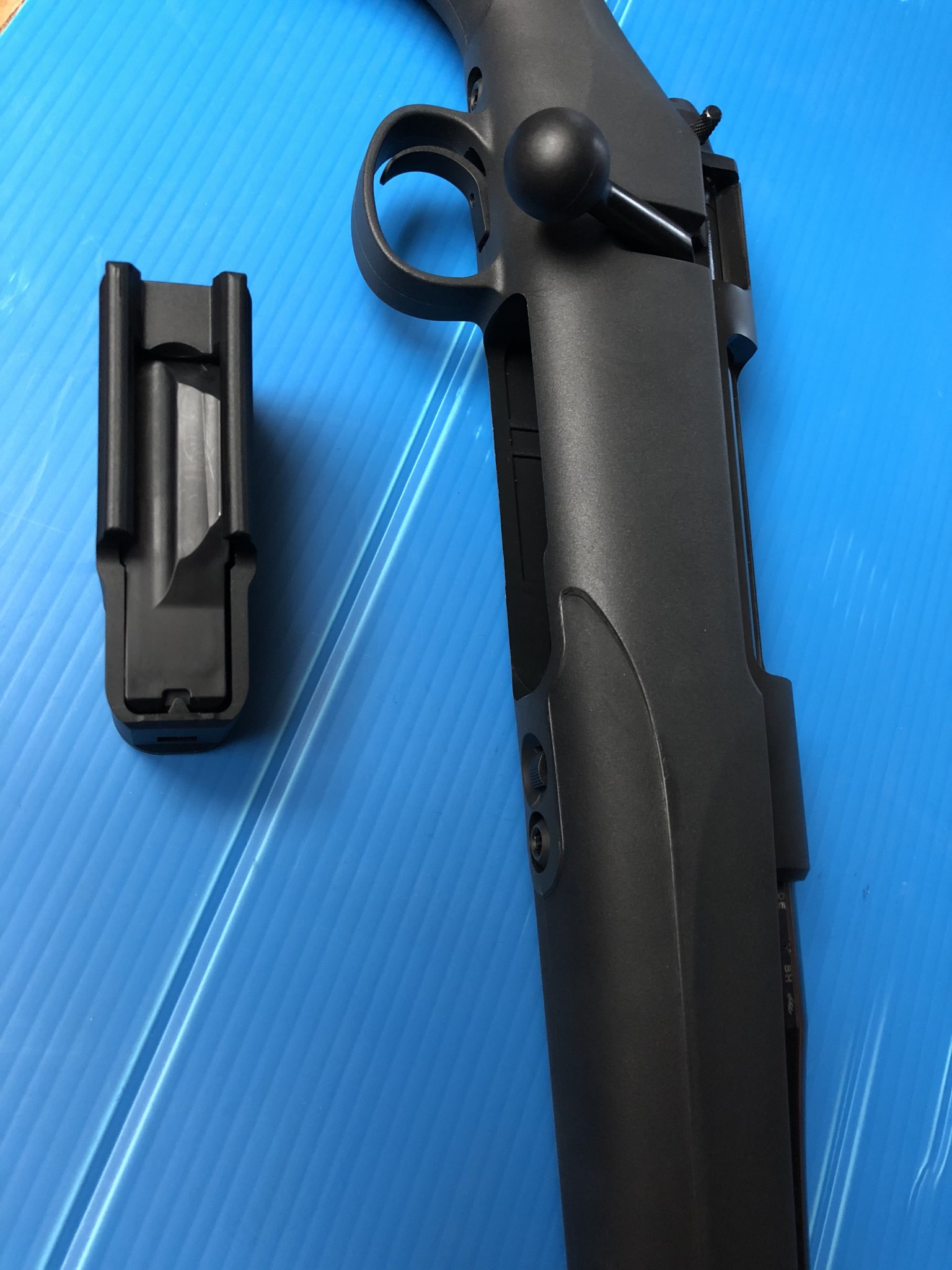

Hello Everyone. Recently picked up a Mauser M18 in .308 22” barrel 1-11 twist. Under 1MOA 5 shot guarantee
Here’s are my initial impressions regarding fit, finish:
Fit and Finish

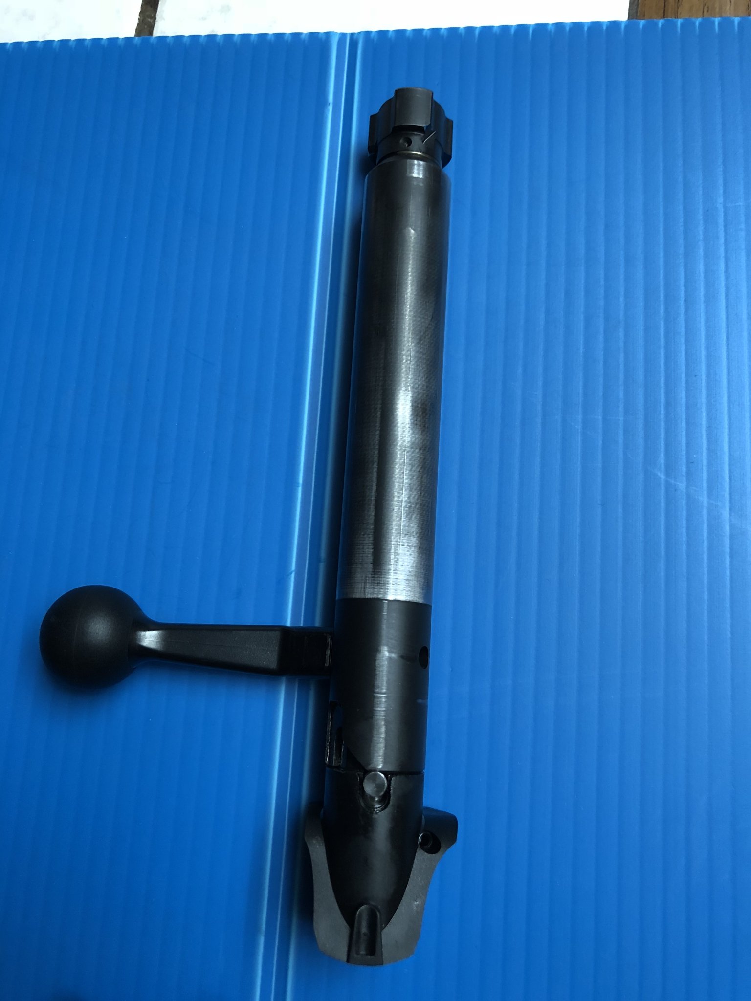

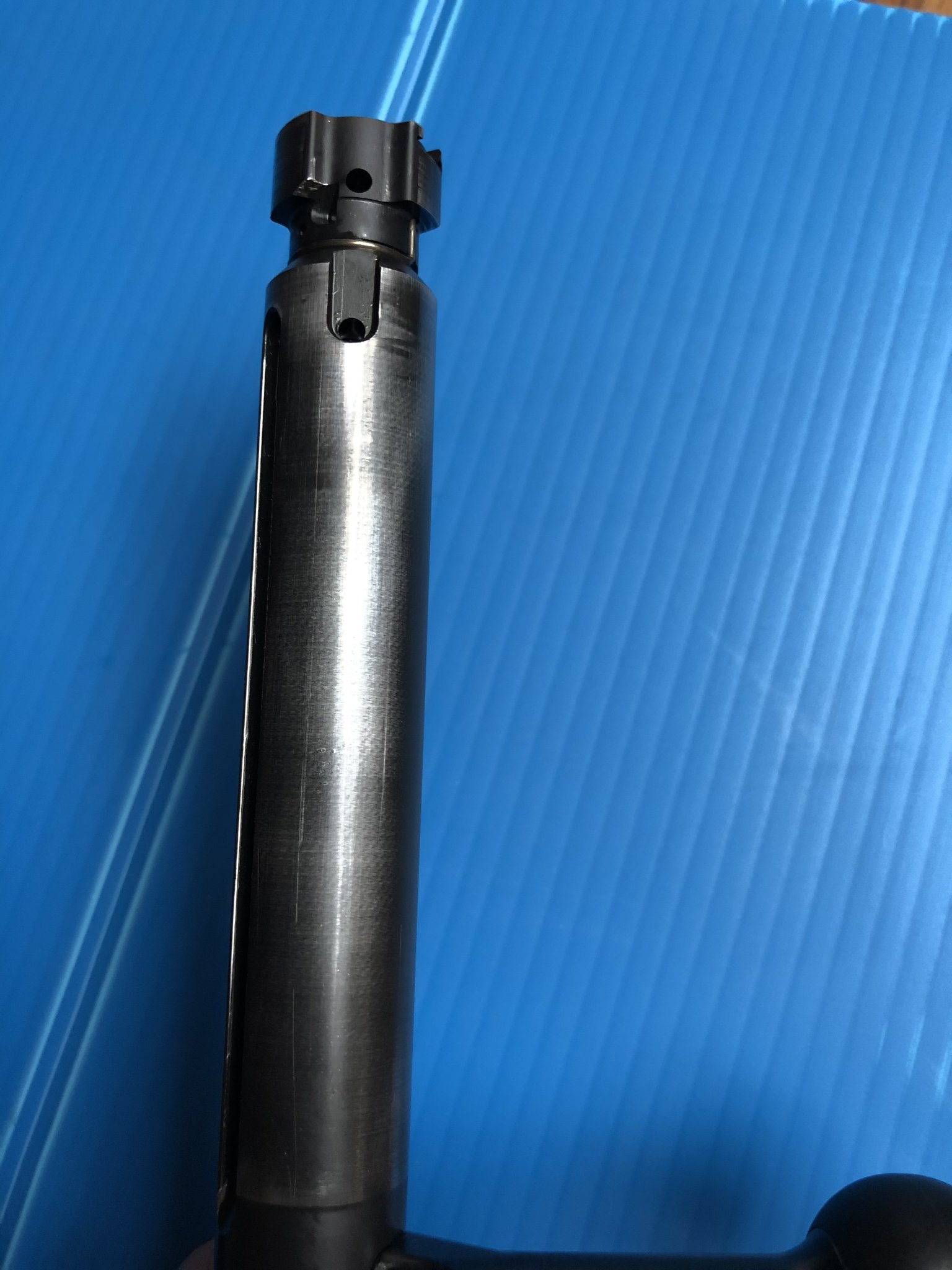

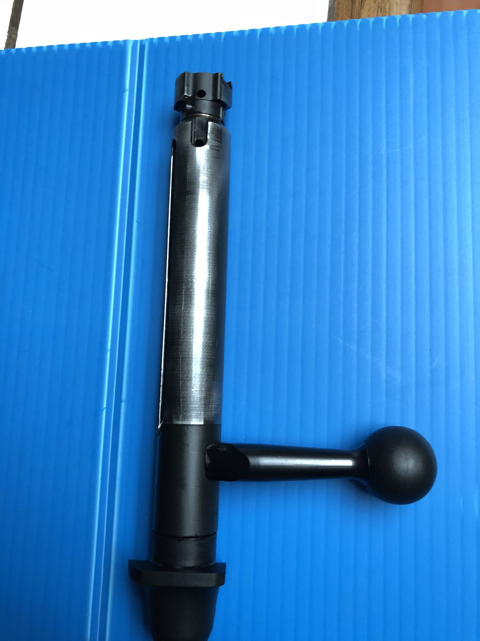

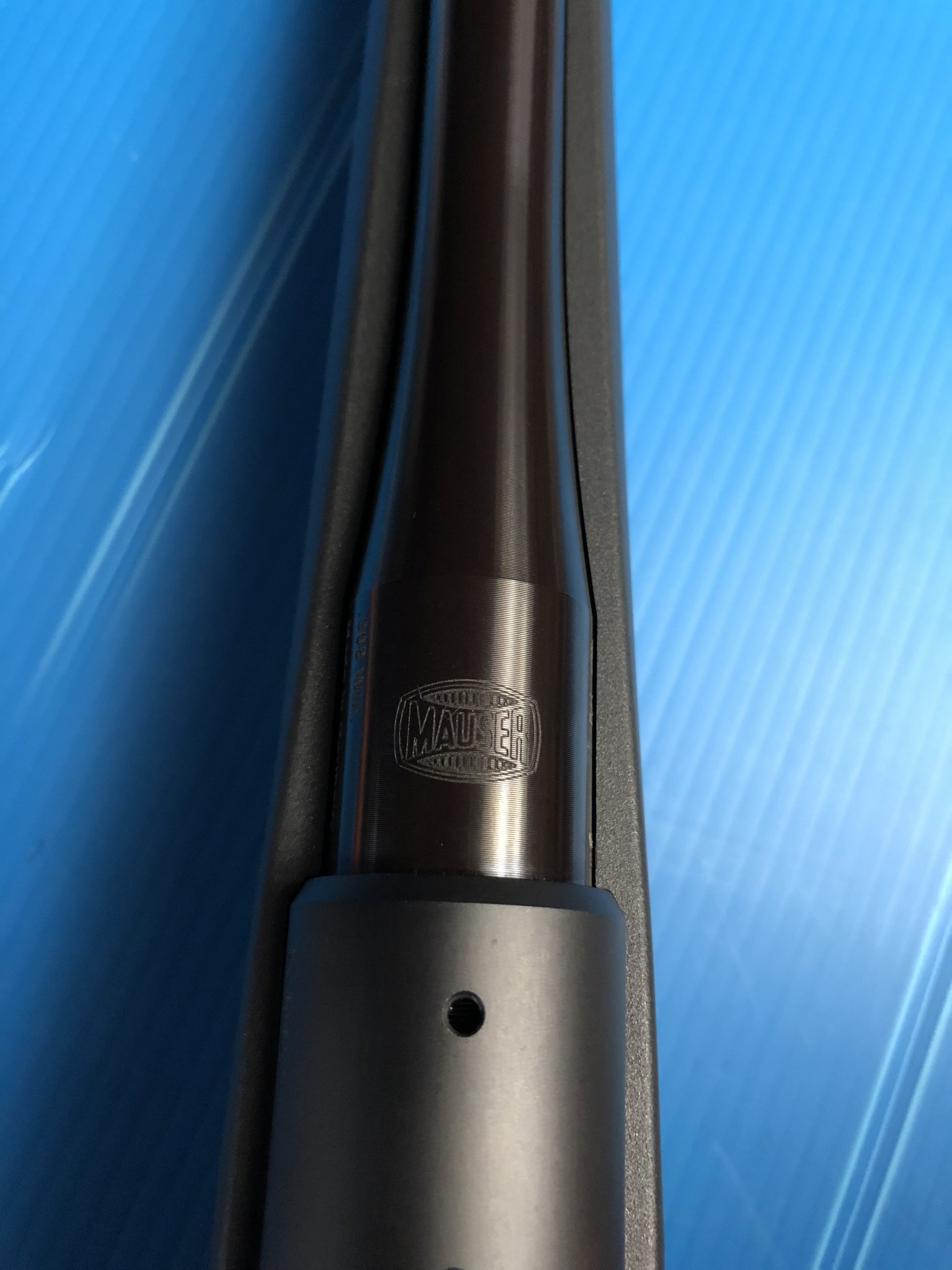

@+- 600 US dollars this rifle is very nice. The machining on the action and bolt are very well done. The bluing on the barrel is nice and even. The coating on the action is evenly applied. The finish on the bolt did wear fast but is very slick. The bolt shroud and knob are composite and that may bother some but they seem quite sturdy. The stock is also composite but has a very nice feel and seems like it’ll take a beating.
Function

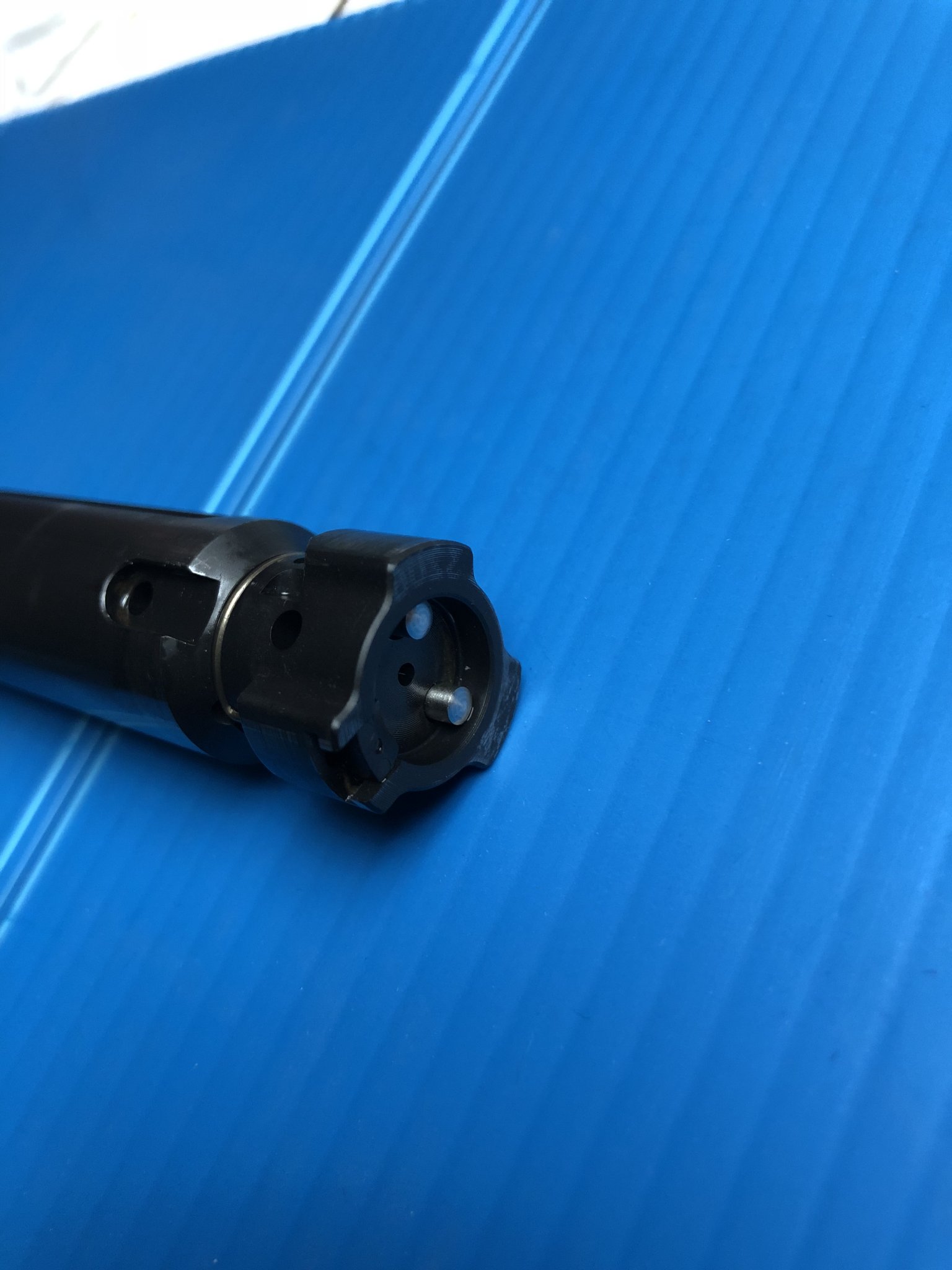

The M18 bolt manipulation is super slick even out of the box. After a couple hundred manipulations it is amazing. Keep in mind this is a long action 308. The safety is a 3position: LOCK/SAFE, SAFE, FIRE. It feels nice. Moving to fire can be loud if you’re a hunter but if you stay on it you can make it almost silent. The single stage trigger is adjustable and from the factory mine came set at an average of 3lbs 3oz over 5 pulls. The trigger has no take up and no over travel. Total trigger movement is a about 1/16th inch. The single magazine that’s included is polymer and has an internal OAL of 2.874. The magazine release button is out of the way and you wont be accidentally bumping it, it is difficult to find but easy enough to depress and retains the empty mag so you can pull it out. Buttpad is easily removable and there is a small storage compartment in the stock. There is supposedly different lengths on the way to accommodate different LOP. Factory LOP is 14”.
CONS:
For the record I think this rifle is exceptional at this price point however there’s a few things that Mauser needs to address.
Twist rates. While the 1-11 308 is fine they should be doing 1-10. I really want the 6.5 creedmoor but the twist rate was 1-8.77. I shoot 147 in 6.5 and I didn’t want to risk unstable projectiles. Mauser if you are listening give us 1-7.5 or at least 1-8 for the 6.5 Creedmoor.

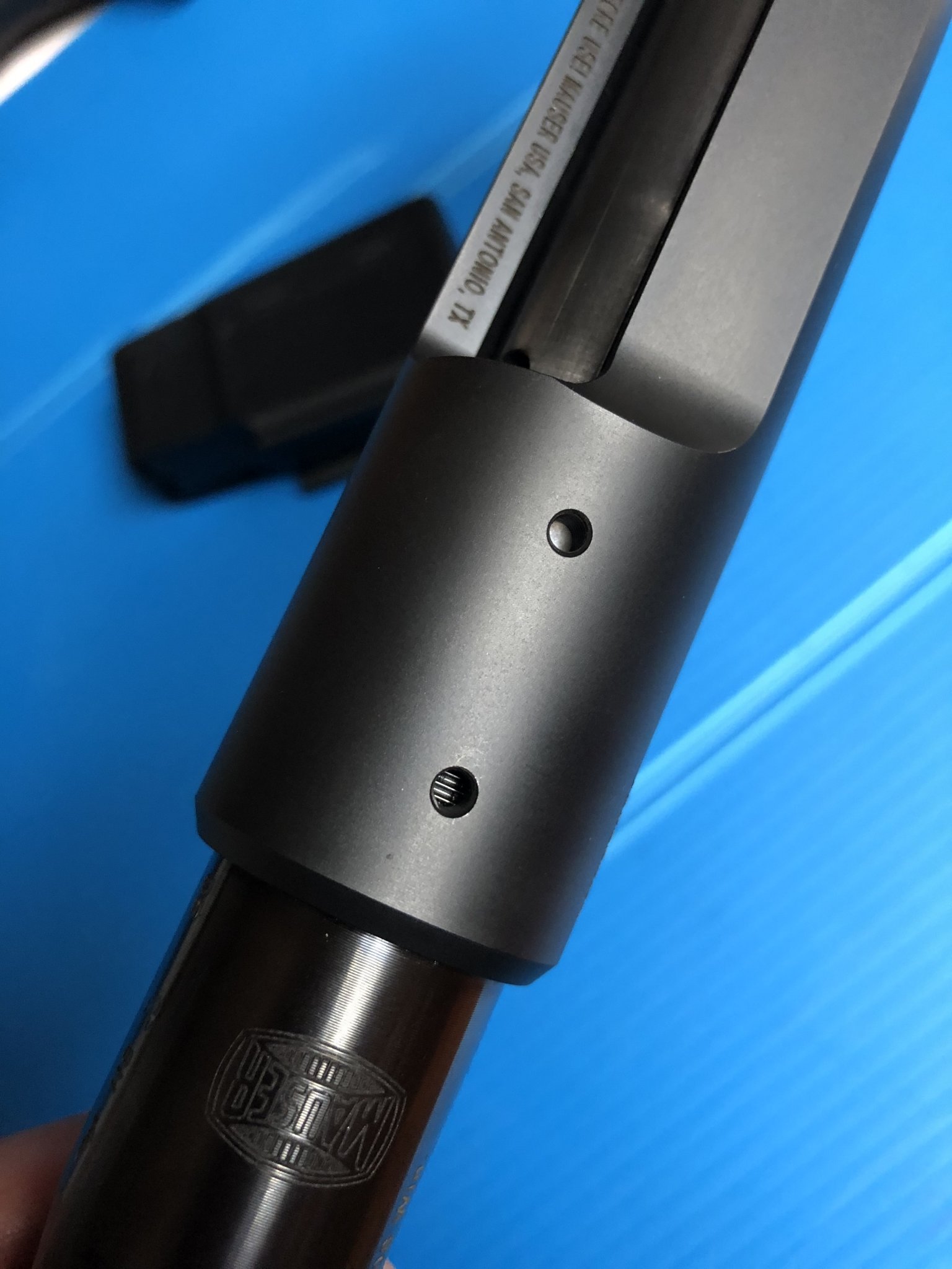

Scope bases. While Mauser did machine the m18 action to Rem700LA geometry and hole placement they goofed a little on the ejection port and screw size. So the front edge of the ejection port is cut away enough to not be able to utilize the integral recoil lug on any of the common bases (NF, badger, etc.) I wouldn’t feel so bad about this if the screws were the bigger 8-40 type. But alas we are given 6-48 screws. Perhaps I’m over thinking this but I bought this rifle as a true beater gun and the 6-48 screws dont give me the warm and fuzzies without a recoil lug.
Plans:
This weekend Ill be chopping the barrel to 16 or 18.5 and threading. Ill do a shooting review to follow.

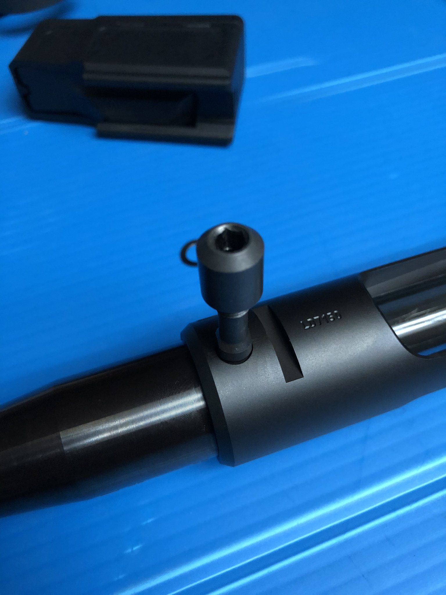

Actually no. Its a weird trigger....I had to disassemble and polish it a tad to smooth out the takeup.
IIRC that only loads the sear. Don’t mess with it.
Correct. I messed with it just out of curiosity and it directly impacts the bolt lift and the point at which the cocking piece/sear engage. I had to spend a little time opening/closing bolt to get it to where it needs to be after I turned it in/out a couple times playing with it. It's a neat feature for them to be able to get it set up correctly so you don't end up with issues like both of my ARC actions had where you have to file the cocking piece. Unless you have something weird going on with your bolt I wouldn't mess with it.

Mine is shaving brass off the case head when closing the bolt. After a few rounds enough has built up in the bolt face I can’t close the bolt on factory ammo. Is there anyway to adjust the extractor?

I own one which is being rehomed to Mauser. It is a 6.5 PRC and is Not a MOA or even close rifle. I did a 100 round break in on the barrel over a month + and at 120 rounds the bolt was engaged on the lugs by the sear and the entire firing pin assembly and shroud came out while in the receiver. It has multiple design and safety flaws. It also shaved brass off the factory load cartridge base like crazy. The so called “Storage Space” is a gimmick which precludes ever shortening the stock for a small frame shooter. At best it’s a 2-3 MOA rifle with factory loads and I wasted a month plus and about $1500 because I believed all these articles. I could have purchased a good used Rem 700 for about $400 and been able to trust it to give to my Grandsons. This Rifle is going back to Mauser and Bless Their Heart.

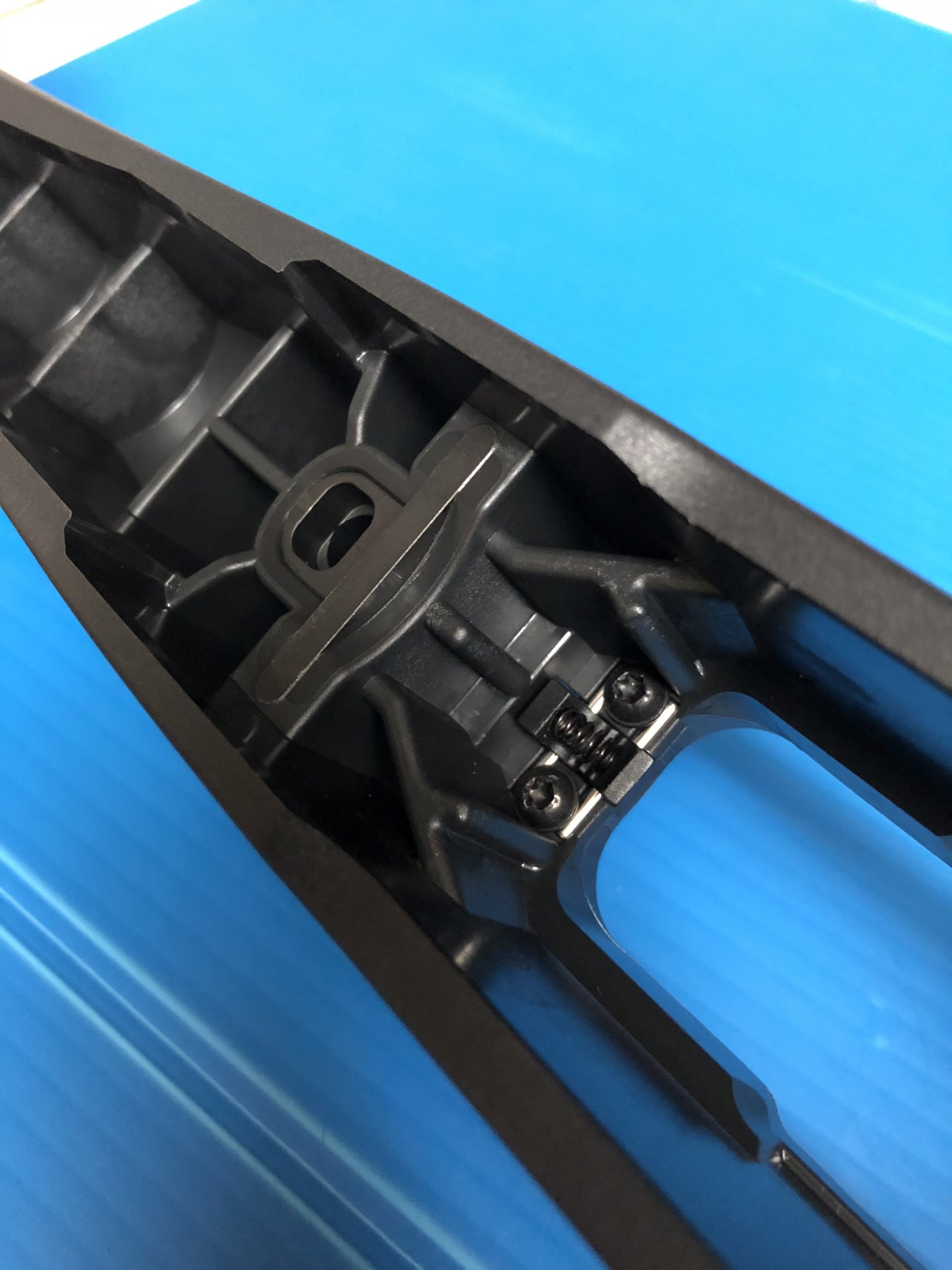

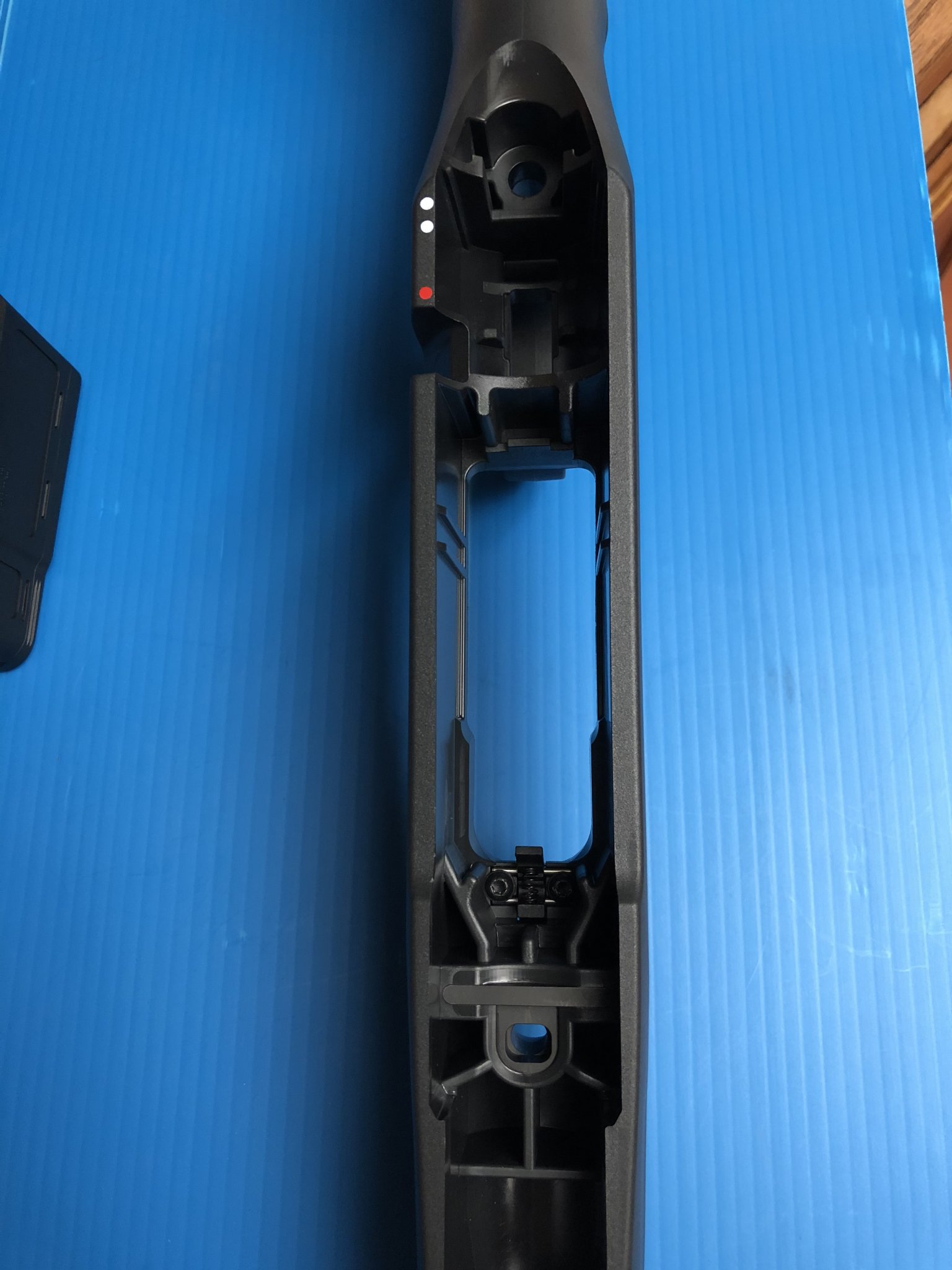

1. Excessive use of polymer. There’s polymer EVERYWHERE... looks like pretty much all PA6GF30. Knob on bolt and shroud are both Polymer... trigger and trigger housing, and stock. I mean honestly it’s probably not a big deal and will last as long as the rifle.... it just doesn’t FEEL like it if you know what I mean. Honestly the amount of ‘value engineering’ is impressive. surprising that they were able to pack this rifle into the price point.
2.LA footprint. Not a big deal, just not super thrilled about this.
3. Stock. Is sorta flimsy and definitely can touch it to the barrel. Will probably bed this at some point and add some reinforcement to firm it up.
