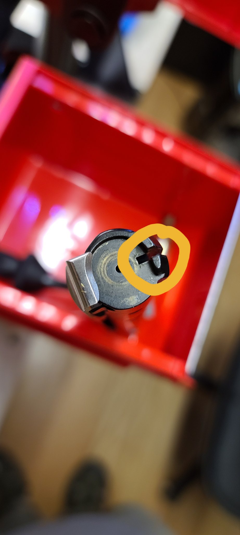

I'm about to start a load workup for a Mausingfield M7 action.
My standard procedure is to start low and move higher watching for signs of pressure and load below that maximum.
Will this work with the Mausingfield bolt head and ejector design?
No ejector marks to look for obviously and I'm wondering if the bolt head design might make stiff bolt lift not a good pressure sign.
Just switched my MF to 7 SAUM, and going to push some loads until I get pressure signs of some type (I hope). I plan to look for primer crater and flattening, and I think you would see some flow into this area:
I agree. You will experience stiff bolt lift and brass flow into holes in the bolt face just like other bolt designs but case extraction will be easy.
