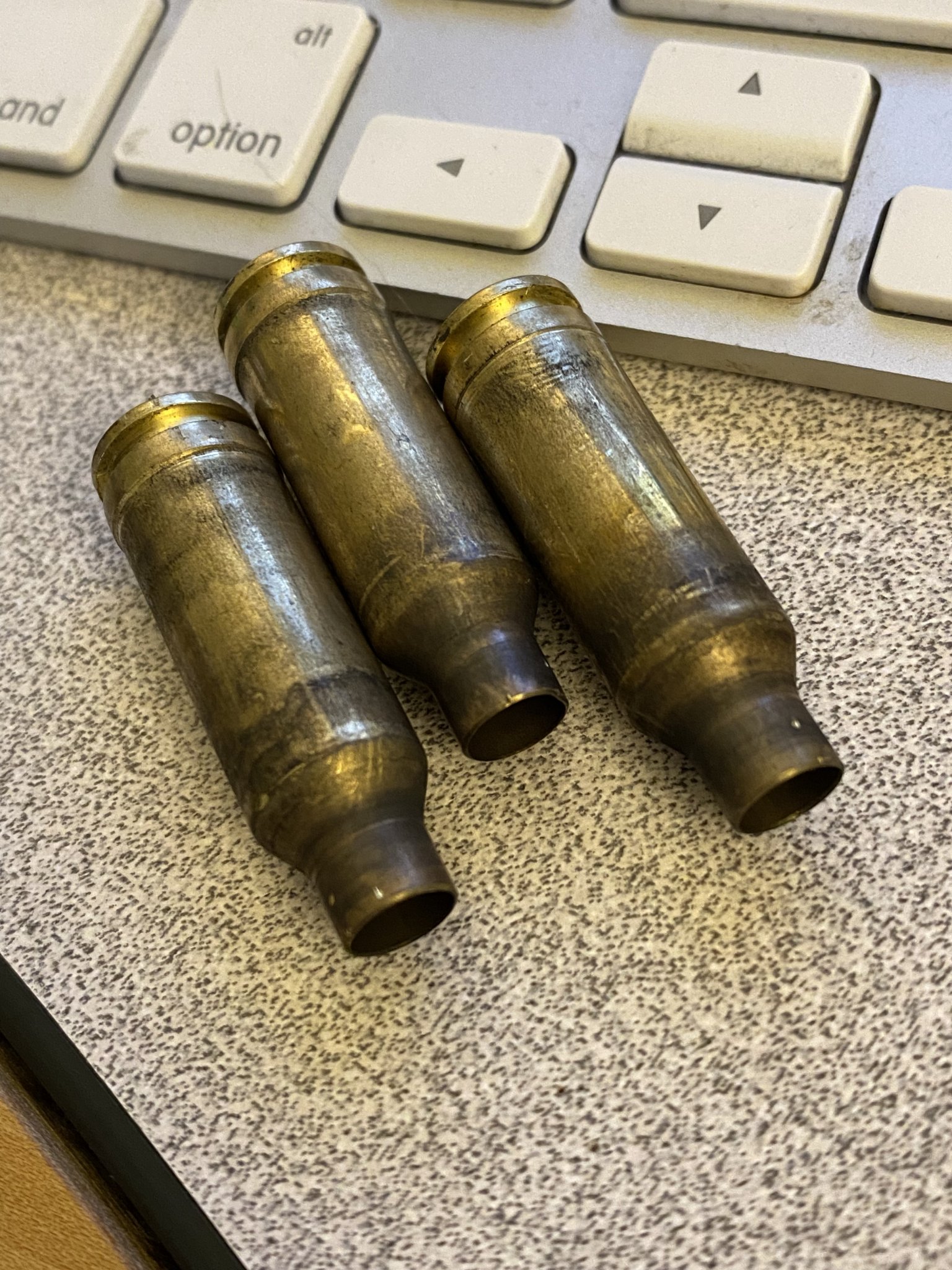

Not only that but AR barrels have a larger chamfer at the breech, that coupled with the thin brass at the bottom will expand into the chamfer and the cases come out looking like a Grendel belted magnum.
Reactions: padfoot 37
People have told me otherwise but haven't produced a picture of it yet, but as far as I'm aware that problem is specific to Lapua cases. If you look at a cross section of them they have thinner webs and the shape of their final draw has less radius in the corner.
Try it. Take the normal charge that creates apx 52000psithen start adding. An extra gr of powder may increase the charge 3-5000psi. Try it and measure the cases. . https://www.snipershide.com/shooting/threads/grendel-like-belted-magnum-problem.7112215/ First, guy says he is using Hornady then says Lapua.
With Lapua cases, yes. Others I have not seen it. There's (off memory here) about .080" worth of pure sidewall taking the brunt with the Lapua cases and if memory serves it's about half that much with Starline or Hornady. It has to do with the web thickness and transition to the body.
