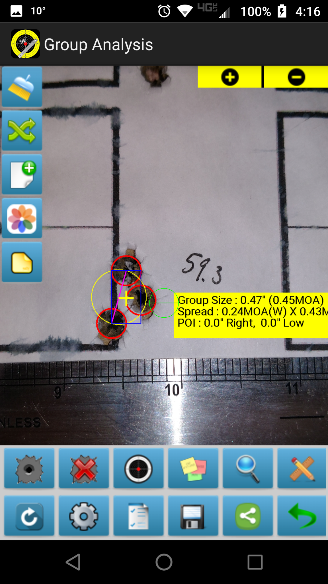

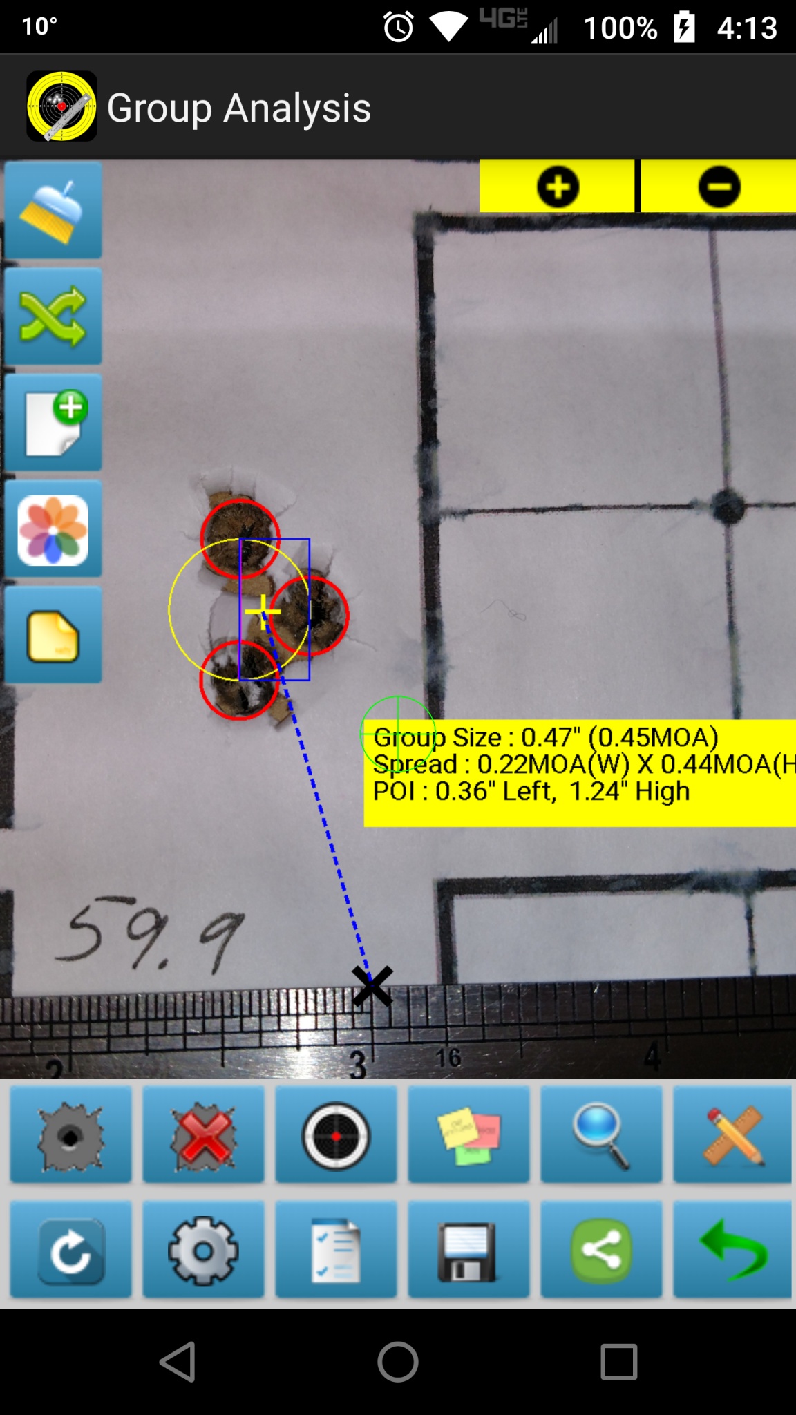

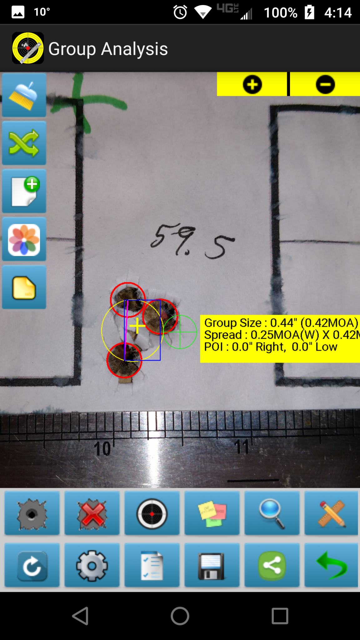

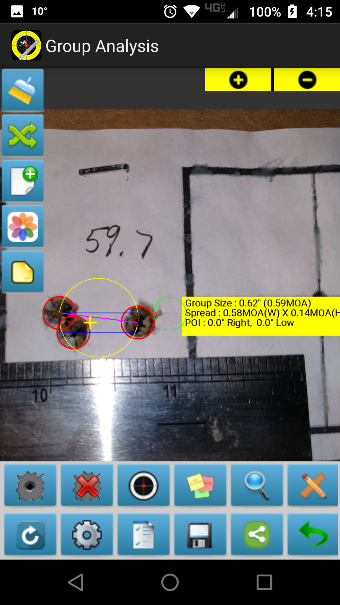

    So, I got this put together and then decided to cut my finger off with a skill saw. Now that the finger is healed (well, it's hanging on by itself), figured I'd get back to load development.

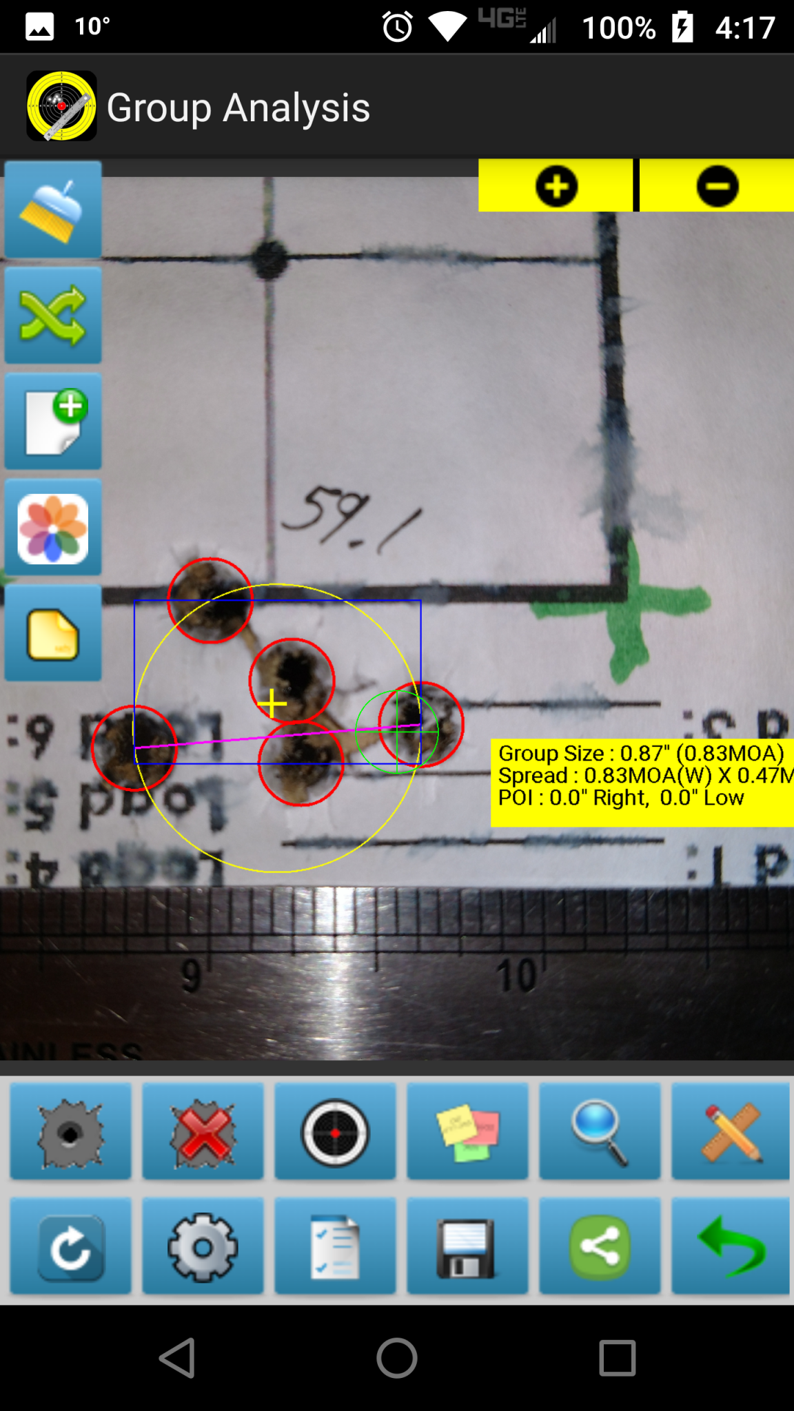

    24" 25-06 1:7 twist remage, on untouched 60's era 700 with a tuned factory trigger and bedded factory wood stock.
    All groups were shot with sig SRD762 suppressor.
    Shooting 115 nosler bt (factory seconds), .010 off the lands, and retumbo with WLR primers in r-p brass.
    Showing promise. It's got about 70 rounds through it now. It was 10* and blowing snow today, but the Chrono says 59.7-59.9 were all close on the velocity so I'm thinking I'll settle there.

    I've also had PM's asking about performance, figured I'd just toss something up. Even though they are only 3 shot groups, I've yet to find a load that goes above 1 moa.

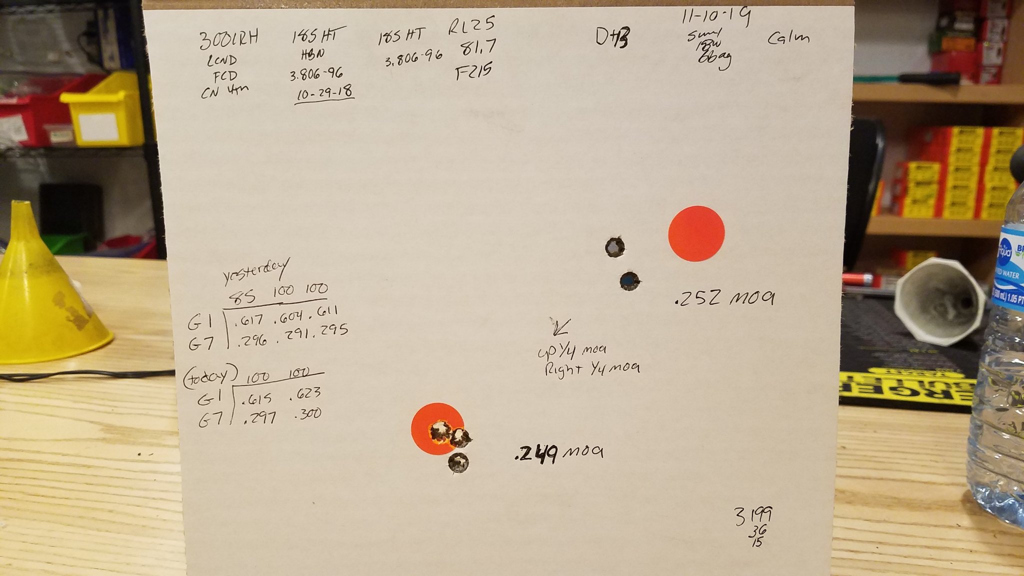

    1/4 moa at 200yds from a bull bag, not on a full bechrest. 26" Mcgowen 300wm 185 Hybrid target. Usually shoot 5 shot hroups but this was re-zeroing a scope for a hunting trip next week.

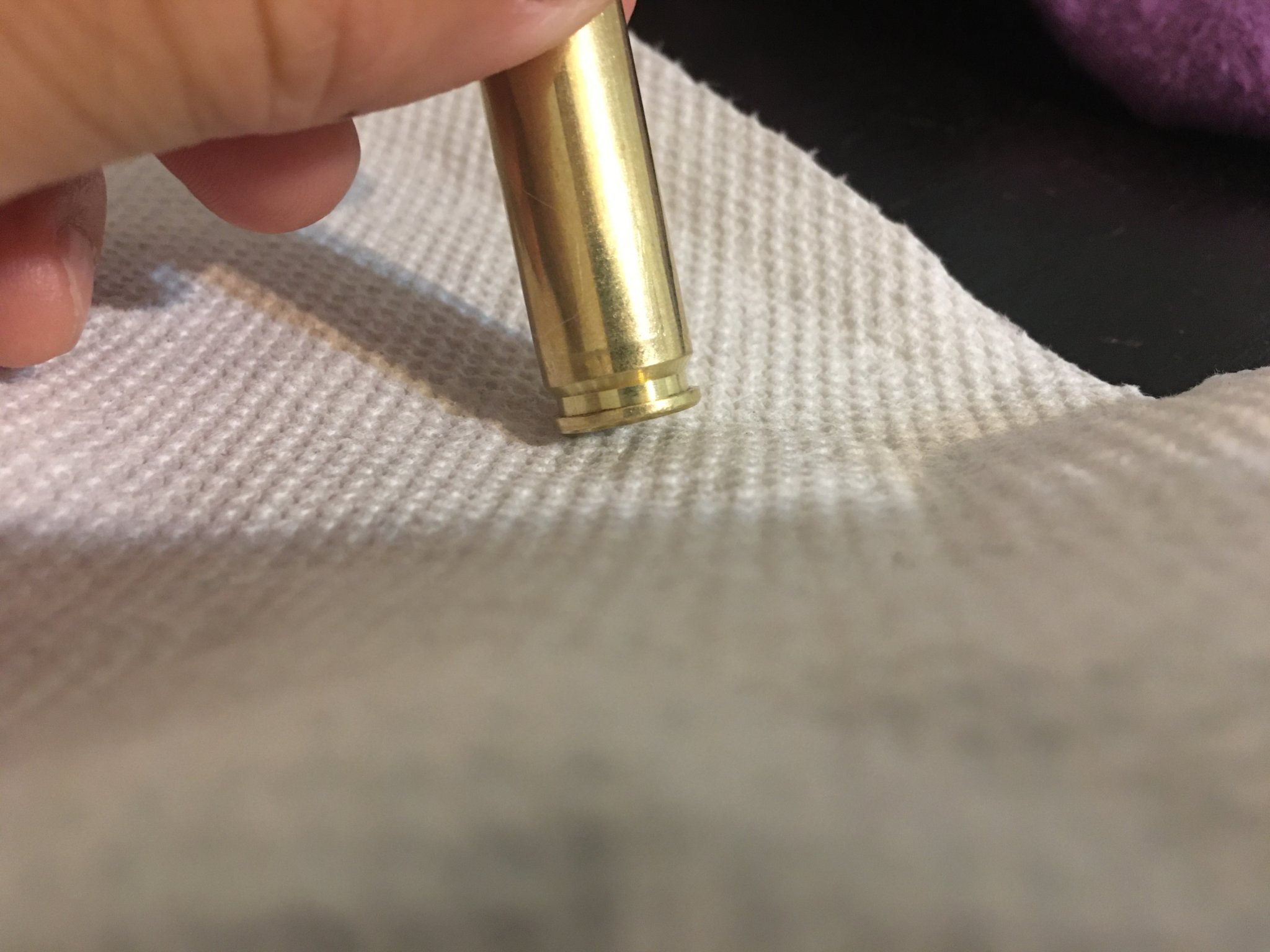

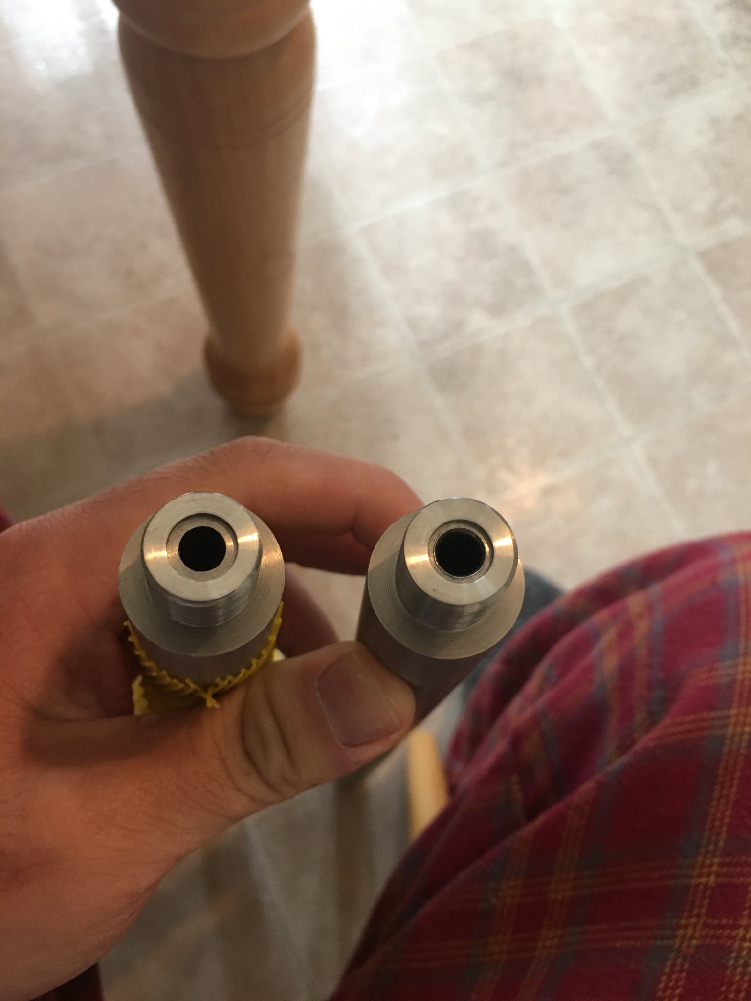

    I have two. Both 6CM Impact prefits by McGowan. Have only installed one of them. It did not like 109 LRHT but shoots 107 Sierra and 105 Hybrids very well. I had my best 2 day match finish with it. The headspace is just a tad long on it and stretches brass by the base. I can feel the line with fingertip. The other came with a large burr on the crown. I will need to get that fixed before installing.
    Would this prevent me from ordering another? No but I don’t think you get the same attention to detail as you would a custom smith.

    That stretch is not too bad, just set your die appropriately so they're not getting stretched every time. If you have trouble getting that brass to chamber in another barrel, run it all through a small base sizer.

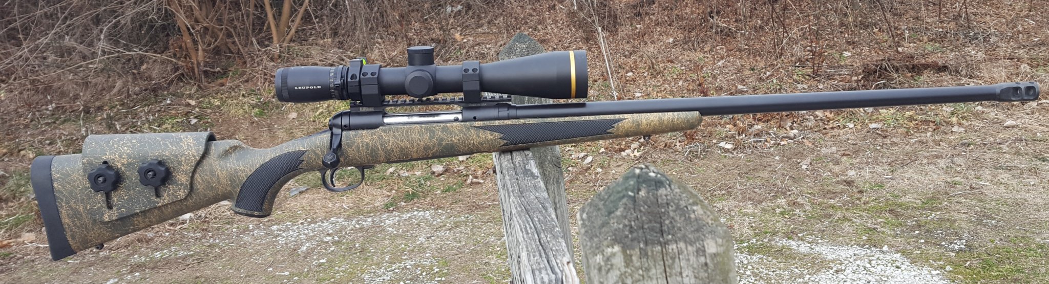

    Just built a .300 WSM hunting rifle for a customer and it put all the bullets into one hole with one of the loads during development (none over 1/2 minute). Literally, a couple tenths. Never had an issue with any of them.
