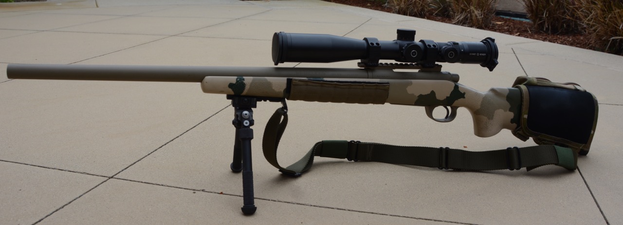

Here's a GAP 308 with McMillan M40A1/HTG stock and a S&B 4-16x42 on it mounted in Seekins low rings. As you can see, if you could get lower rings you could mount it lower but these are lowest rings that Seekins makes. Also as you can see I use a Triad stock pack to raise the cheekpiece.
Thanks for the reply!
I was really hoping to get by without a cheek pad, guess we'll see what happens. I'm gonna use ARC X-low rings and it'll be on a Defiance Deviant.

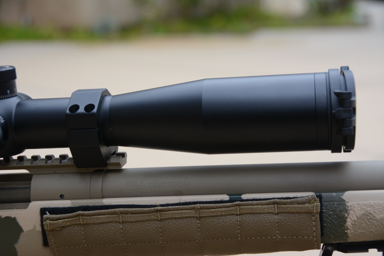

Here is an Win M70. After this pic was taken, I went to a standard set of low Leupold DD rings that cured the problem you are anticipating, but did prefer the additional 20 MOA adjustment the rail provided so it is back to this configuration with a Triad Stock pack that is working just fine.

Thanks for the replies guys. That is kind of a bummer, I was hoping not to have to figure a way to add height. I guess we'll just have to see how it all mates up. I have a pretty cool idea for adding some height that I haven't seen before, so maybe I'll have to explore that. Maybe I'll get lucky though. Thanks for the help!
