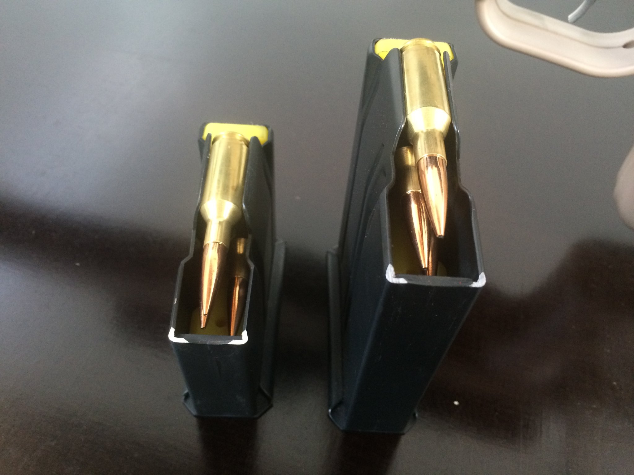

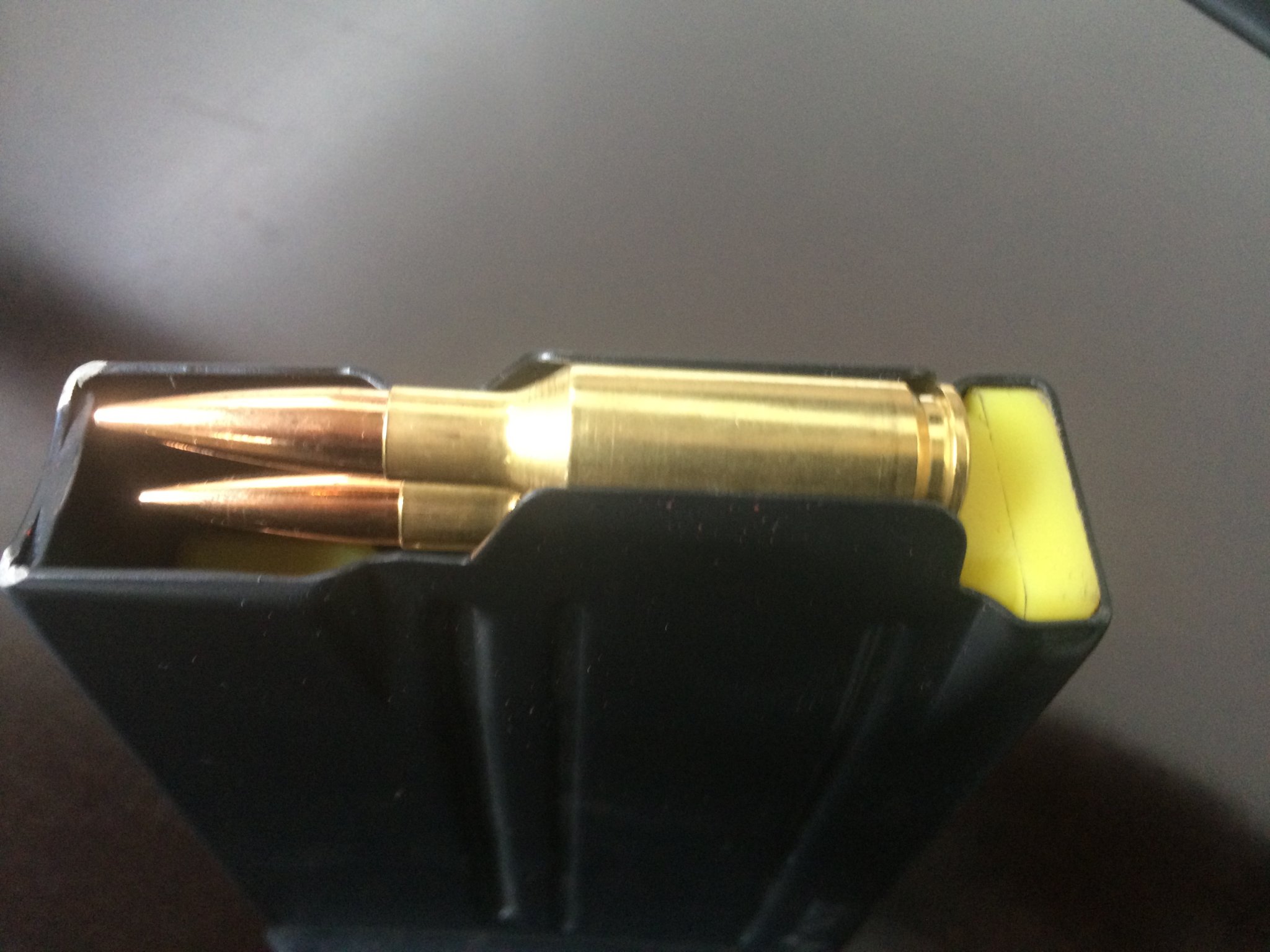

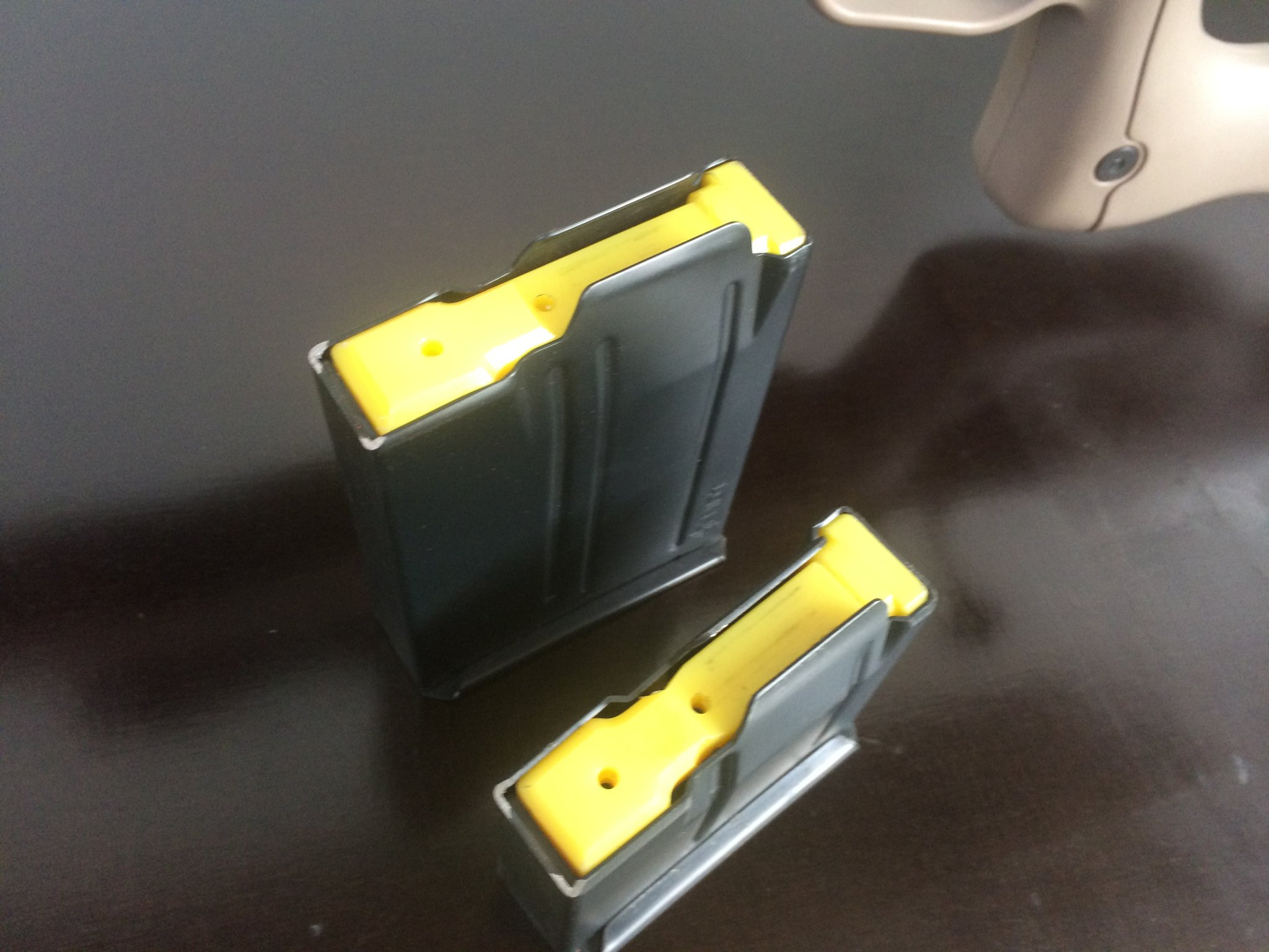

I made some insides for a 5 and 10 round MDT mag last week for my Tikka, I've been using the HRD AW kits in my other rifle with a Stiller action but obviously the AW Mags don't work in the Tikka. I used the original spring, just made new followers and a spacer for the rear. To this point they feed beautifully and there's no issues with the follower cocking or the rounds nose-diving. I haven't riveted the spring on yet but it doesn't seem to make a difference. i did need to snip a little bit off the end of the spring in the 5 round so it fitted well, the 10 round just worked straight up.
7052068
7052070
7052071
I gave these mags a run today and had no issues, definitely not a torture test but both fed as smooth as butter. Given the price in Australia of the MDT mags is about half what an AI mag costs, they would be my pick. If MDT sells them already set up, even better.
Only issue I ran into was with the 5 round, the baseplate wasn't folded as flat as the 10 round one and wouldn't clip into the AICS magwell before the baseplate hit. I flattened the fold in the mill vice and that fixed it, took all of a minute or so.
