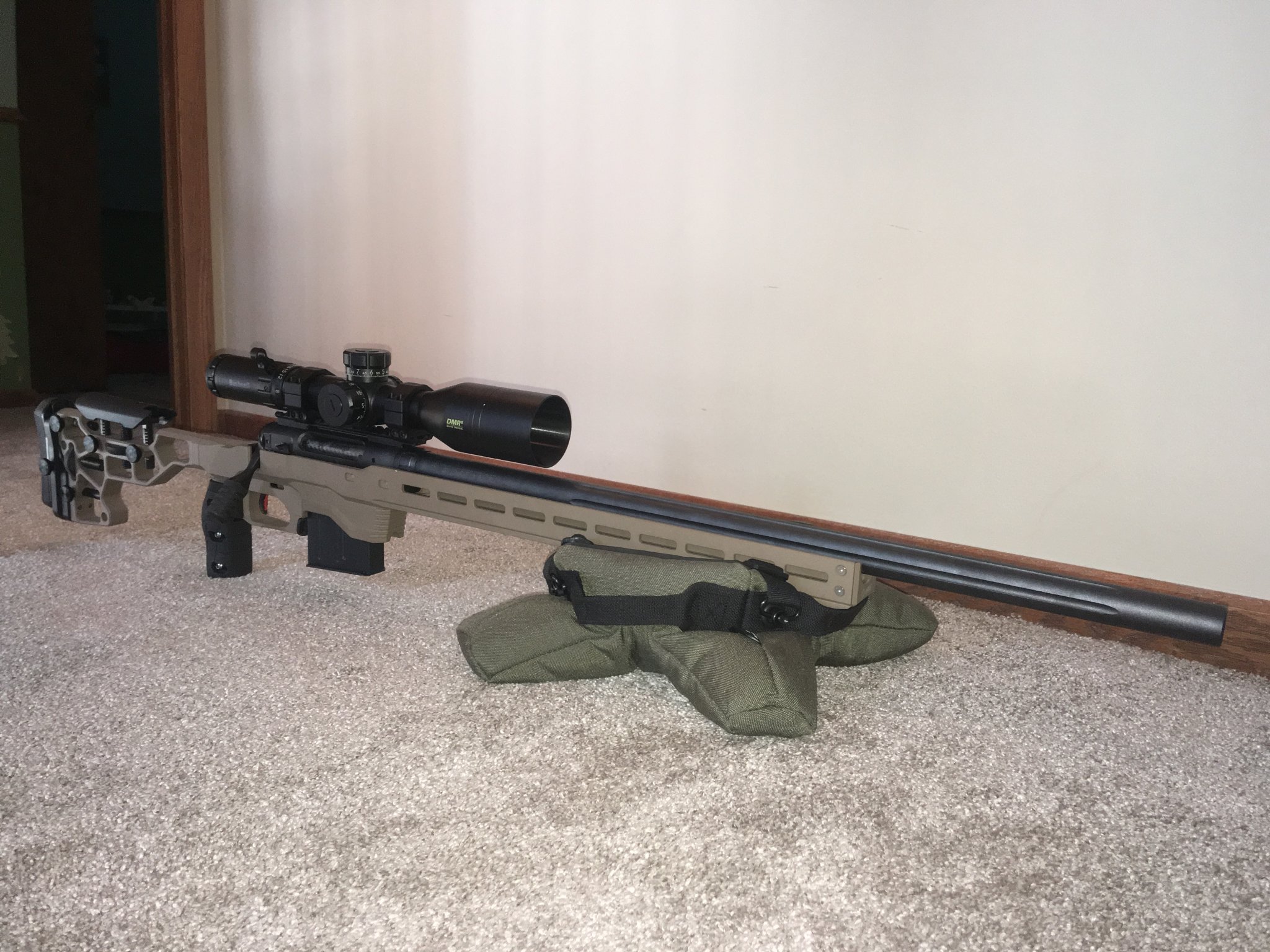

Savage 10 FCP-SR 6.5 CM in an MDT LSS-XLGen2 chassis:
Took me 5 minutes to get it set up. Stupid simple and rock solid.

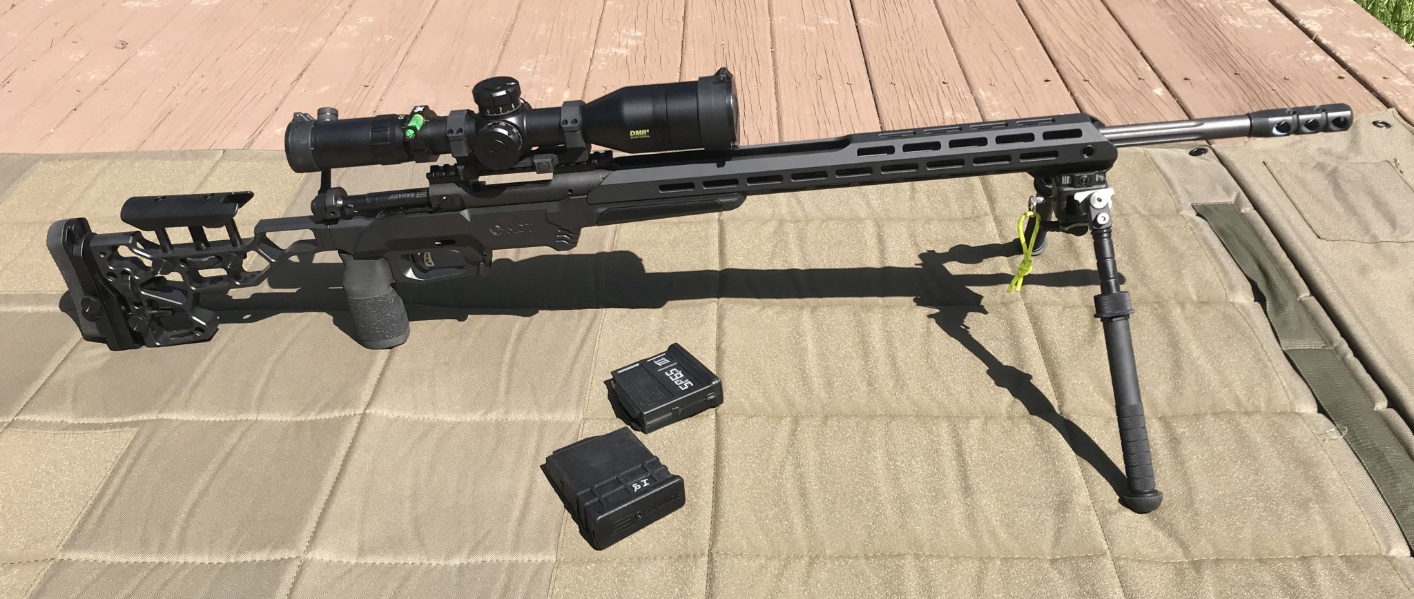

I actually got the MDT LSS- XL2 on a black Friday deal for a Savage SA10.
I'm a lefty so I had to cut the chassis for the bolt handle.
I did have a problem with the mag well.
Basically the mag well sets the thickness of the backing plate forward . So beings I removed the backing plates from the mags the tips of the bullets ride under the action and would not feed. Reluctantly I moded the feed ramp with a dremel tool.
Everything is fine but wish MDT would have moved their mag port back a bit in design. I don't have the plates anymore but I think they weren't more than .100"

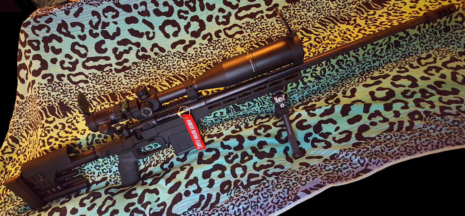

I put a Magpul PRS gen 3 on it for now.
