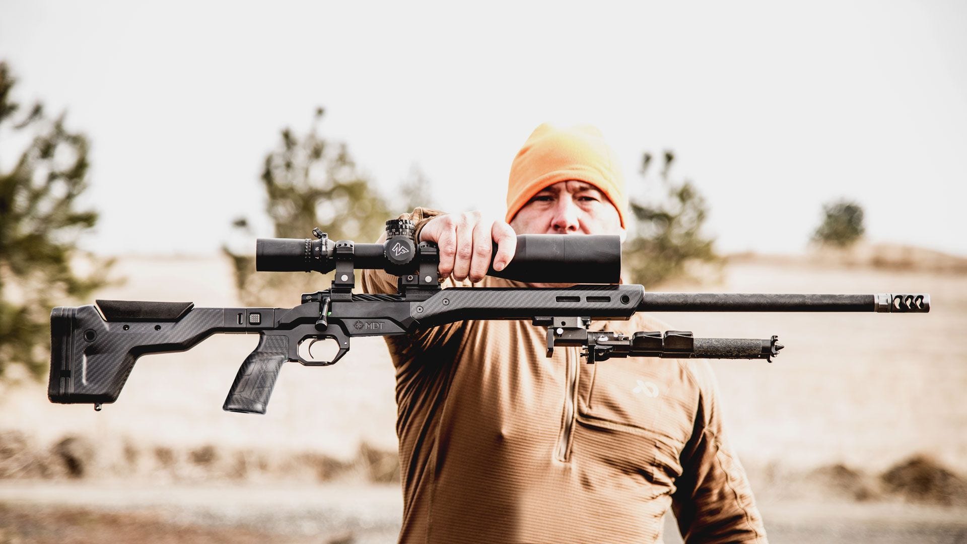

Feature list:
  • Chassis body machined from AZ61A magnesium alloy
  • Fixed and folding version available
  • Ultralightweight design weighing between 26oz and 31oz depending on configuration chosen (folding version and ARCA version increase weight to the high end of this scale)
  • Foam filled carbon fiber buttstock deadens sound, vibrations and felt recoil
  • Carbon Fiber components provide warm to touch feel
  • Designed to diminish snag points and provide superior ergonomics
  • Low profile mag latch integrates seamlessly into trigger guard
  • V-Block bedding system with free floating barrel
  • Will accommodate barrels up to 1.25” diameter
  • Compatible with AICS style magazines
  • Front and rear QD
  • Front and rear sling swivel mounts
  • Vertically adjustable cheek riser with soft touch foam pad

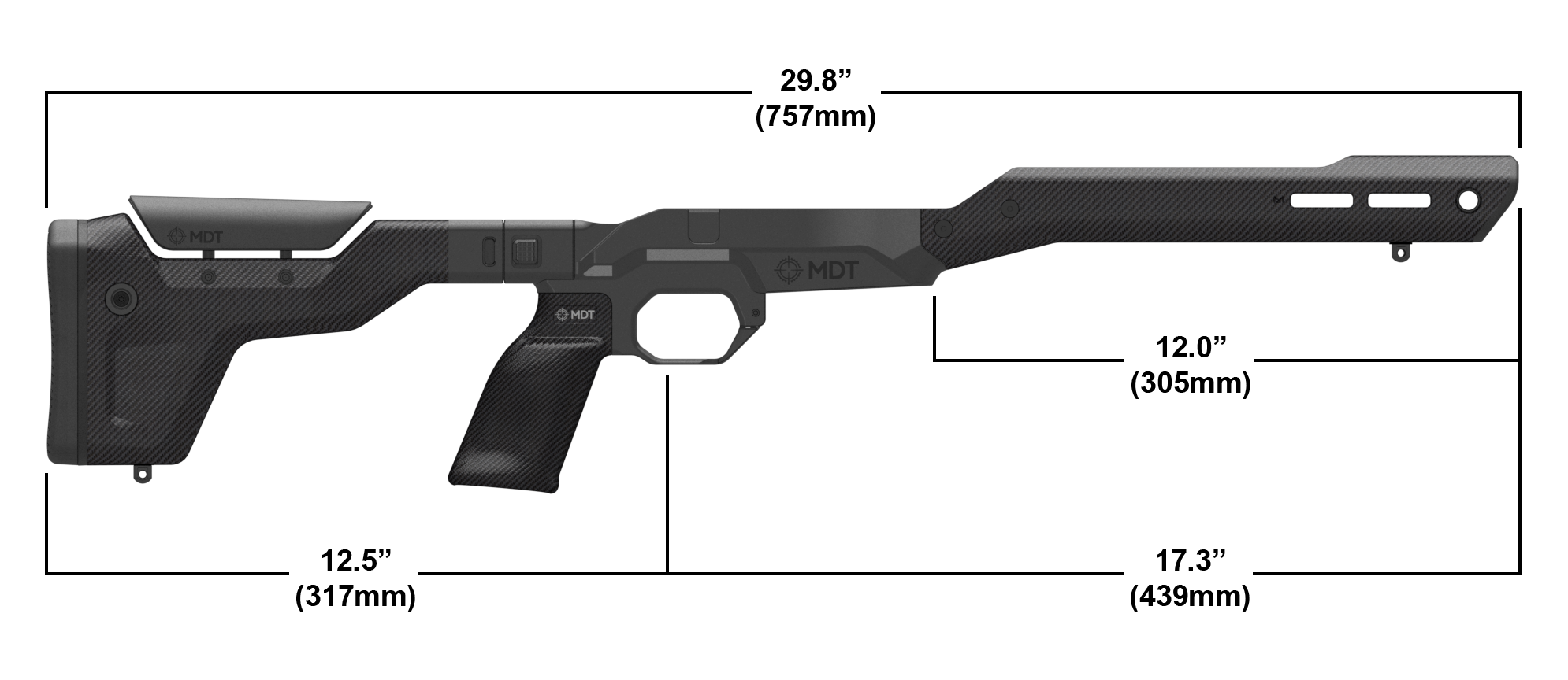

  • 12.5” minimum length of pull with adjustable spacer system
  • Accepts most AR Grips but specifically designed with ultra lightweight Carbon fiber grip just over 1oz
  • Carbon fiber enclosed forend with MLOK, QD mount, Sling Swivel Mount
  • Cerekote finish in either Black Carbon Fiber or Cobalt Green
  • Titanium action / grip screws
This just might be the perfect hunting chassis for my Tikka Lite! Are there any pictures of the forend with the integrated arca or the Cobalt green version of the chassis? And is the LOP the same on both the folding and non-folding variants?
New pictures will be coming as we get closer to shipping but yes, the LOP is the same on folding and non folding!
