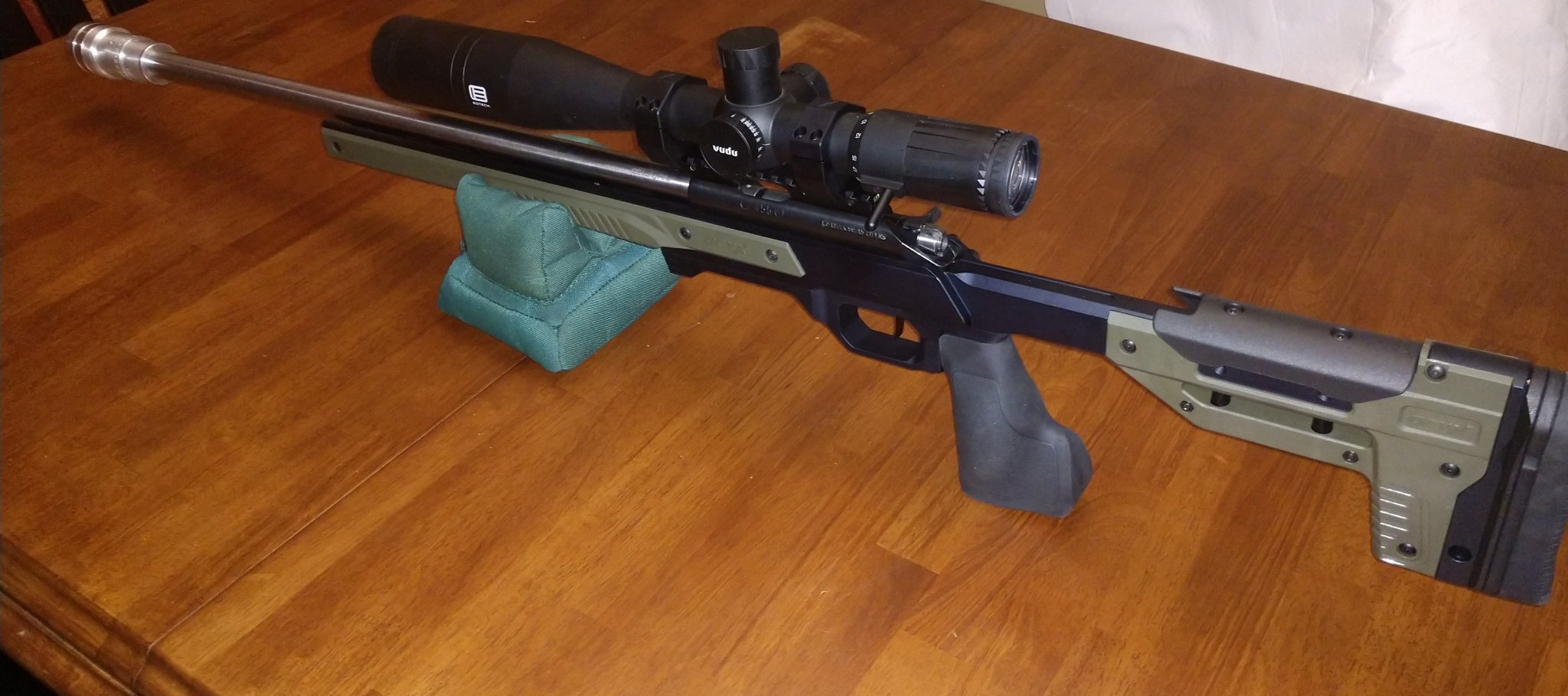

My Black Friday special showed up today for my CZ 455. It looks great, fit is perfect, etc. I put my TLC grip on it and it's almost ready to go, I'm just waiting for the RRS rail to come out.
Edit: I'll need to buy the LOP extender pack for shooting prone, I should have thought of that because of my orangutan arms. I just put 100 rounds through it to start getting the tuner dialed in, but it's very comfortable. The thumb shelf is a welcome feature.

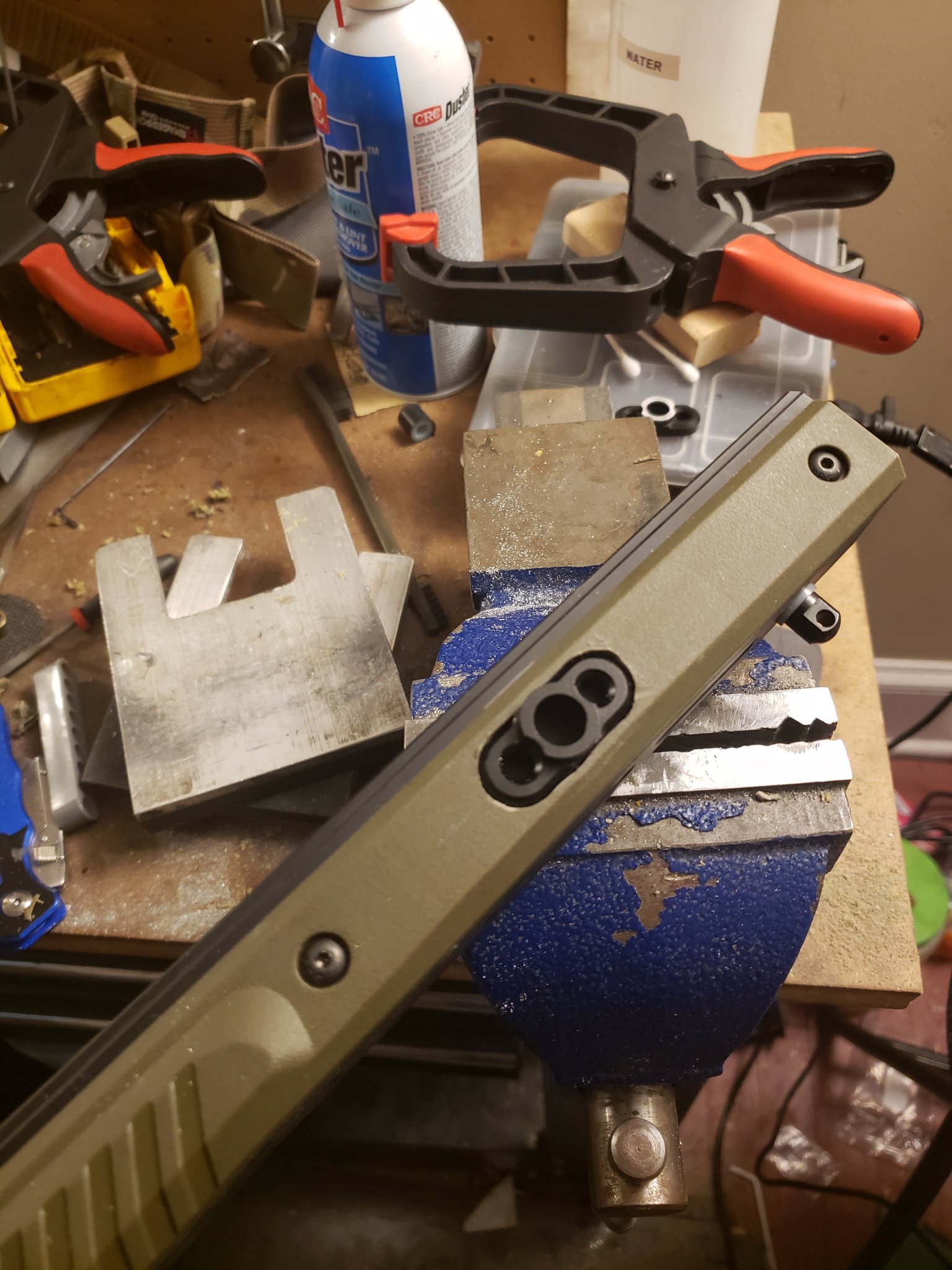

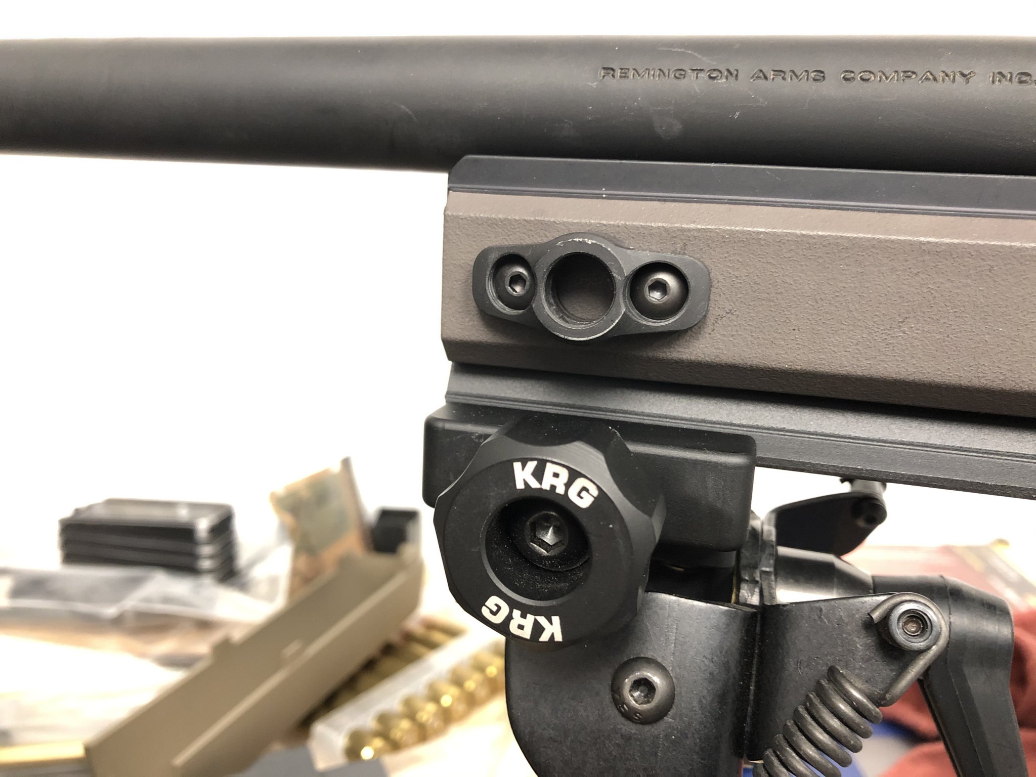

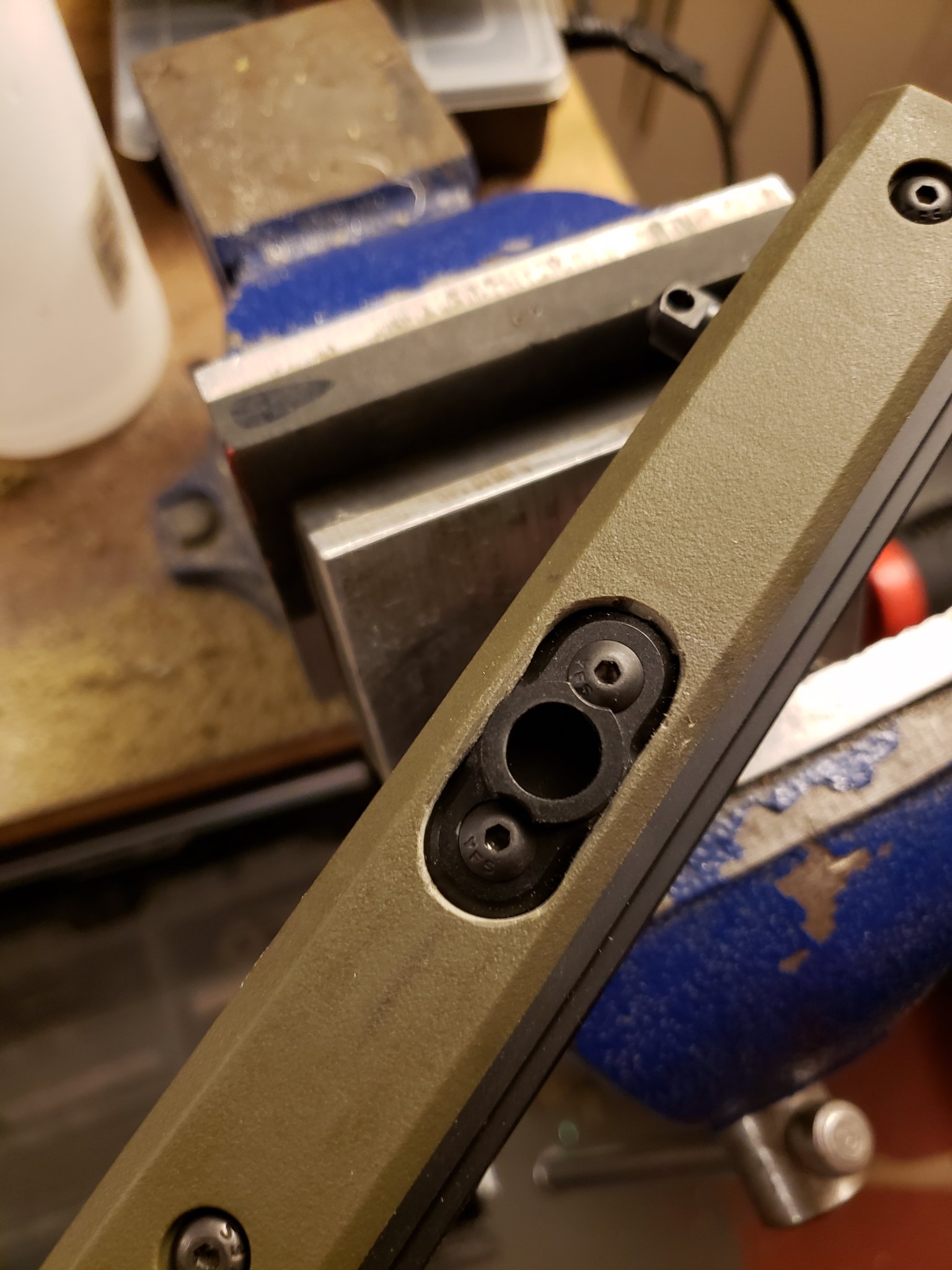

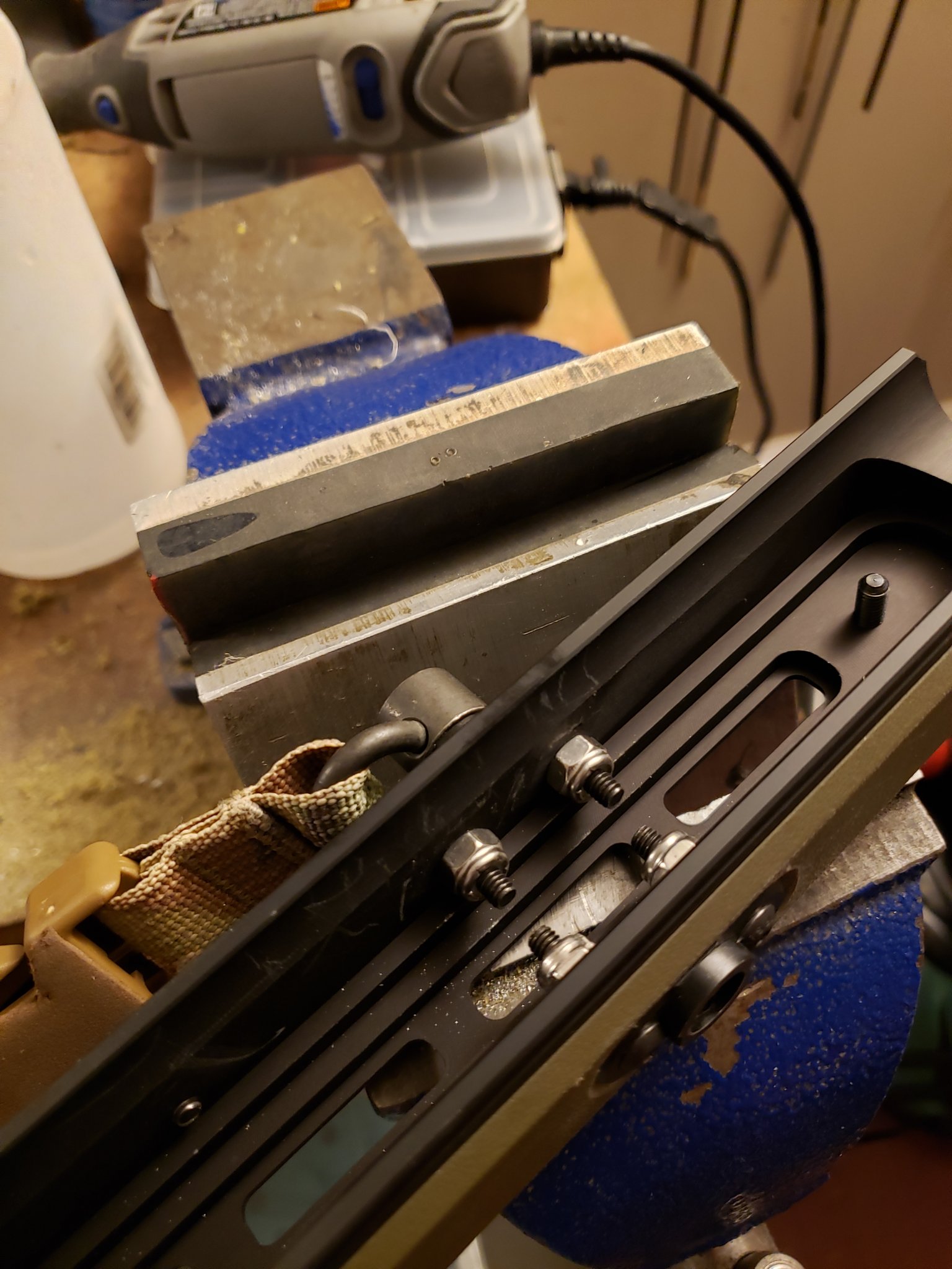

I got the sling mounts installed and I'm satisfied with them. The top of the mount is flush with the top of the skins, just the socket and cap screws stand a little proud of the surface. It'll work for now.
The mounts themselves are some inexpensive M-LOK mounts from Amazon, they were $13 for the pair and sufficed to flesh this out. At first I was going to drill and tap the side of the chassis and re-use some of the hardware but that turned into a no go when I realized that the side of the chassis is thinner than I anticipated. It's threaded to accept the screws for the skins but I played it safe and decided to thru-bolt it with lock nuts on the back since the mount will be under tension. My plan was to pick up some black oxide 8-32 flat head screws so they'd be flush with the mount but that didn't work out, so I used 8-32 button head cap screws. It still works since it keeps the same appearance as the screws that hold the skins on.
Routing out the skins was easy enough with a couple of Dremel bits, the leading edge of the mount is 3" from the front of the chassis and fairly centered on the flat of the skins. The Arca/Swiss plate that I'm going to use should be in tomorrow so I'll get that mounted up too, a little more redneck engineering on the way!

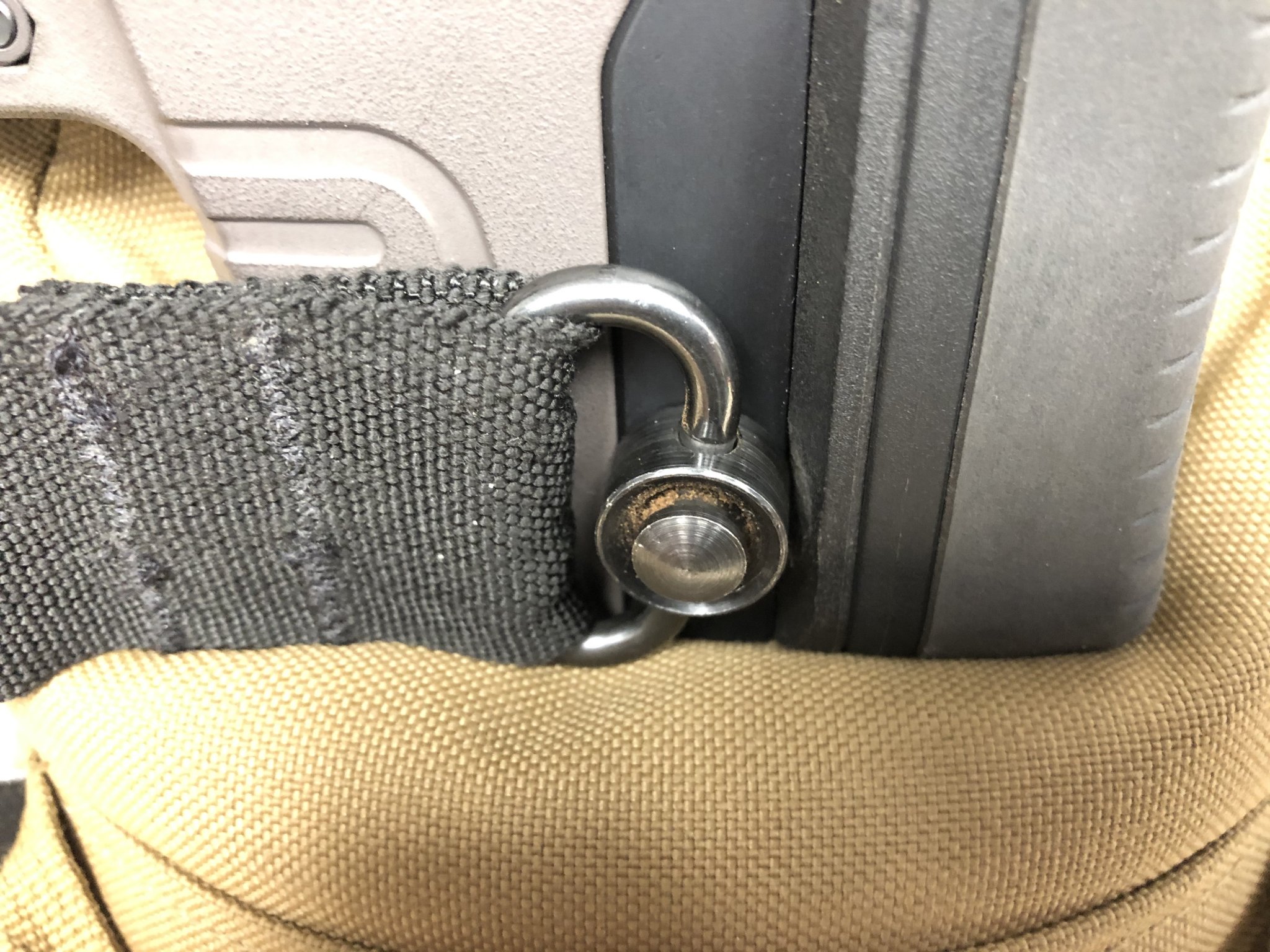

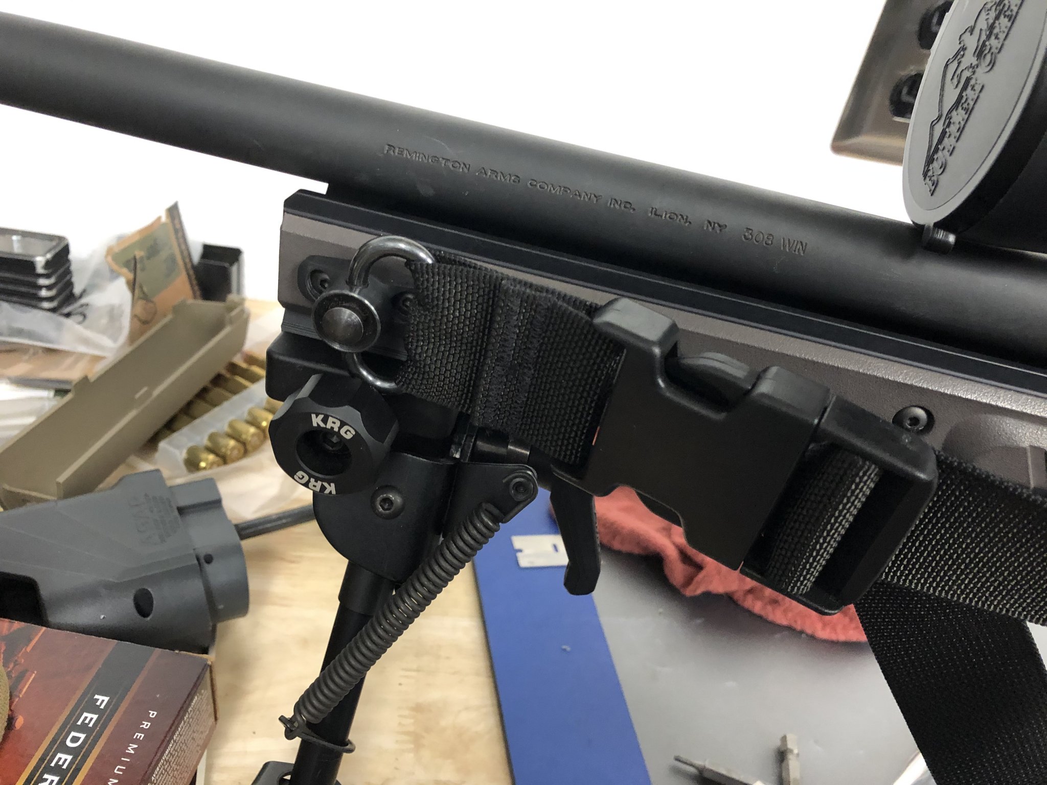

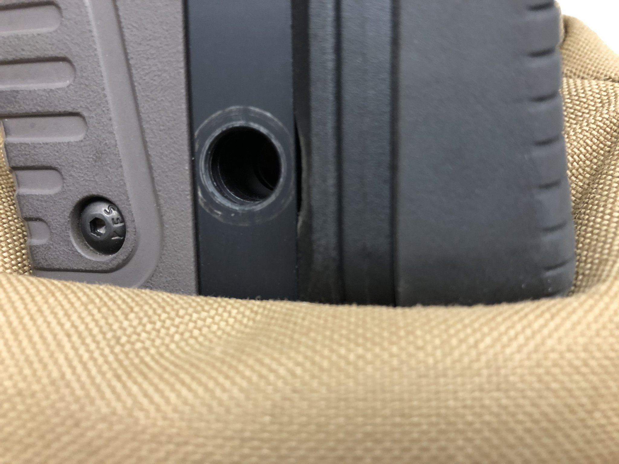

I added a QD cup to the front of my Oryx by using an extra mlok QD(ground the back smooth). The plastic side panel has really good framing behind it so I just used a longer #8-32 bolt and attached the QD outside the plastic. Then just drilled and tapped a 2nd 8-32 hole. It’s rock solid and looks a little nicer than using a dremel on the side panel. I liked how it turned out and figured I would share.
