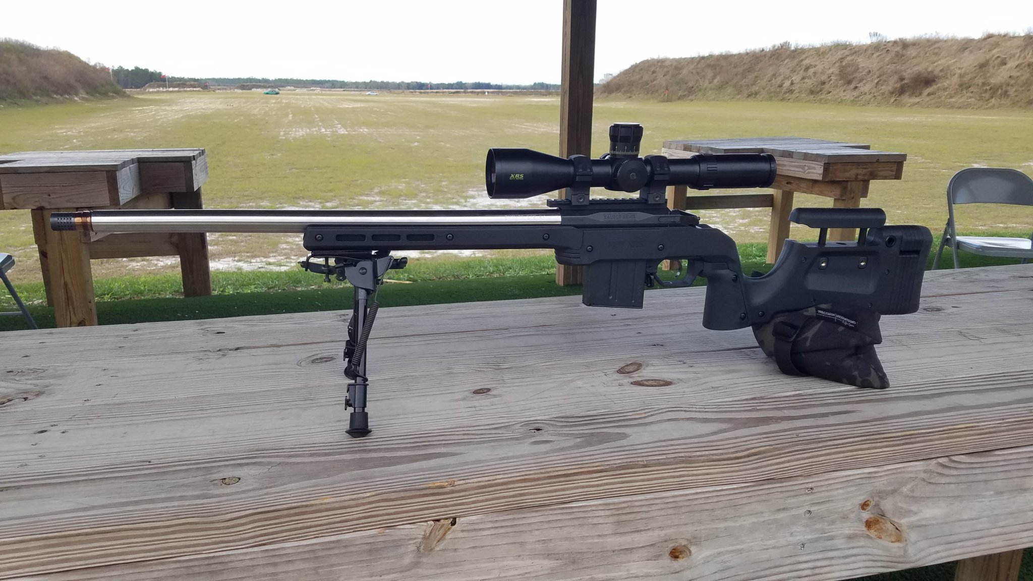

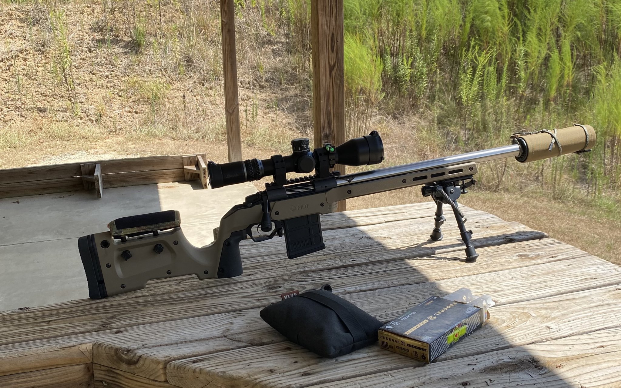

18” MTU

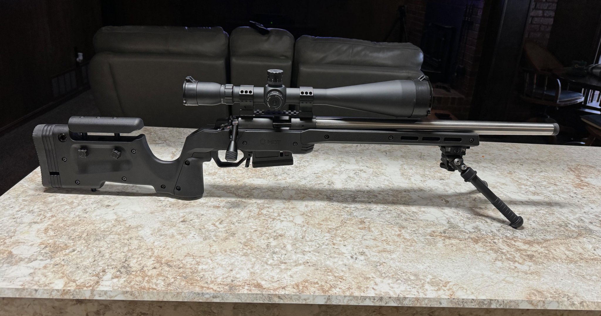

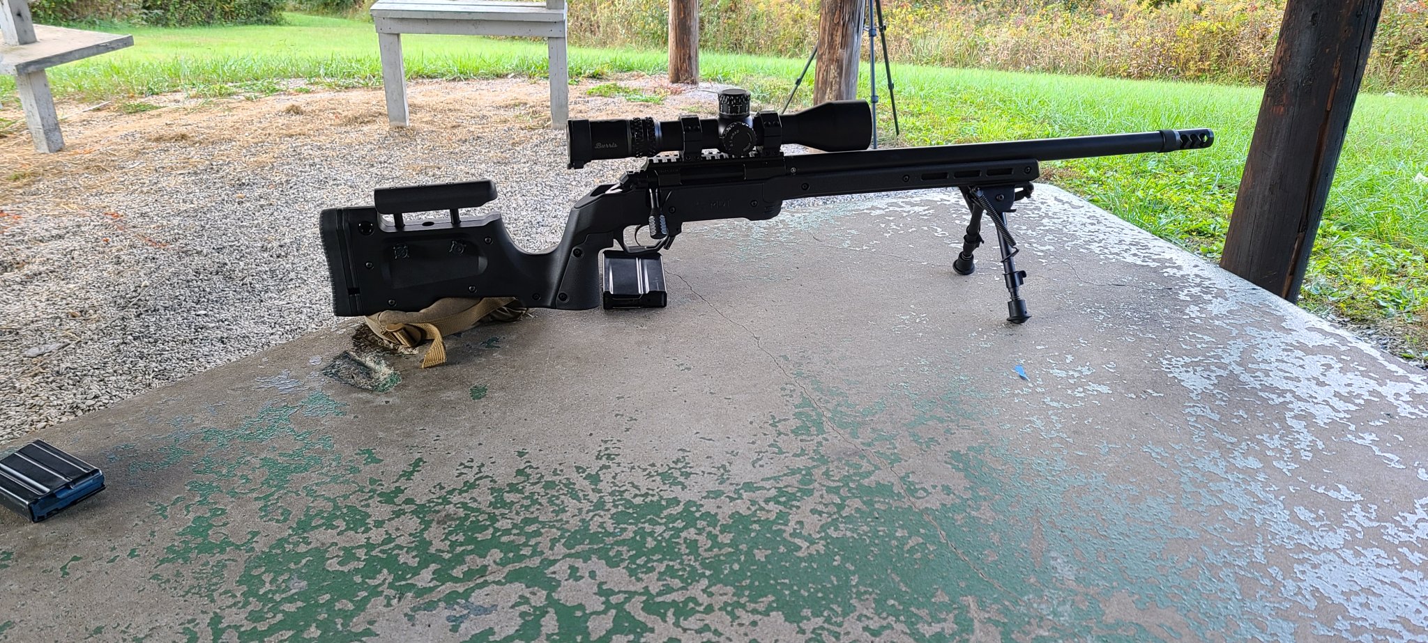

Here is an MDT XRS SA with a 20" Bergara B14R heavy barrel and action.
I should add since it's such a short chamber it will look more like a typical 18 or 19 inch would I believe.
Can you explain to the audience how a 20" rifle barrel, chambered in 22-250 could or would look like an 18" or 19" barrel?
IOW, how does the chambering affect the visual length of a barrel?

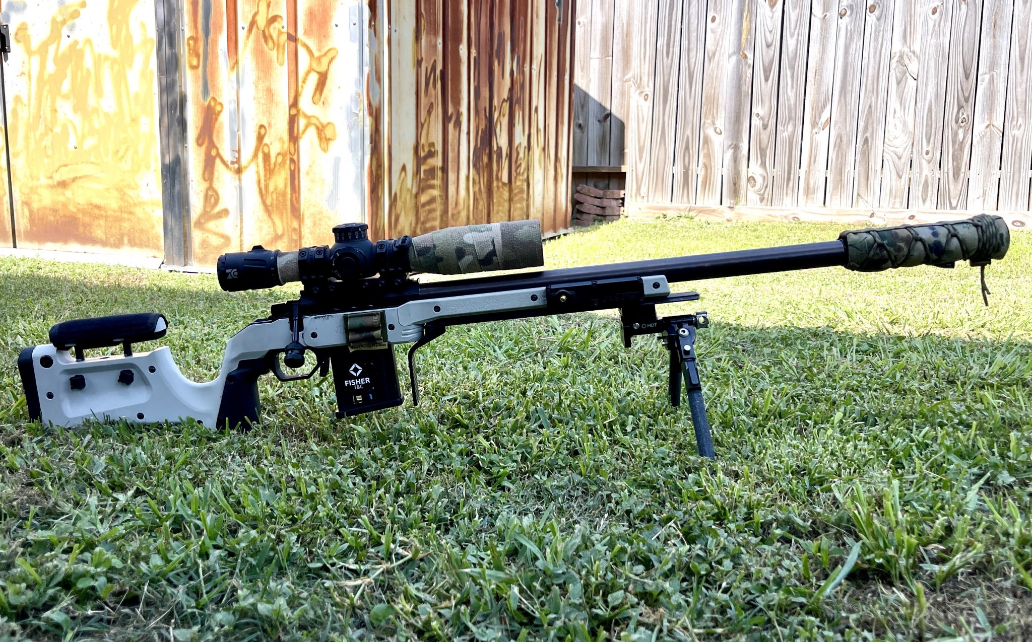

Here's a Kauger action in an XRS.
22" Proof, Cherry Bomb on the end.
The XRS looks best with barrels of 22" or less.
The forend is pretty short, so be aware your movements with an attached bipod will be magnified.

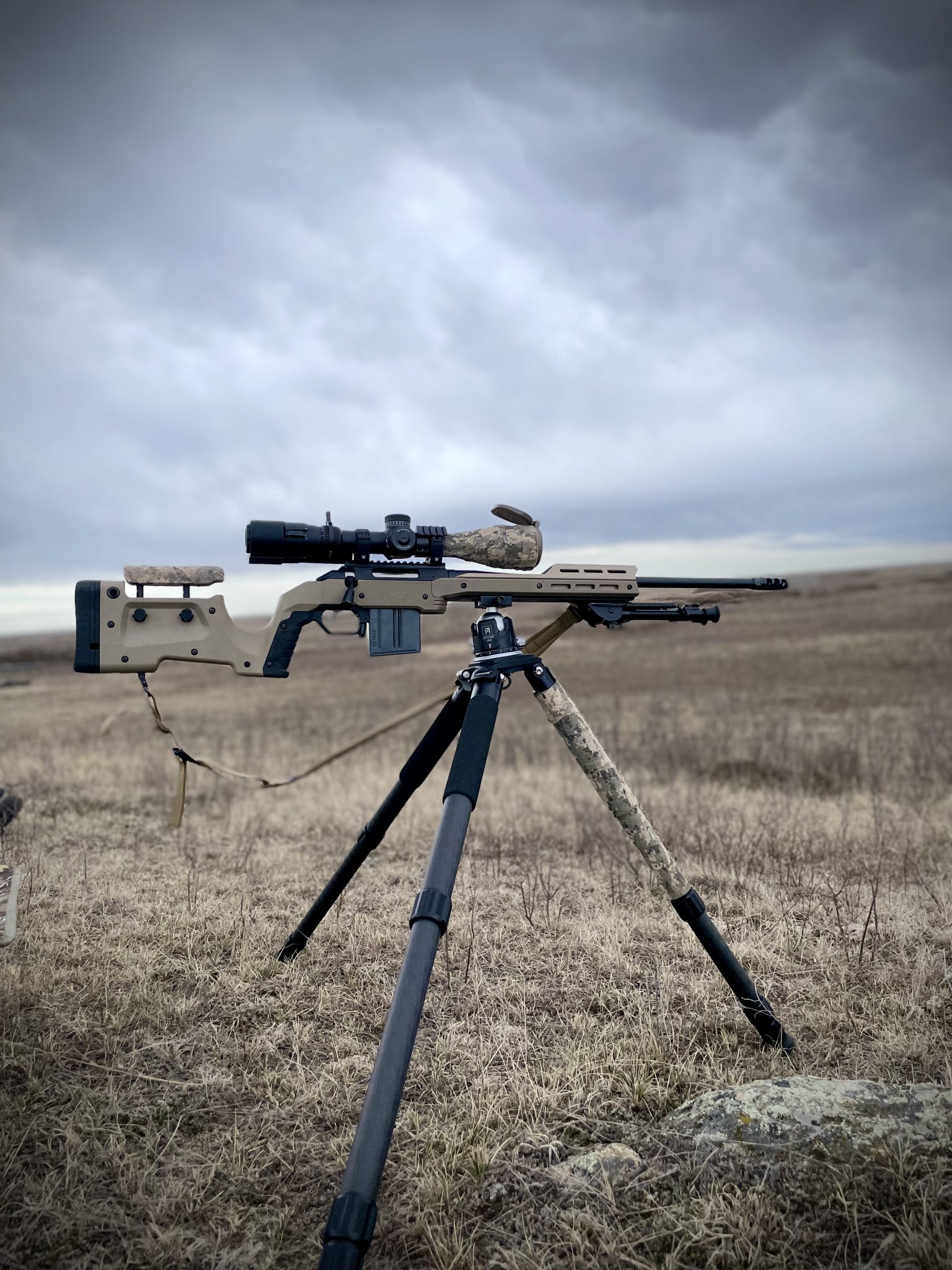

Looks good! And ya for sure. I just have the factory Ruger predator barrelled action in an XRS, just wanting to buy a prefit for it

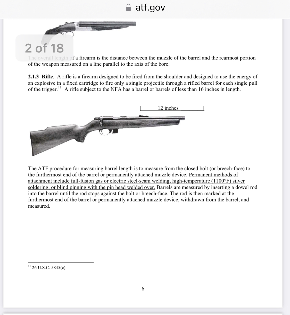

Refer to number 6.
6. Do I need to account for the chamber in the barrel length measurement?​
No, the chamber is not included in the barrel length measurement.

I may not have been clear enough. I mean that my 20" 22lr will appear shorter than a 22-250 because the 22LR has such a short chamber. My apology for not being clear.
The barrel length is measured from the bolt face to the crown.
It doesn't matter what a barrel is chambered in, the length of a 22" barrel is 22", not chamber plus 22"

Incorrect.
The method of measurement is exactly the same. Measure from the bolt face with the bolt closed to the tip of the barrel.
The easiest method is to run a cleaning rod into the barrel from the tip to the bolt face. A 22" barrel will measure 22".
A 22" 300 Remington Ultra Mag will still measure 22".
The reason the chamber is not measured is because it doesn't affect the length of the barrel in any way.
If I took a 26" 6.5 manbun and ran a 6.5-06 reamer into it, the barrel would remain at 26".
