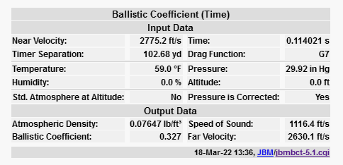

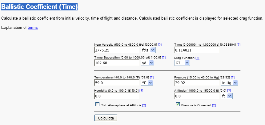

Using the JBM Ballistic Coefficient (Time) calculator and my Labradar trace file it seems to provide a BC very close to the factory number.
Bullet was a Berger 140 Hybrid.
Dont know how accurate the results are it depends on how accurate the Labradar numbers are.
Anyone try this?
What were your results
Anyone try this?

For .22 LR it is very accurate.
For typical supersonic rifle projectiles it will be a bit high for an average as we are measuring a short distance. But the result is well within the range of typical BC truing; "adjust the middle number a digit or two."
Another forum member @ptosis made this online calculator that can measure an average and remove invalid tracks from multiple trk files giving an even better result:
Whatsupdoc said: Dont know how accurate the results are it depends on how accurate the Labradar numbers are.
The LabRadar machines have shown to be capable of giving very good numbers. If I run two and get the same (or very close) numbers, I trust them. I've had issues with muzzle blast or recoil bumping them out of alignment. When that happens, I simply realign them so that they agree and march on. Having said that, any calculation of a BC based on a LabRadar track should be very accurate. The limiting factor would be range. If you track a bullet to 100 yards and calculate a BC based on that track, you should have a great number for shooting...100 yards. Yeah, it should work a little farther but a good rule on measuring BC is to measure at the farthest distance you plan to shoot.
