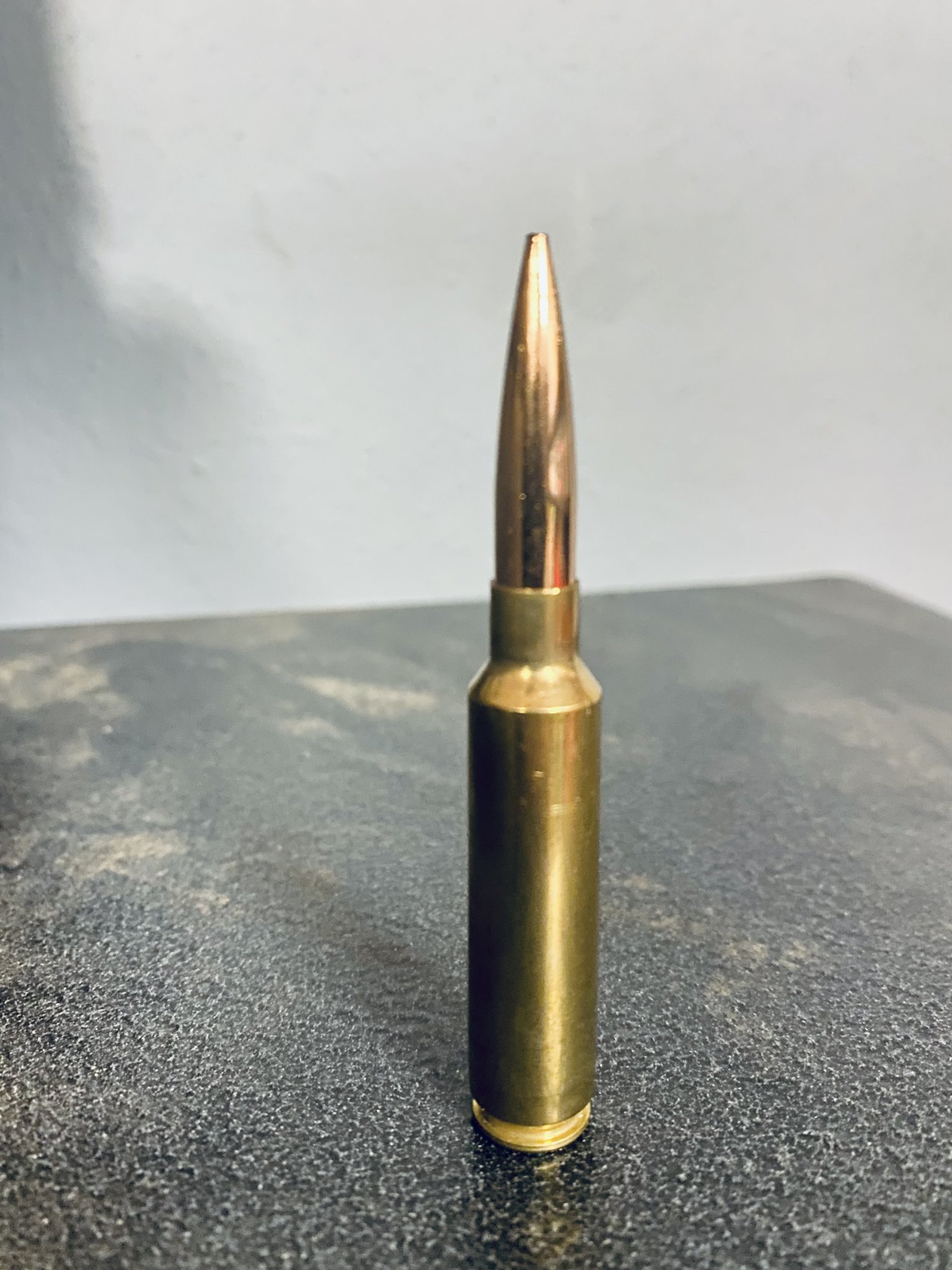

Gotta love the .284 with 180’s and a “proper” freebore🤙🤙 still a touch long for the mediums but i can definately see how the mediums could be pretty sweet for the saum’s and prc👍

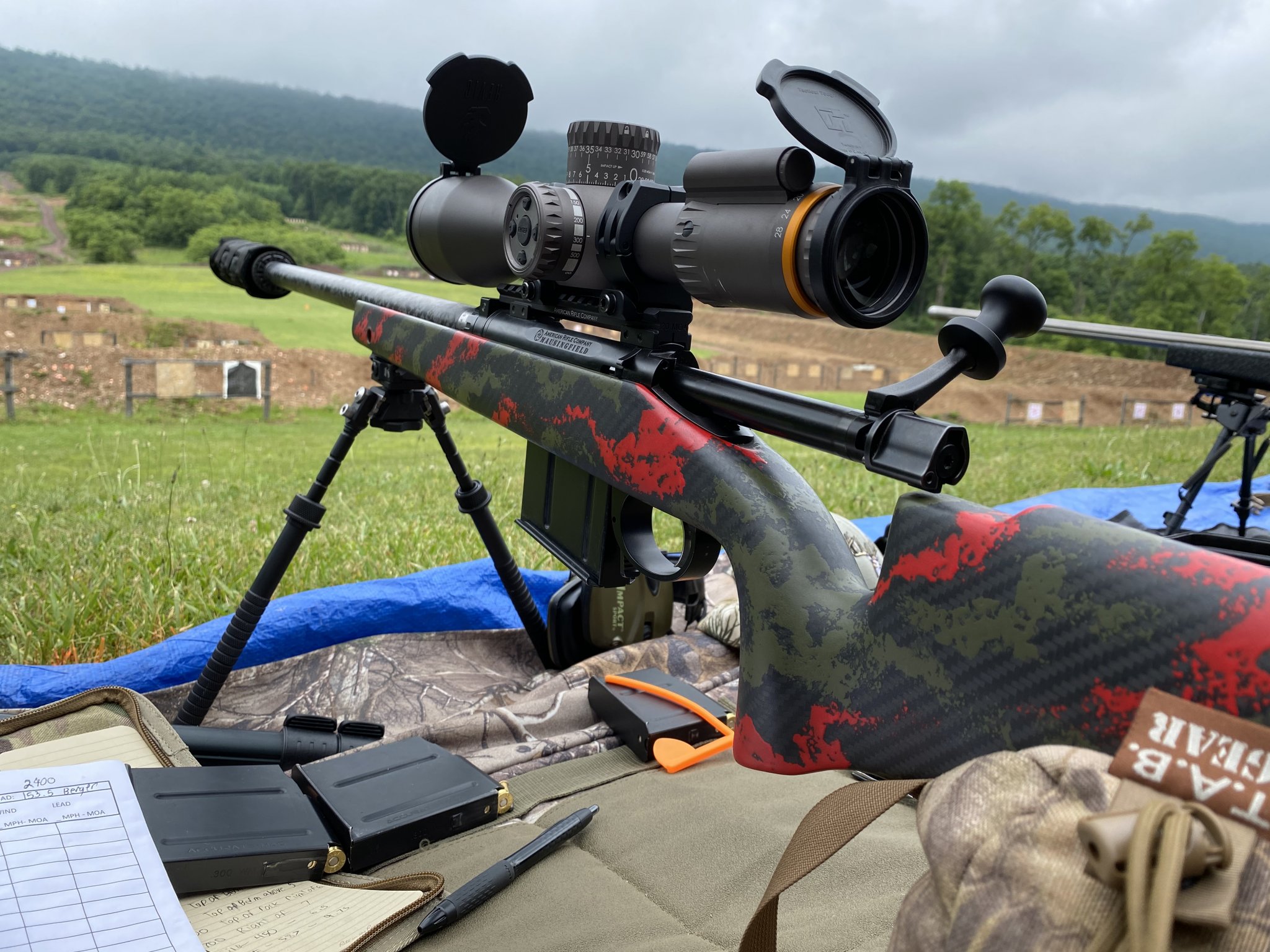

I recently built a 6.5 PRC with a Defiance Ruckus XM action, Bartlein LH gain twist barrel, and MDT ACC chassis. It is the perfect answer for the 6.5 PRC cartridge. Frankly, if I built another 6.5 Creedmoor, it would be with the XM action. The MDT XM magazines give you that extra room for longer bullets and shallow seating depths.

Which arc action do you like better and how much does that bad boy weigh?
If I remember correctly it sits around 7.75 pounds bare and around 13 as pictured with the Revic, bipod and Nomad L. With just the rifle and an NX8 2.5-20 it sits right at 9.75 pounds which is within an oz of my Pre-war Model 70 which was my main hunting rifle before I built that one.
As for which action I like best it’s hard to say but the Archimedes definitely has an advantage when it comes to dealing with stuck cases.
