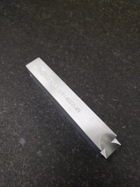

When I put the 6.5 PRC in a long action I ran into feeding issues as the cartridge would start to dip in the AICS mags and hit the front of the feed ramp. In order to get it to work properly I put LRI mag spacers in which have their own feed ramp built in.
I'm building a 300wsm now on a LA Defiance Anti because I don't want to wait for a medium inlet stock and Hawkins decided not to support Defiance XM Hunter dbm/mags. If parts were more available I'd go XM to save 1.4oz but as you mention, while parts are hard to get all around, SA and LA parts or much more available than Defiance XM or LonePeak/Zermatt Mediums. Doesn't help anyone that those three couldn't get on the same page for a medium action inlet either.
I recently built a 6.5 PRC with a Defiance Ruckus XM action, Bartlein LH gain twist barrel, and MDT ACC chassis. It is the perfect answer for the 6.5 PRC cartridge. Frankly, if I built another 6.5 Creedmoor, it would be with the XM action. The MDT XM magazines give you that extra room for longer bullets and shallow seating depths.
Reactions: beetroot
Just so I’m clear,
You were using a 300wm Aics mag, and it was nose diving
You then used a PVA short action mag kit to help feeding
Thanks

Mostly correct and above is what I used.
My plan was a dual purpose hunting rifle, 6.5 PRC for deer hunting then the ability to switch barrels and run the .300 Win Mag for larger game. In the end I ended up splitting the parts into two rifles and putting the 6.5 PRC barrel on a SA Archimedes while the .300 stayed on the Mausingfield.
One caveat is that I could get the 153.5 Berger to feed but that was at a COAL of 3.05”, if it got shorter they would start to hang up and my 123gr Hammers at 2.937” wouldn’t feed at all out of a 5 round mag. The 3 round mag had enough spring pressure that they would only hang up every once in a while.
what a moron i am ...LRI not PVA
wondering why i didnt see it on their site lol
