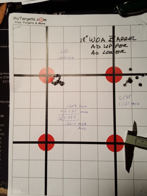

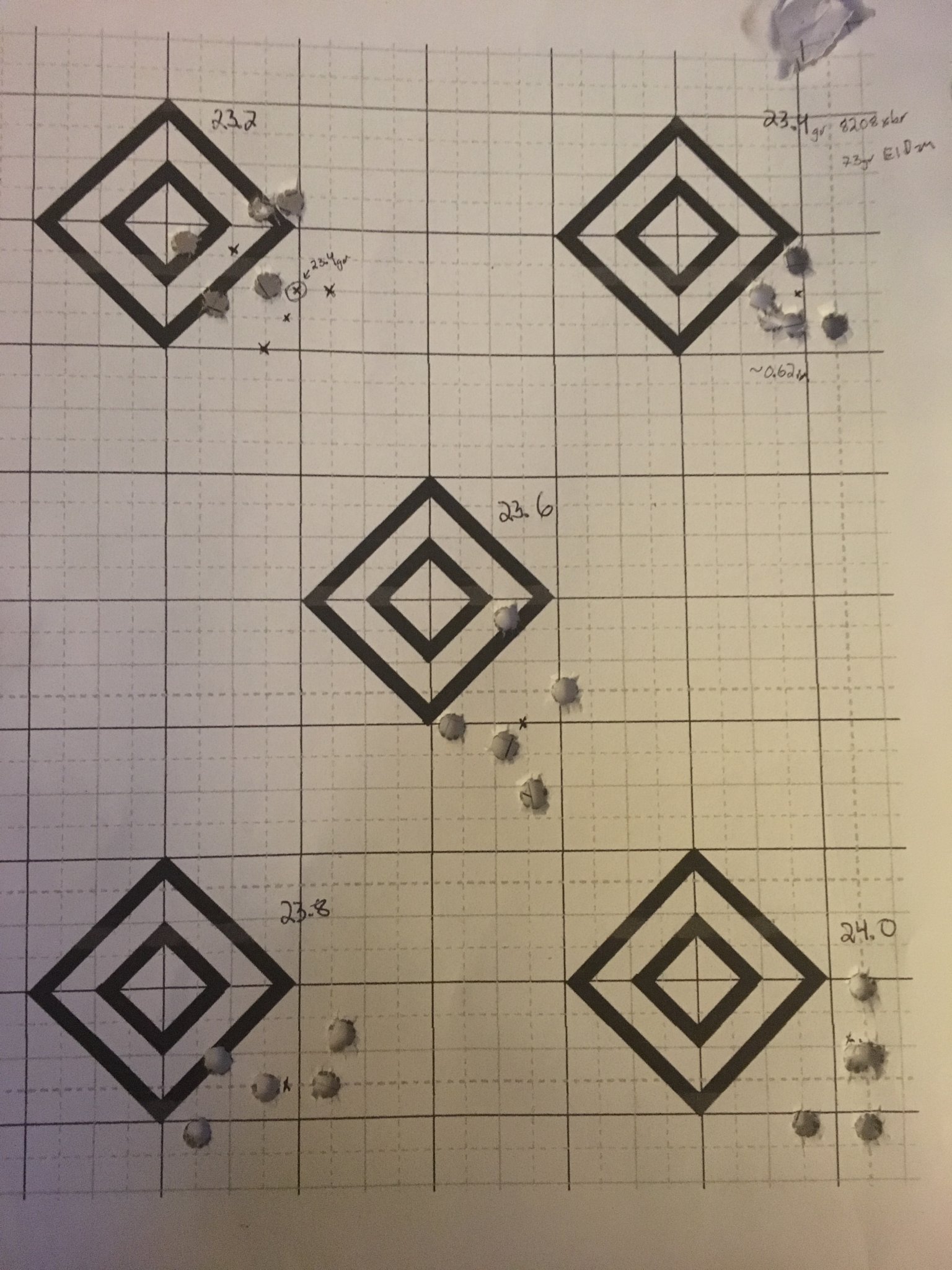

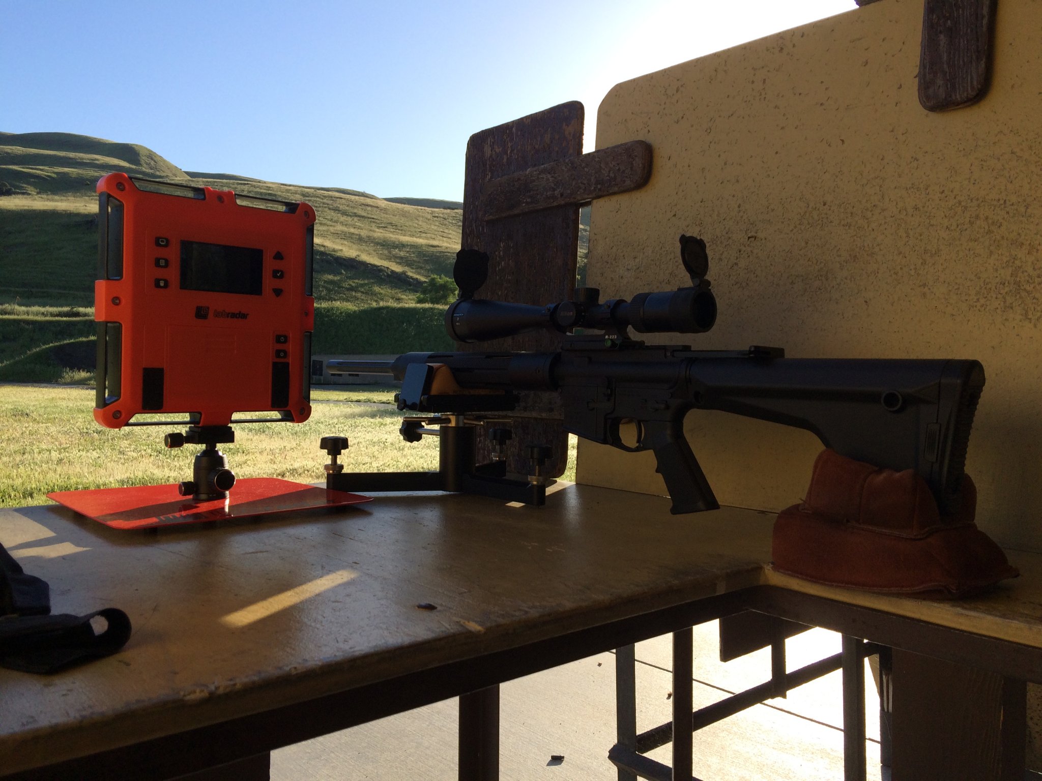

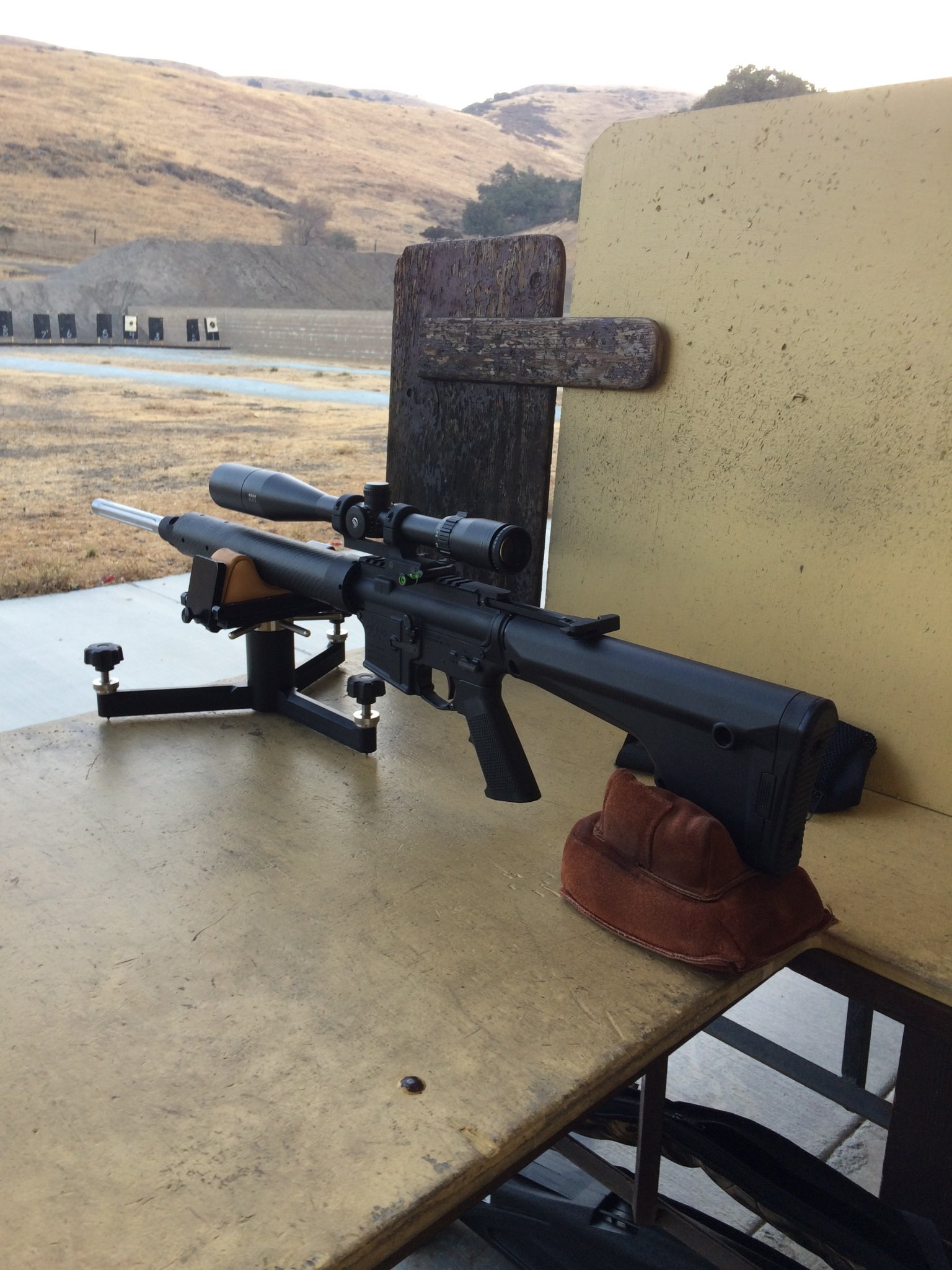

This is initial load workup from this weekend. 16” BCM SS410 midlength with SAMR chamber, 73gr ELD-M and 8208xbr. Will probably chop the barrel to 14.5 since it’s usually suppressed. Seating depth test at 23.4gr is next... Handloading as opposed to factory ammo always helps.
No personal experience with Larue, but Rainer sells a Rock Creek AR barrel that should shoot well, as an alternative to krieger. In the grand scheme of things, a $350 barrel is nothing compared to gas going to the range/hunting. False economy in my opinion.

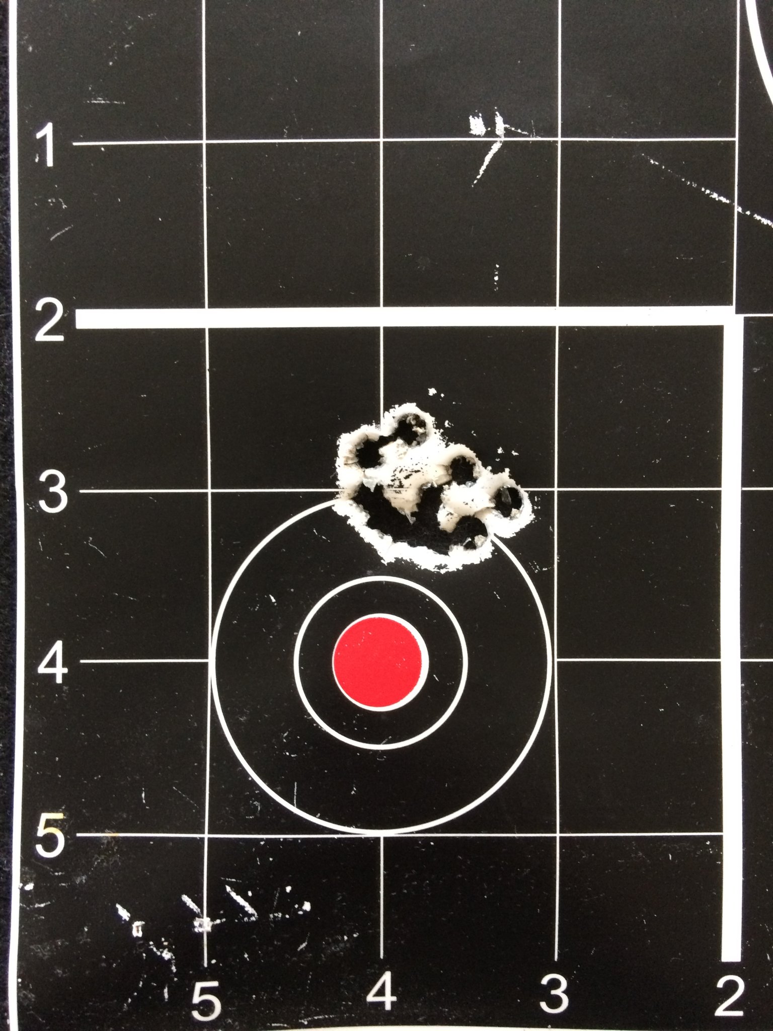

I shot two 5 shot groups at 400 meters last night to confirm zero. Could not see holes though scope. Walked out, looked and pulled target. Both were under 2". Very calm conditions near dusk. The best group was about 1.25". I did not measure them I was more concerned with getting a no wind zero. But all my parts are top end. Except the Douglas barrel which is slightly on the mid level price range. KAC, Geissele, S&B Ultra Short etc.

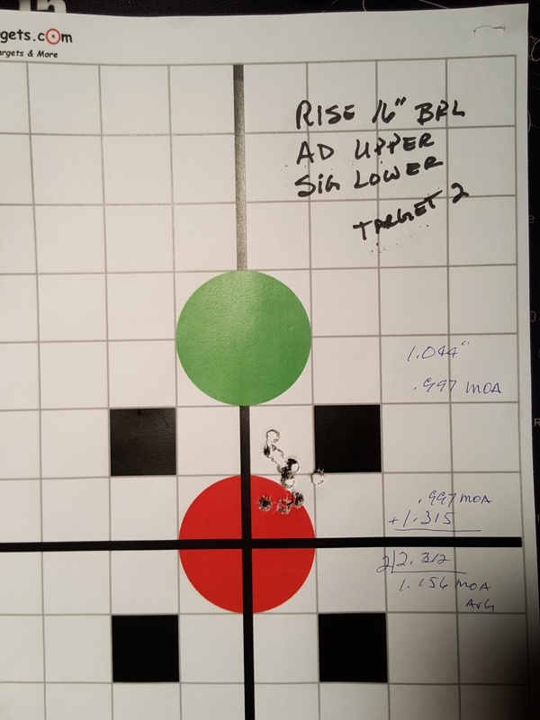

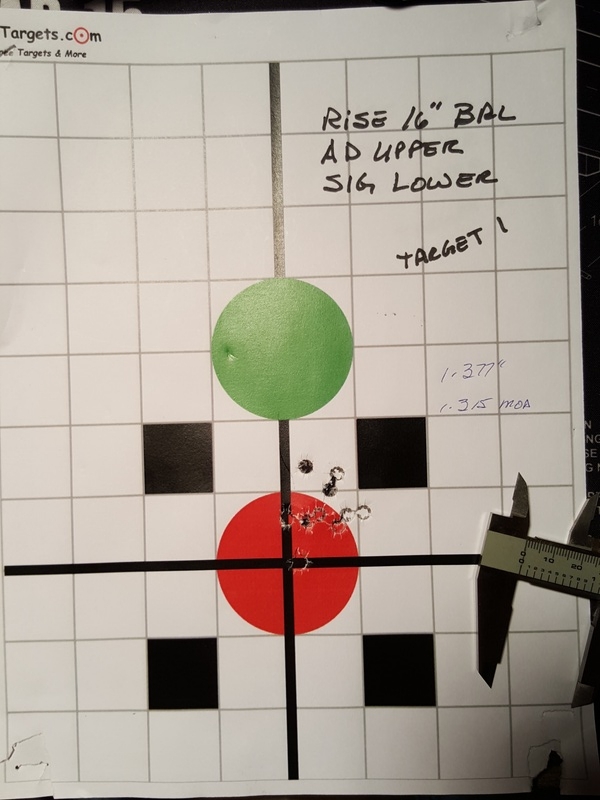

I typically shoot 5 round groups but I’ll start going for 10 now that you are making me feel like a chump haha. I am fairly new to precision shooting so there is definitely a degree of ignorance there but I do feel like averaging 1” at 100 yards with 5 round groups is an obtainable goal, even with a semi. But maybe it isn’t. It is somewhat frustrating when I can get a box of 140gr Hornady Match and hammer out 4 sub-MOA groups in a row through a Bergara HMR without really thinking too much about it and then pull out an AR that costs twice as much and struggle to get results that are even remotely similar. It was shooting about 2moa with surplus ammo (PPU and Wolf Gold) but actually put out several 1.5” and one 0.8” (@100y with PPU). Then I ran some mk262 and Hornady through it and was getting 3-6” groups. I know a lot has to do with finding the right ammo for your barrel, but still, it can be frustrating.

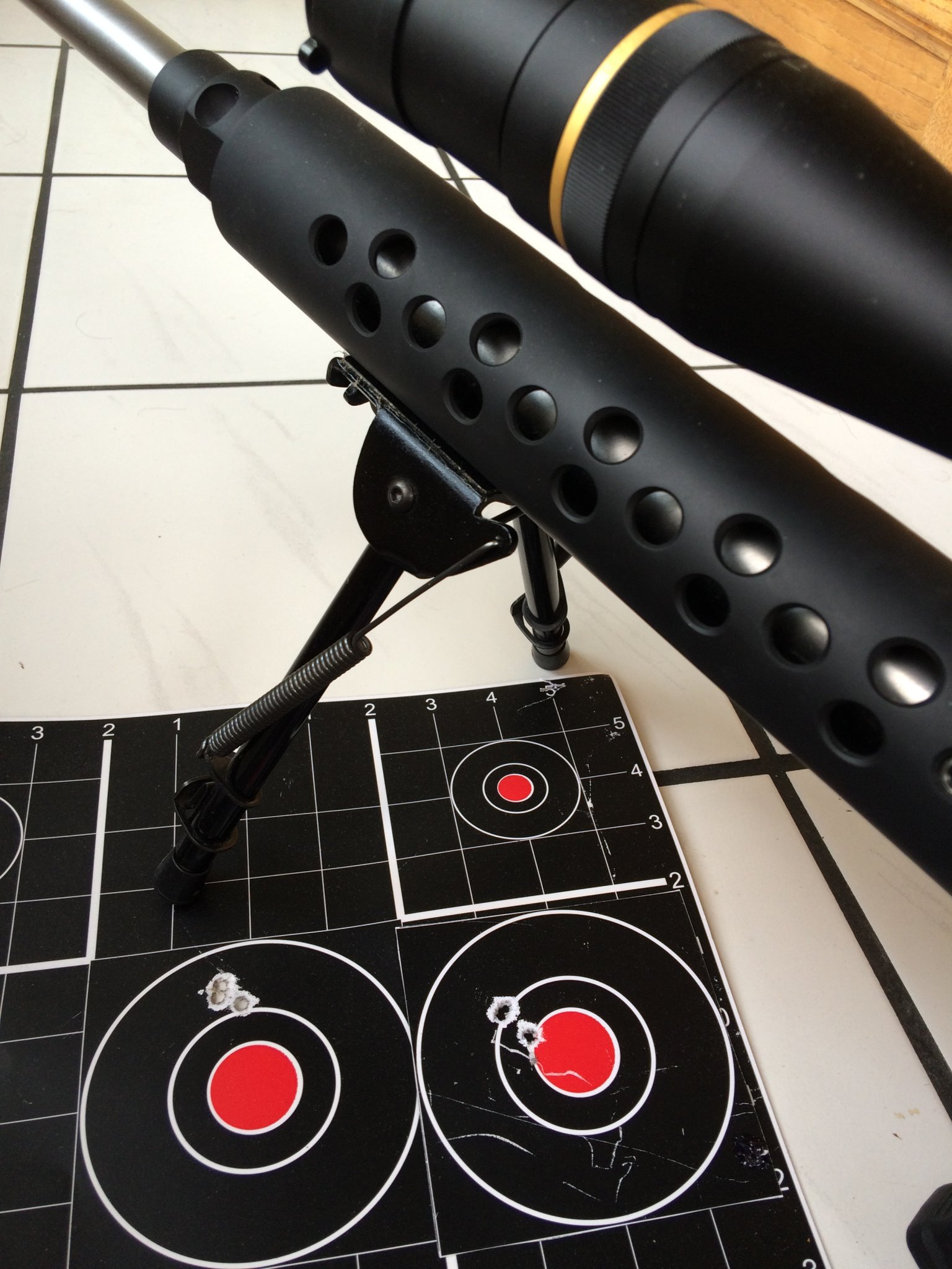

This is an inexpensive off-the-shelf WOA varmint upper. 18" 1:12" twist, Wilson SS button rifled bull barrel. 10-shot group was made in under 60 seconds at 100 yds and measured ~0.83" center-to-center. In the other picture, left group is 100 yds, right group is 200 yds. 52 gr Berger match bullet, 23.7 gr LT-32, Nosler brass, CCI BR-4 primers loaded to 2.260" COAL. This just isn't that hard. Buy decent stuff from vendors that are well known for accuracy and ignore the tacticool peer pressure - that is, if you care about accuracy and precision.

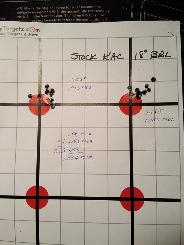

I have a 14.5" KAC that I love. It shoots around .75 moa at 100 with 3 different loads. Some groups are a little smaller, and some are a little bigger, but .75 is about where it is at. When I mentioned this to a friend at KAC, he said they could not guarantee that level of precision, but that most of their 5.56 carbines are around an inch to an inch and a quarter. Seems pretty reasonable to me for a lightweight short 5.56. Beats my heavier longer Noveske everyday, though I would love to try a WOA sometime.

750 yds isn't mid-range but yes, 52 gr bullets aren't good for 750 yds. 22" 1:8" twist, bull barrel, fluted WOA varmint upper with carbon fiber float tube. This one is not inexpensive, but it will shoot 0.6 MOA 5-shot groups at 200 yds with 77gr Sierra TMK, 25.3 gr 2520, CCI BR-4, and LC brass. Supersonic to 1k yds. Dtech 20P - also sub MOA and supersonic to 750 yds.
Yeah, I've got 3 KAC's & what they are saying is about par, on average............but they are very, very consistent & generally don't throw fliers unless I jerk one or 2, or 3 as I just don't shoot all that much anymore & it shows on the targets at long range.
