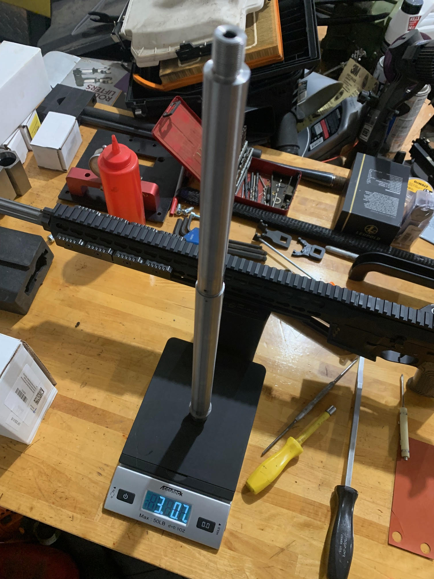

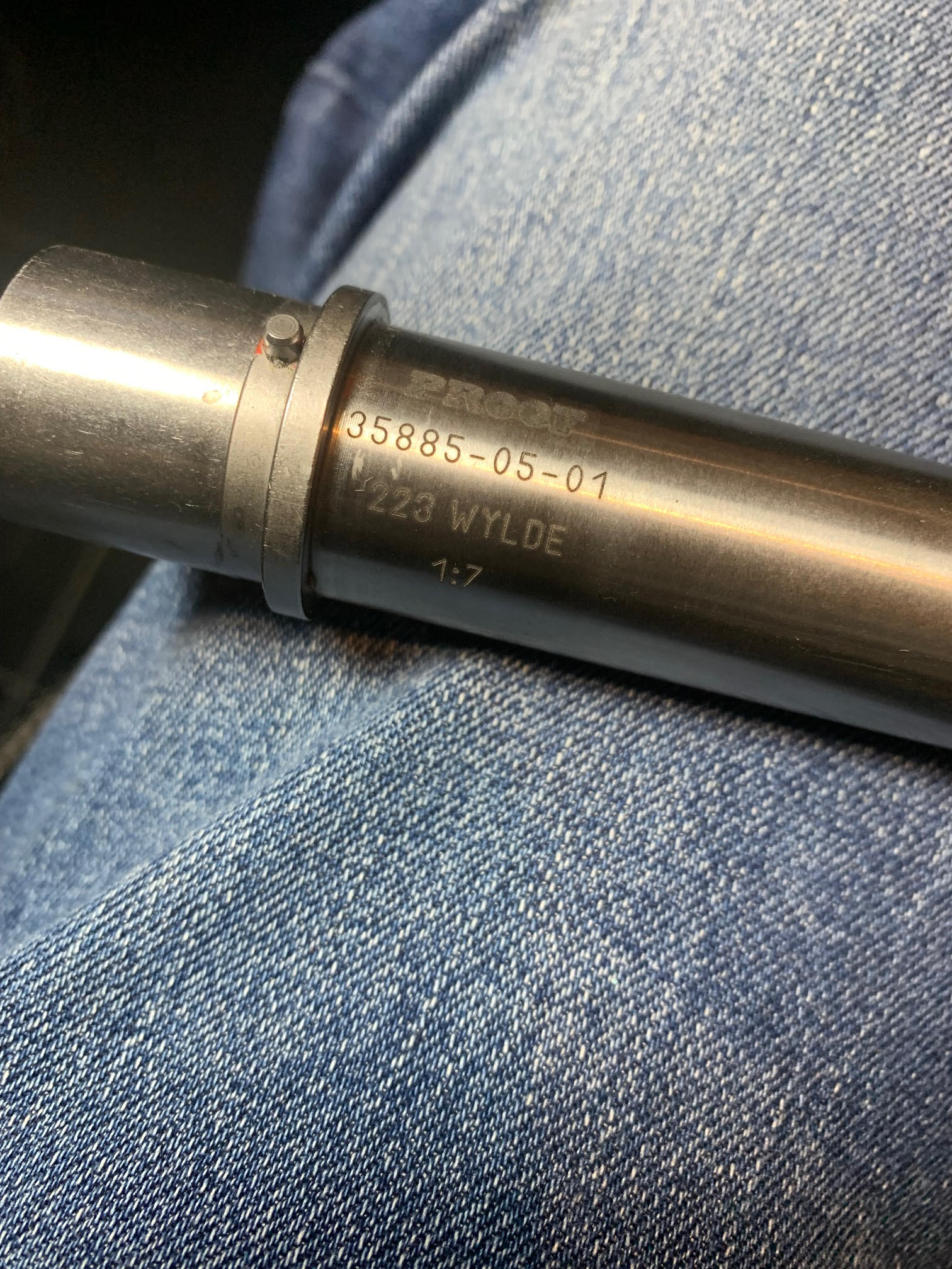

    Proof cut rifled.
    20" .750 GB 1/7
    Part number shown. It's right at 3lbs though.
    Reactions: simonp and Bakwa

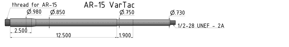

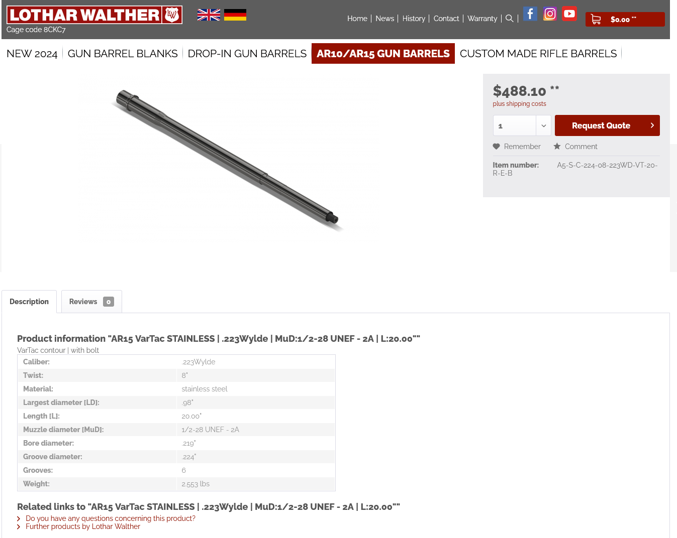

    Proof is the easy button IMO, but here's another often overlooked option. Don't hear much about these.
    The profile comes in a little under your weight requirement @ 2.553lbs.
    Std. stock is 8T, but can be ordered in 7
    Lothar-Walthers are very good in my experience, both the .223s and 308s.
    I've forgotten about Lothar-Walther. They're an OG.
    That might be exactly what I'm looking for.
