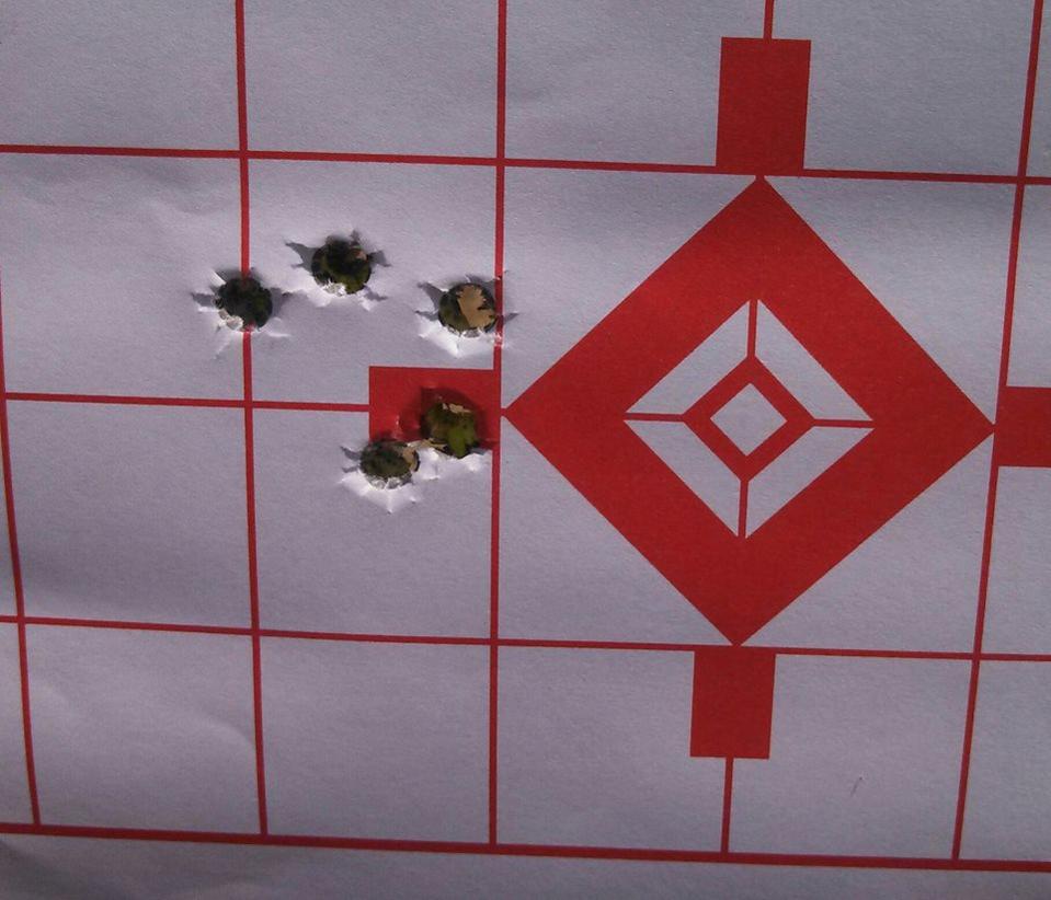

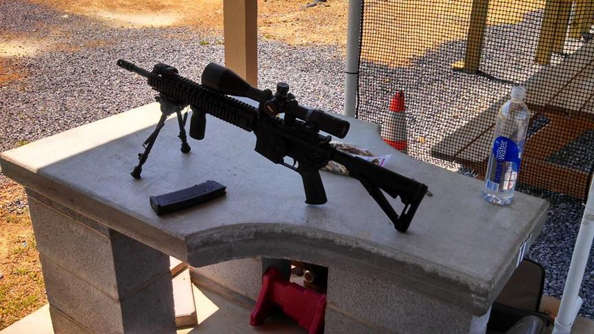

So I finally got to take my AR to the range and put it through her paces. I "finished" building it a few months ago and by finished I mean I had a functioning rifle. Since December I have taken it to the range several times to see what I want and to get comfortable with the rifle. I finally think I have a configuration that I am happy with.
The hardware:
Forged Mega Upper and Lower receiver
Geissele SSA-E trigger
Daniel Defense 16" 1:7 barrel mid-length gas system
Yankee Hill low profile gas block
Young's National Match BCG
Daniel Defense muzzle break
Midwest Industries T-series quadrail
Magpul CTR stock with a Spikes carbine buffer tube and JP buffer system
Millett Gold 4-16X56

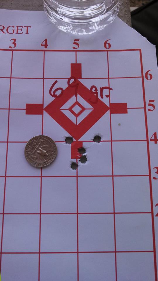

I started the day by zeroing my scope using 55-grain ammo. It took about 20 rounds to zero the scope. Then moved to 69 grain ammo and shot these groups. After shooting paper I moved over to shoot steel plates at 200 yards and 300 yards. Surprisingly the ammo shoots very flat and needed minimal elevation correction between 100 yards and 300 yards.

I shot 55-grain 5-shot groups, but couldn't tighten the group more than about 3 inches. Is this the nature of the ammo or is it a combination of ammo, barrel, and shooter?

It sounds like you should consider an adjustable gas block and/or a heavier buffer. As for the noise it could just have to do with the specific brake you're using and how it's redirecting. Also if you're used to shooting a longer barrel which sticks out beyond the stall farther than a shorter barrel it could have an affect on the felt noise.

What 55gr ammo were you shooting?
As another poster touched on--which buffer are you using?
The 6-8' ejection--did your ammo simply rest in a pile on the ground that far away, or was it sailing 6'-8' of air before hitting a wall or?

I was shooting run of the mill 55-grain PMC ammo. I run a JP tuned extra power carbine buffer spring and carbine buffer. As for the brass it was piling up about 6-8 feet away.

OP: take 1.5-2 turns off your ejector spring in the bolt. My brass lands about 4 feet away now that I've cut the spring.
Also, 55gr bullets shoot like shit in my 1:7 twist, but 77gr SMKs shoot tight half inch groups.

The only thing you know for sure about your groups is that the bullet holes indicate where the barrel was pointed; so, unless your rifle is broken, or the ammunition is defective, your errors were likely made by an inconsistent shot to shot relationship between the gun and ground, which produced unpredictable recoil resistance, creating an inconsistent angle/arc between line of bore at rest and line of bore at bullet exit. Building the position with proper application of support, muscular relaxation, and adjustment of NPA will help you sense inconsistency and thus shoot smaller groups when consistency is realized. My personal experience is that grouping under a half inch using irons and sling/bone support is possible with match grade gun/ammo.

My 1/7 ARs have shot AE223 55 .33" at 100, 5 shots from the bench. Same ammo shoots 3" at 200 with minimal wind. Switching to 62-69 @ 200 tightens it back up again. Opening up at 200 is pretty consistent with all 55 I've shot through those two 14.5". LaRues at 200 + 20mph wind under time pressure is amusing with 55s. 5.56 55 doesn't group as well as AE223 in my 14.5s.
