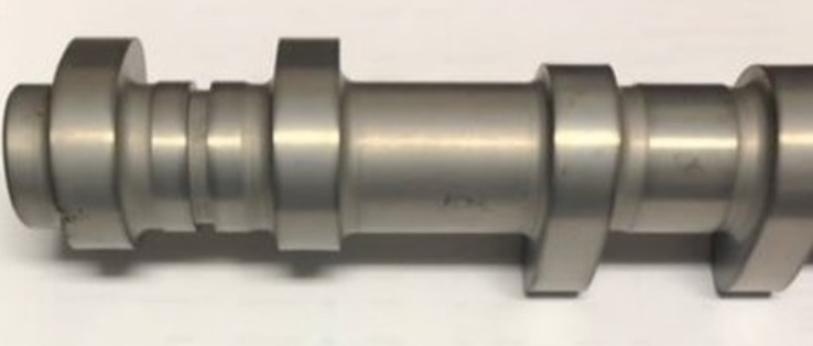

    Hi,
    Well technically nitriding will turn your barrel grey colored, not black.
    This is nitriding color:
    The "Black" everyone refers to as the "nitride" color is a post nitriding process and that color will change from batch to batch.

    Hi,

    And to further explain, the blacking comes from the formation of iron nitride on the surface through a quenching and polishing post process that follows salt bath nitriding.
    You can't get that black from plasma or gas nitriding because those processes end with a slow cooling in the retort back to room temp
